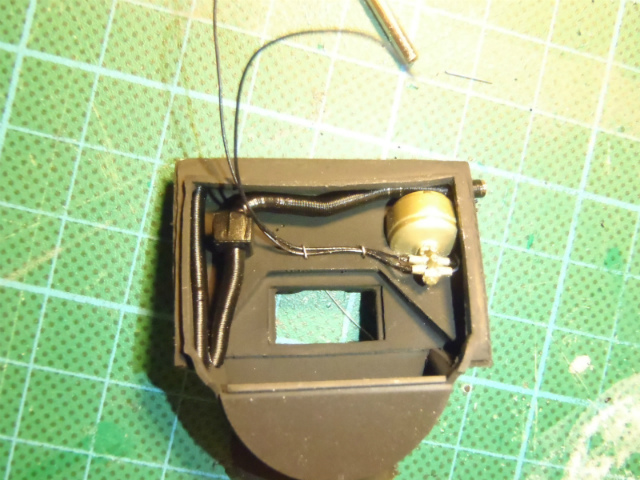

Inside the bonnet.
I cut Fujimi's part...
Ok, I can see the battery.
The ducts are made from springs (they have wires in them), and equipments are made from plastic boards and rods.

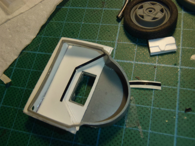

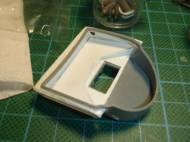

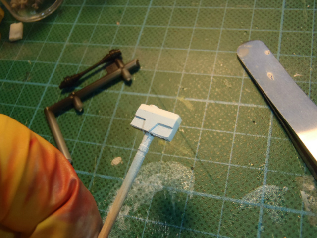

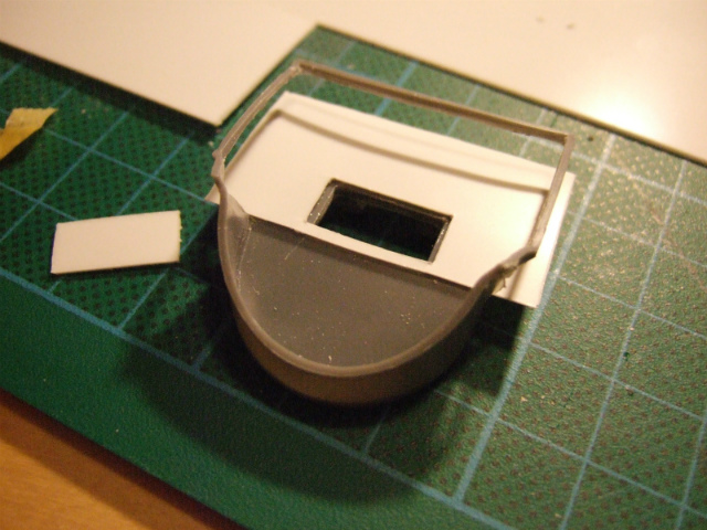

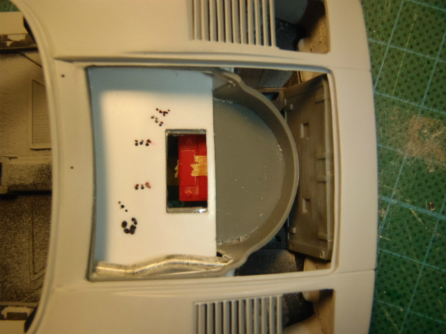

Later on this picture, I replaced the radiator coolant tank to a bigger one.
To replicate the radiator coolant inside the tank, I splayed light blue + white, then white + beige + thinner.
As the spare tire part is too dull (you can see it left-up side in this picture), I cut the tire itself (from spare box of Fujimi GTO).
... On these parts, I reckon I could do a bit better and made some mistakes, but I couldn't wait to proceed to engine section... (The belt for the spare tire will be fitted later once I found a good material.)
