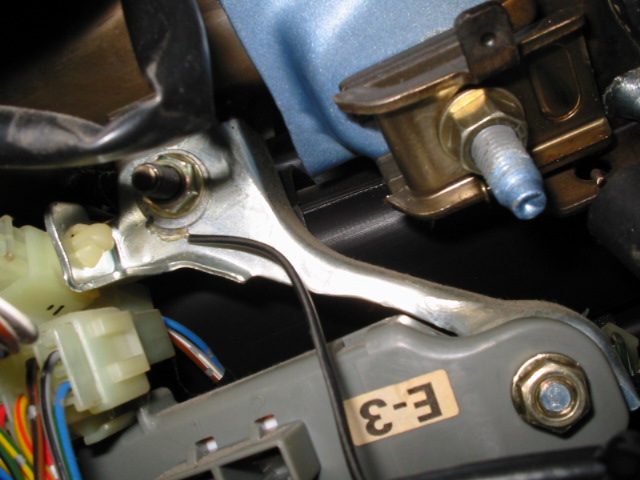

well... first a HUGE thanx goes 2 tony for helping me with my wiring problems all day :)
i got my 6" neons all hooked up today in my car, started around 12 i think and finished it around 2:30

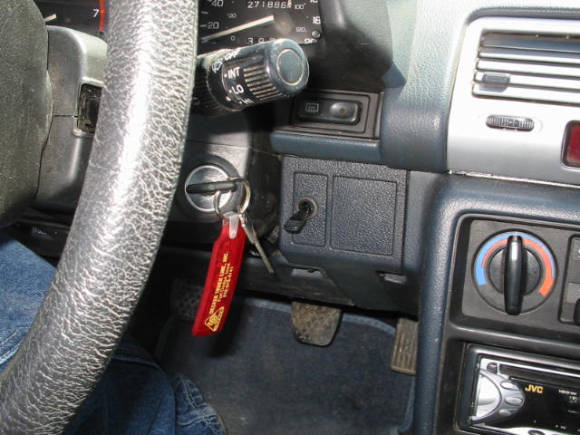

the toggle switch in the dash :D
http://files.automotiveforums.com/uploads/739385toggle_switch.jpg

connect postive from the fuse box to the toggle, then another postive from the other tab on the toggle 2 the neons wire. then just connect the ground from the neons somewhere and ur done lol
oh yea!
make sure u have the right fuse in there
i hooked mine upto the sunroof fuse (even tho i dont have a sunroof) lol
it uses a 30 amp fuse and i dont think it'll blow for a long time... unless u short the wires like i did the first try ;) lol

first, here is my ground.. i soldered the wire to a washer, then put the washer under this nut..
http://files.automotiveforums.com/uploads/793952ground.JPG

my switch, the same as 1phat's.
my neons.. i mounted them in the middle, on that lower vent.. i figured they would be out of the way here. it gives a good amount of light from here too. http://files.automotiveforums.com/uploads/917122neons.JPG
