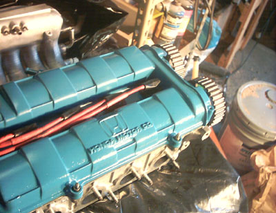

How did I ever get that black crap off the valve cover? Airplain stripper? Nope... Scrub Scrub Scrub, sand, sand ;)
http://files.automotiveforums.com/uploads/733189IMAGE0007.JPG.JPG
This will be the color of the valve cover and exetera... Its a duplicolor ceramic/hi temp engine paint. I liked the color and it will match my engine bay :)
http://files.automotiveforums.com/uploads/834560IMAGE0008.JPG.JPG
This is were the adjustable cam gears will be... I cut out part of the "Shroud" so I can get at them and still have a timing belt cover.
http://files.automotiveforums.com/uploads/482240IMAGE0010.JPG.JPG
This is my DC header that I spent 12+ hours port matching... the ports are a little larger than the ports on my head to creat a "Scavenging" effect, as you can see I also gound out the material into each exaust tube quite a way... I didnt want exiting exaust to just "Roll" over a smooth edge, I wanted it to flow and scavenge as well.
http://files.automotiveforums.com/uploads/702737IMAGE0011.JPG.JPG
So, thats all you get for now... I'll get some more pics when the valve cover is done or the block gets back from the shop... Hope you enjoyed

Well I just put the first coat on the valve cover and let me just say its looking SWEEET! I will now be offering valve cover services, sand blast and "Hot tank" (Hot tank is basicaly boiling the cover in my giant presure cooker to remove ALL sand particles, this works verry well) This service will completly clean all the stock paint off of the cover and you will get it back looking like the pic on the first page $75.00 pluss shiping. For $100.00 + pluss shiping I will clean tank and paint it as well, you must provide additional funds for specified paint/powder coating. If you are interested please email me @ [email protected] Title of email should be VALVE COVER. Ty ;)

Here we go, this is it after some more sanding and so forth.
http://files.automotiveforums.com/uploads/892926IMAGE0001.JPG.JPG
http://files.automotiveforums.com/uploads/303404IMAGE0002.JPG.JPG
Ummm. K, were is the date thats soposed to be here?
http://files.automotiveforums.com/uploads/642430IMAGE0003.JPG.JPG
Here is the WHOLE timing belt cover.
http://files.automotiveforums.com/uploads/170492IMAGE0005.JPG.JPG
Here is a pic of the vlave cover with the timing belt cover, and yes... I did hand polish the entire head, intake manifold, and top half of the header ;)
http://files.automotiveforums.com/uploads/637166IMAGE0006.JPG.JPG
http://files.automotiveforums.com/uploads/383750IMAGE0007.JPG.JPG
http://files.automotiveforums.com/uploads/204077IMAGE0008.JPG.JPG
I ordered the adjustable cam gears from japan today, so they should be here in a week or two... Right about the time my block is finished I hope :)

I like the 5th pic down, it realy shows my hard work when i can see the reflection of the paint on the Intake Maniflod I spent hours hand polishing :)

Um, "cam cover" and valve cover were painted with the same Duplicolor General Motors Blue, the Valve cover did not get any primer as it will be getting HOT, the paint can take 500 degrees and is ceramic based, so i think it would be retarded to put any kinda primer under it that would cause it to flake off. The "Cam cover" or belt cover asd I call it got 4 coats of automotive primer before the spray.
