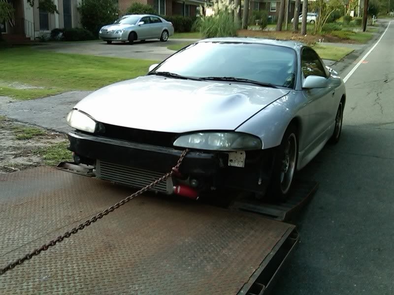

So I got the car towed back last night, when I got it off the trailer I tried to turn the motor over and it actually turned over. It was locked up just before we left so I guess the chains pulling it down with it in gear put enough pressure on it to break it free. Going to try and start it today, I dont think the motor has any damage done to it now. There really wasn't but a few drops of water in the cylinders so it shouldn't be enough to hydrolock it.
So Im going to put it back together just enough to fire it up and see if it runs ok, then going to go ahead and pull the motor and check it out anyways since I got to put the new clutch in it anyways. Hopefully everything turns out good.

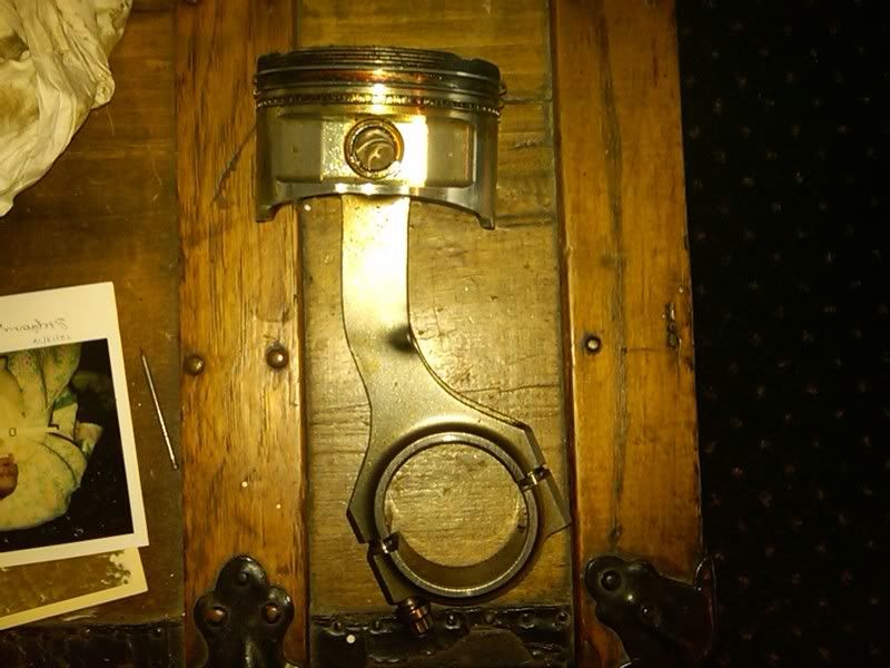

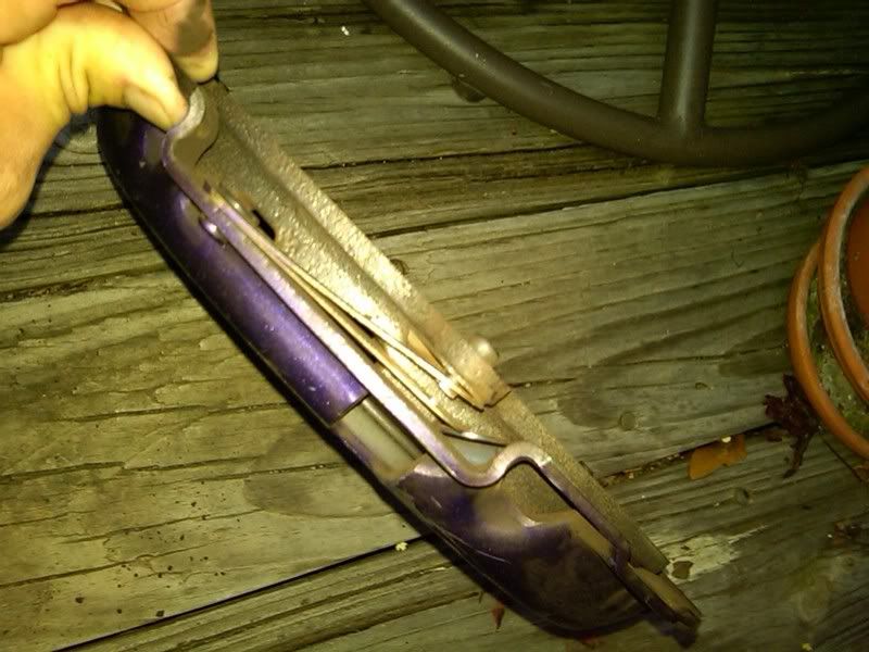

I got the motor all torn down last night, the only damage I found was 1 bent rod. I have already called eagle this morning and Im having a new rod overnighted here. So the motor should get put back together tmrw evening and should be put in the car hopefully tmrw night. My clutch disc is being assembled today so I should have that tmrw also. Planning on pickin up a new oil pump also. I have never liked that topline pump I put in there. Always had lower oil pressure than the stock pump did.
Hopefully all the parts come in on time and I can have the beast back running on wednesday. School starts on Thursday so I really hope everything works out. Im uploading pics now so they will be up in a few minutes.

SilvrEclipse
08-17-2009, 09:59 AM
http://i189.photobucket.com/albums/z173/SilvrEclipse/IMG00006-20090814-1912.jpg?t=1250520554
http://i189.photobucket.com/albums/z173/SilvrEclipse/IMG00010-20090816-1642.jpg?t=1250520828
http://i189.photobucket.com/albums/z173/SilvrEclipse/IMG00009-20090816-1641.jpg?t=1250520871
http://i189.photobucket.com/albums/z173/SilvrEclipse/IMG00011-20090816-1958.jpg?t=1250520935
http://i189.photobucket.com/albums/z173/SilvrEclipse/IMG00012-20090816-1958.jpg?t=1250520989
http://i189.photobucket.com/albums/z173/SilvrEclipse/IMG00013-20090816-1959.jpg?t=1250521041
http://i189.photobucket.com/albums/z173/SilvrEclipse/IMG00014-20090817-0936.jpg?t=1250521146
steviek
08-17-2009, 10:02 AM
lol dude you fucked that shit up good! all of it!
SilvrEclipse
08-17-2009, 04:04 PM
Yes sir. Thats how we roll I guess
steviek
08-17-2009, 04:37 PM
not as bad ass my clutch but bad
cantgo2fast
08-17-2009, 06:34 PM
Ya dude that shit looks beat lol
tfoti
08-17-2009, 06:52 PM
Jesus H. Christ in a coffee can. Nice rod.

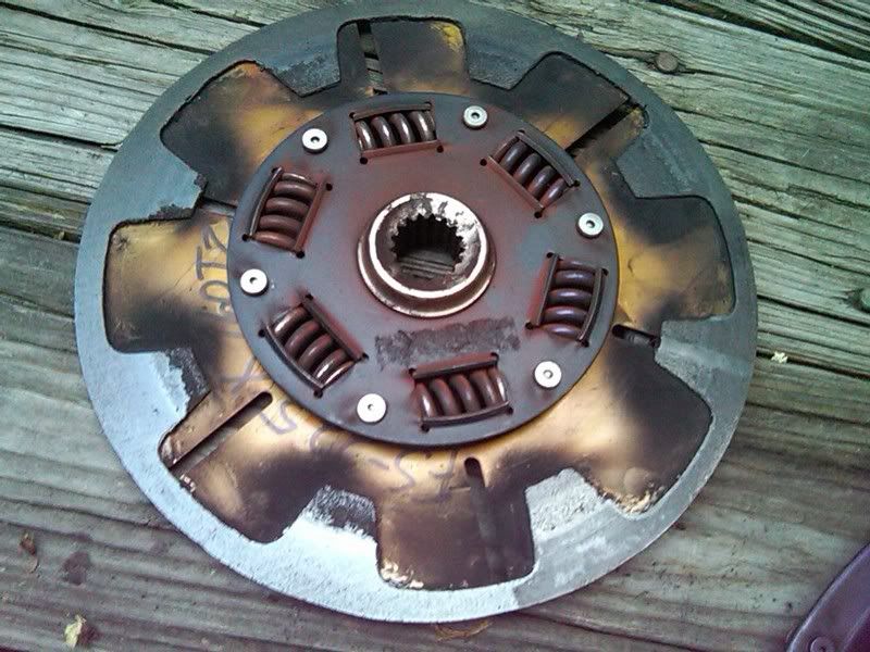

Just got word back tonight that the kevlar on the clutch disc was almost worn out. Which is really bad wear rate. Kevlar is suppose to last 5x longer than stock. Also ordered the rest of the parts I needed for it. They will be here in the morning so just waiting on the rod to get here is all. Also decided to go ahead and replace the master and slave cylinder while I am workin on it.

Yea you should be taking notes. The clutch was messed up from slippin it so much at the track that one day. Still not sure on the cause of the broken rivet but it must have just been a fluke thing. Pickin up the new clutch in about an hour.

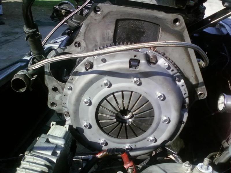

Ok guys I have been super busy the last few days and haven't been able to update this. The piston ended up being on that that cylinder and I got the motor back together. I finally got the clutch about 4pm on wednesday. Got the motor in that night and everything hooked up. I did something very dumb and forgot to hook up the lines going to the oil cooler. I cranked the car up and had no oil pressure. After about 10sec I shut it down. Tried it again for about 3 sec and still nothing. Then I realized what I had done and got it all fixed. Cranked it up again and oil pressure shot right up. I believe the motor is fine now. I only ran it for a min or 2 bc I didn't have the radiator in it yet but it seemed to idle fine and it reved up fine.
Now for the bad. The clutch will not release. The pressure plate ended up being 2400lbs of plate load which is giving the car a really stiff pedal. After I found this out I tried to bleed the system some but it didn't help. So I missed my deadline and had to take my dads truck back to school. I think the clutch is fine but the hydrolics are old and not working like they should be. Even though it worked with the old clutch this heavy pressure plate may be to much for them. So tmrw I will be changing the slave and master cylinder and hoping that fixes the problem. My phone died so I didn't get many pics of the clutch but I did get 2. They will be post up soon.

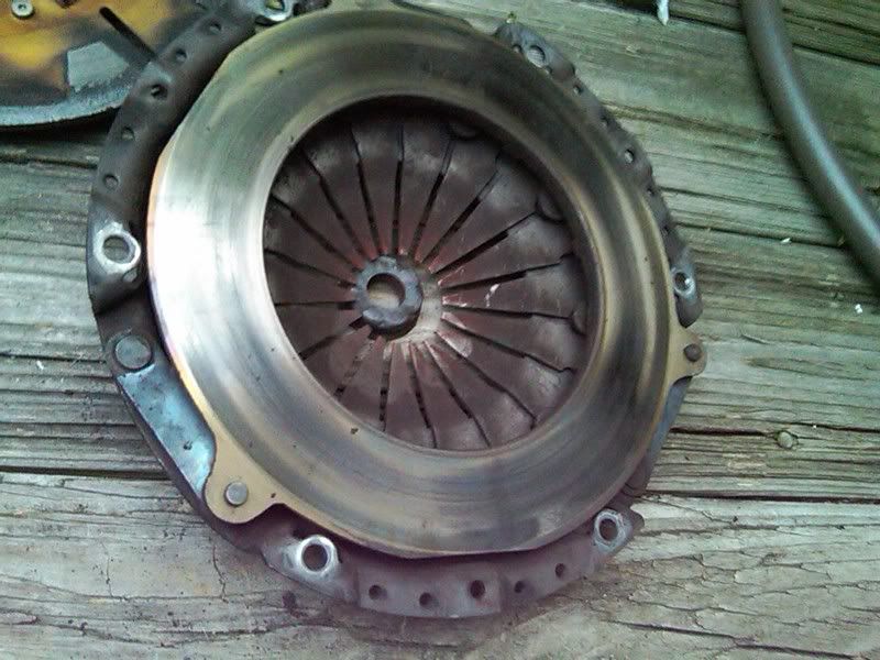

Ok here is a pic of the pressure plate. I did not get a pic of the disc I put in. You can see it has two diaphrams in it. This clutch should hold over 700ft.lbs of torque. And best of all no break in period. Going to replace the hydrolic system tomorrow so hopefully that will fix the car. I really dont want to pull that tranny out of this thing.

david-b
08-21-2009, 12:01 PM
I see on the pic there's bolts on the pressure plate around the diaphrams. Does that allow to take out the inner set?
SilvrEclipse
08-21-2009, 12:58 PM
We had to use bolts to hold it all together. Rivets would work for some reason. I don't remember what was wrong with them. Just got done with classes today so I'm about to go change the hydraulics and see if that fixes the problem

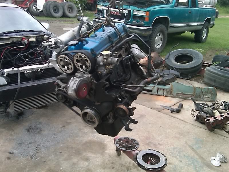

So an update on the situation. Ended up havin to pull the motor again on saturday. Changin the hydrolics didn't help much. It made the pedal a lot softer, also made a longer slave rod for it. None of which released the clutch. So ended up putting 90/1000" worth or washers under the plate. Got everything running today and the clutch does release and the car is drivable.
The bad: Putting those washers under the plate lifted it to much and now I have lost all of the plate load and the clutch slips when you boost the car at all. So basically the new clutch is worse than the other one. This was pretty much the last option we had for a zoom clutch so now Im buying an ACT 2100 pressure plate and using that with my flywheel and disc I have now. ACT disc suck so Im not using theirs. So the motor is coming back out in about 2 weeks to get it changed again. :(
On the plus side we did have the motor out the car in under 2 hours. I think it was about 1hr and 45min. We are fuckin pros now. So I guess its not that big of a deal.
