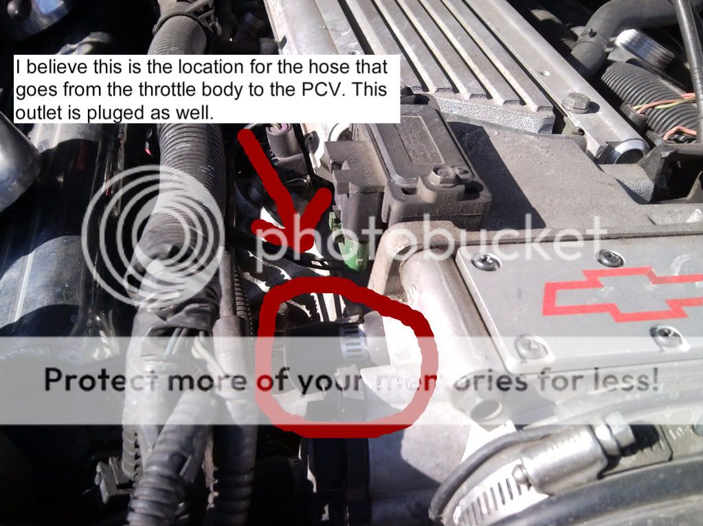

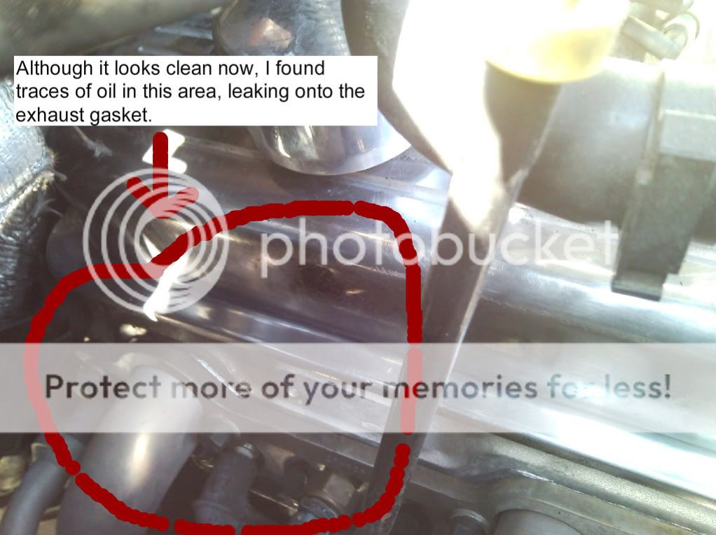

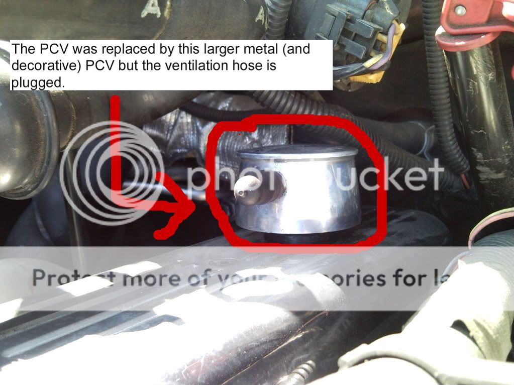

Hey All,
So, I had a few minutes on my hand this morning so I did a quick check under the good on the PVC and hoses along with the oil level.
The oil level has dropped by about a quart since I last checked it a few days ago.
I checked the PCV and hoses and it turns out there is no hose between the throttle body and the PCV. As a matter of fact, the PCV has been replaced by a larger metal PCV with the outlet tip plugged off. The outlet tip on the throttle body is plugged off as well.
On top of all that, I found streaks of oil on the valve covers where the PCV is as well as the headers, leading me to believe it’s been leaking out.
Check out the pics below.
The metal PCV:
http://i900.photobucket.com/albums/ac208/lt1silverhawk/1248195902-1.jpg
The Throttle Body:
http://i900.photobucket.com/albums/ac208/lt1silverhawk/1248195903-1.jpg
The place where oil appears to be leaking:
http://i900.photobucket.com/albums/ac208/lt1silverhawk/1248195898-1.jpg

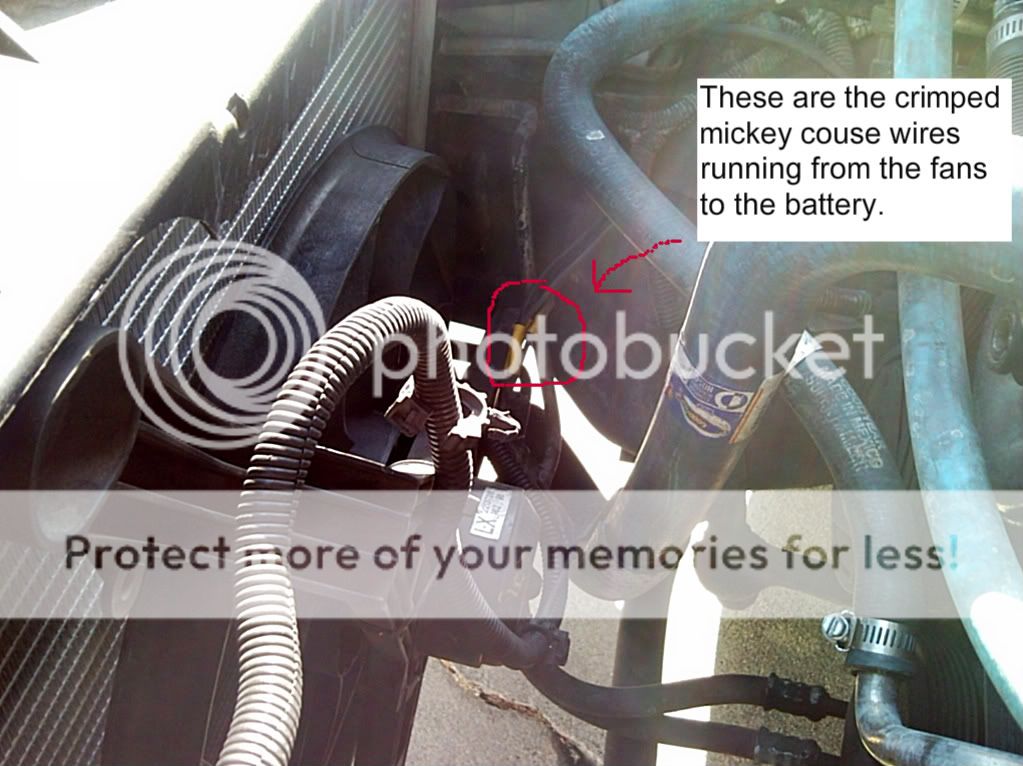

The mickey mouse fan wires:
http://i900.photobucket.com/albums/ac208/lt1silverhawk/1248195892-1.jpg

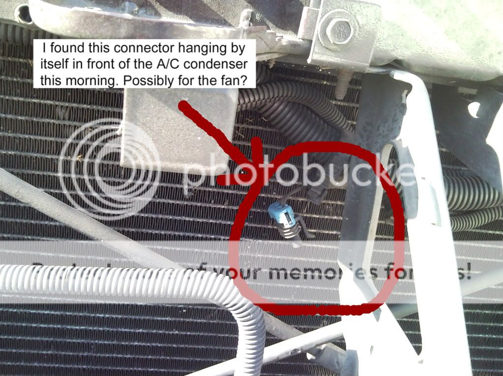

A lonely connector, possibly for the fan:
http://i900.photobucket.com/albums/ac208/lt1silverhawk/1248195894-1.jpg (http://i900.photobucket.com/albums/ac208/lt1silverhawk/1248195894-1.jpg)
The metal PCV:

The only experience I have had with this model engine is my mother's 94 CAPRICE LS that has the baby LT1 (4.3 V8). From what I can see from your pictures is that the PCV has been disabled. Effectively sealing the crankcase tight. This is not good. All that crankcase pressure is blowing the oil out where ever it can. Leaking onto the header gasket is an example. If it is leaking onto the gasket some of the oil is probably hitting the very hot header pipe causing the hot oil smell. The oil is burning off the pipe completely probably not leaving any trace.
The principle behind the workings of a PCV valve is to draw off crankcase vapors i.e. "blowby" by a metered vaccum draw with the metering device being the PCV valve. The pcv valve draws the vapors into the intake to be burned but the vapors being drawn in must be replaced by a fresh air source that is usually drawn from the air cleaner on carbed engines or the plenum on fuel injected engines. any one of these pieces of the puzzle being messed with can cause trouble.
Check out the flow of your PCV system. The hose routing may be on a sticker in the engine bay.
HOPE THIS HELPS

…From what I can see from your pictures is that the PCV has been disabled. Effectively sealing the crankcase tight. This is not good. All that crankcase pressure is blowing the oil out where ever it can. Leaking onto the header gasket is an example. If it is leaking onto the gasket some of the oil is probably hitting the very hot header pipe causing the hot oil smell. The oil is burning off the pipe completely probably not leaving any trace.
My thoughts exactly… The oil is leaking out when I accelerate, falling onto the header and burning off with the heat.
I checked the Chilton’s manual for Fbodies with LT1’s (it’s all I could find on short notice) and there is a diagram for the PCV setup and the hose goes from the throttle body to the PCV at the same locations where it is plugged off on my car.
The weird part is that there didn’t seem to be any oil burning before the last oil change.
It does leave me wondering why the PCV hose would have been removed and the valve and the throttle body plugged off. I can’t see any benefits.
I’m gonna buy a vacuum hose and put it on the throttle body and the PCV today. The original hose was a molded plastic I believe but I don’t think it should make a difference if I use an off-the-shelf one from AutoZone or Napa.

the pcv / crankcase vent was removed,,,possibly to reduce blowby gasses getting into the throttle body...I suspect an engine that was abused....sorry ....
the passenger side of engine is where the vent for crankcase should be into the valve cover, this then goes into the side /top of the throttlebody that was pluged in your picture...on the driverside into the intake manifold is the PCV location...then the hose from the PCV goes into the bottom of the throttle body under the air intake ,,,,hose hard to get at....
the fan wires where hacked ,,,typical mechanic electrical job...
the oil that should be used is 10-30wt....
the lack of crankcase venting will cause the gaskets to blow out as pressures in the crankcase will do this....as well as any hoses/valve cover gaskets etc...a good running engine should have a slight vacuum in the crankcase...
with your engine running and hot I bet with the oil fill removed it smokes out of the fill hole pretty good..as it is now..
most likely they screwed up the re-build or did not properly break in the engine,,
see if it is not as serious as I suspect,,,keep us informed..
So I went to NAPA today and the guy I spoke to basically confirmed what j cAT said: its either an abused or improperly rebuilt motor.
He suspects that either a piston ring or a piston is damaged and the air inlet valve on the right side of the engine was blocked off by the shop before sale as a quick fix.
But one would think that would have been an easy fix when the heads were removed for the headgasket job.
Another thing the guy ay NAPA mentioned was that if I put the hose back on, the morot would be gone in a month. Any thoughts on that?

So the conversation turned to the PVC system. He said the valve covers are aftermarket valve covers the previous owner brought in to have ‘The Shop’ install them. The passenger-side cover had to be notched to accommodate the alternator bracket (this I was informed of when I bought the car).The original valve covers allegedly had no air inlet on the passenger-side (I was calling BS in my mind).
I told him that, after having spoken to several people, I have learned that this is part of the original PCV system and should not have been messed with. He wouldn’t give me a straight answer, instead reiterating that the previous owner brought in the valve covers to be installed and that is just what ‘The Shop’ did. And it was too long ago to remember any specific details now (he claims four to five years ago). The shop has no paperwork records.
When I pressed him some more about the air inlet being plugged off, he admitted that it could cause the vale cover gaskets to leak, but he could see the benefit of hooking up a hose between the inlet valve and the throttle body. He didn’t think the increased pressure in the crankcase could cause the head gaskets to fail.
So then we moved onto the infamous thermostat bypass/ fan wire hack job. I asked him why this was done and he said the fans are wired to run off the computer which had been tuned to run the fans at a very low temperature. If I installed a thermostat, it would cause the fans to run continuously because the engine would be warmer than what the computer has been programmed for. He said that ‘The Shop” always had a problem with the car overheating and finally figured this was the method since the engine is setup for reverse-flow cooling and running the engine super-cold allows for higher compression (he claims its up by .5 compared to stock LT1).He further mentioned that I can’t consider stock temperature specs because the engine is far from stock.
So basically, he’s sticking with his ‘we sold just the way it was’ deal.
I, on my part, will be hooking up the hose (the one I bought was too small for the throttle body) and changing the oil to 20w50 and watch what happens.
As of right now, the oil consumption seems to have dropped and I no longer smell any oil burning.
Perhaps thick oil is all that’s needed after all?
