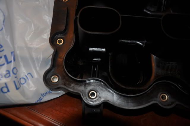

Okay I have finally gotten around to taking the intake off after the noise came back. I wanted to post a picture to make sure I have this right.
So the upper part of the manifold is 2 pieces with just 2 clips holding it in place which the picture is showing one of them.
http://i228.photobucket.com/albums/ee2/SlimJimRD/On%20line%20picture/DSC_0285.jpg
Do I RTV around the whole thing or a just a few places?

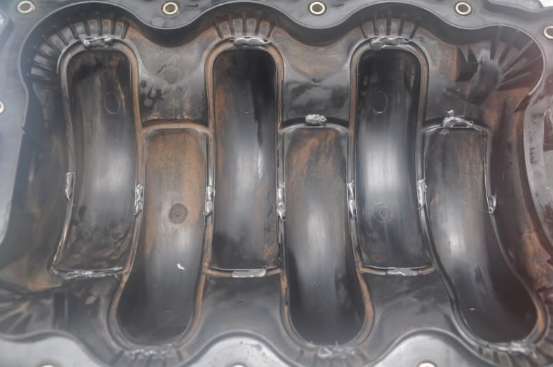

Well, the "conventional" wisdow is separate the two pieces ...even if you have to break the clips. Do a bit of cleaning, and "RTV" the pieces back together ... 4 or 5 one-inch daubs should be OK.
If you want to do what I did (which is NEVER recommended! LOL!) ... separate the two pieces ... making sure the clips are removed. Do some cleaning, then "RTV" the inner "horn" piece ... not to the upper, but to the intake-spacer (the section the throttle control is attached to ...) RTV thoroughly, a complete sealing bead around each of the six "pipes". The intake manifold will work pretty much the same ... but the EGR jets will plug less often.

Okay I am going the conventional route this time, sorry 12ounce.
I have taken it apart, cleaned with brake cleaner and will be using the Ultra Black RTV sealer.
If I decide to go the 12ounce route in the future. Did you break the clips off before you sealed the inner horn piece to the lower? It kinda of looks like if you didn't then the clips could still engage and then cause problems trying to take the top part off later.

Here is a picture of the RTV before I put the halves together.
http://i228.photobucket.com/albums/ee2/SlimJimRD/On%20line%20picture/DSC_0286.jpg
Now it is pouring rain so I got soaked trying to put everything in the van and out of the rain. No garage at my house just a nice hill to deal with. I hope it stops before it gets dark so I can put everything together.

I hope you were able to assemble things together before the RTV cured! The daubs in the photo look fine to me ... more than needed perhaps ... but should work very well. (So far, we only had rain at nighttime this weekend.)
Yes, I did break away the clips before sealing the horns to the spacer. I did a lot of fitting/measuring, using modeling clay for impressions, etc, etc ... before convincing myself it was the way to go. And this was not my first assembly ... the first time, maybe even the second time, around I went the "conventional" way.
