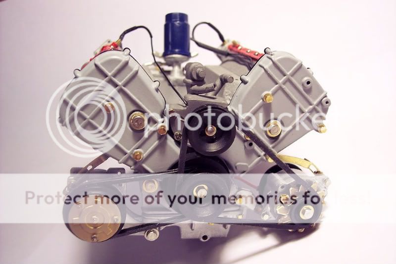

bmwmech1
01-04-2009, 09:47 PM
Now we start into the engine photos... I'll try to describe the changes and mods, but if you see something or have a question, just ask.
First up is a straight-on shot... water pump modified with correct outlets on front and rear of thermostat housing, Alt and A/C brackets made from brass, alternator is adjustable for correct belt tension via brass bolts, misc detailing with brass and stainless bolts washers, nuts...
http://i713.photobucket.com/albums/ww136/bmwmech1/100_1901.jpg
Next is a rear shot, showing the modified oil filter/oil pressure mount with correct pressure line outlets for the return line and feed lines for the turbos and the sending unit electrical connector, Magnetti/Marelli Cam sensor housings with electrical connectors added, breather tube with P/E clamp(still another clamp and P/E coverplate to add at bottom where it disappears into the belhousing) P/E inspection "grid" on top of bellhousing and misc nuts, bolts, washers...
http://i713.photobucket.com/albums/ww136/bmwmech1/100_1902.jpg
Now I'll just post a few more shots and you all can ask questions at will... The acorn nuts are from Marvin at Model Motorcars and a keen eye will notice the mods to the exhaust manifold flange castings on the cylinder head and the modified intake manifold mounting area. Both have been heavily modified to be more correct and I'll post pics when they are ready to fit to the motor... Enjoy again! BM1
http://i713.photobucket.com/albums/ww136/bmwmech1/100_1904.jpg
http://i713.photobucket.com/albums/ww136/bmwmech1/100_1897.jpg
http://i713.photobucket.com/albums/ww136/bmwmech1/100_1898.jpg
http://i713.photobucket.com/albums/ww136/bmwmech1/100_1899.jpg

Just a heads up before you make too much progress though, the decal on the oil filter is incorrect (is a window tint one).
Also, what size were the acorn nuts you have on the heads? I'd like to get some for my own F40.

I knew the decal was not correct... it is actually the DOT decal for the windows which is why I put it on backwards, so you can't read it. Didn't happen to have a Mahle decal and the filter ends up buried under all the intake/turbo plumbing, so it's only an issue in the photos. Thanks for pointing that out, though. Sharp eye...:grinyes: The acorn nuts are from Marvin at www.modelmotorcars.com and they are part # A007. They're $1 a piece and I ordered 50 to do the cam covers and the intake plenum bolts, with a few left over. Hope that helps... Thanks for looking!!!

First is the removal of the kit dash support/windshield mount...
http://i713.photobucket.com/albums/ww136/bmwmech1/100_1946.jpg
http://i713.photobucket.com/albums/ww136/bmwmech1/100_1945.jpg
Next, we have the removal of the kit rear rollcage tubes and top frame rails...
http://i713.photobucket.com/albums/ww136/bmwmech1/100_1947.jpg
http://i713.photobucket.com/albums/ww136/bmwmech1/100_1948.jpg
Next, the removal of the kit under roof detail, A pillar thickness and also B pillar rollcage detail, all of which was cast into the body...
http://i713.photobucket.com/albums/ww136/bmwmech1/100_1949.jpg
And finally, some shots of the "hacked up" body on the frame. Note how the windshield frame now sits right on the bracket which extends up from the dash crossmember...
http://i713.photobucket.com/albums/ww136/bmwmech1/100_1952.jpg
Also, you can see the pedal mount sitting on its "box"...maybe a little easier to identify its placement in the photo above...
http://i713.photobucket.com/albums/ww136/bmwmech1/100_1951.jpg
And the rear, now without the kit parts attached anymore...
http://i713.photobucket.com/albums/ww136/bmwmech1/100_1953.jpg
Thanks for looking!!!:)
BM1
