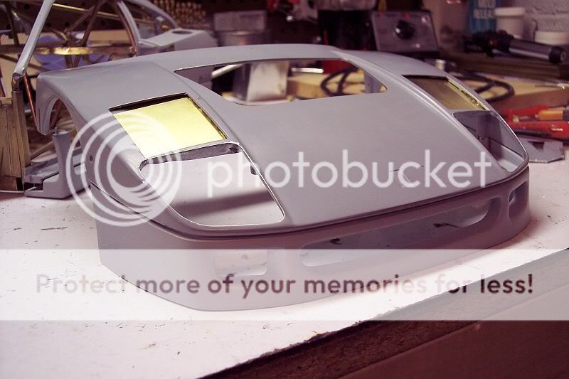

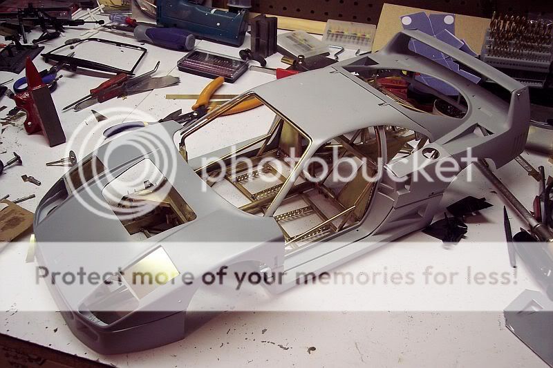

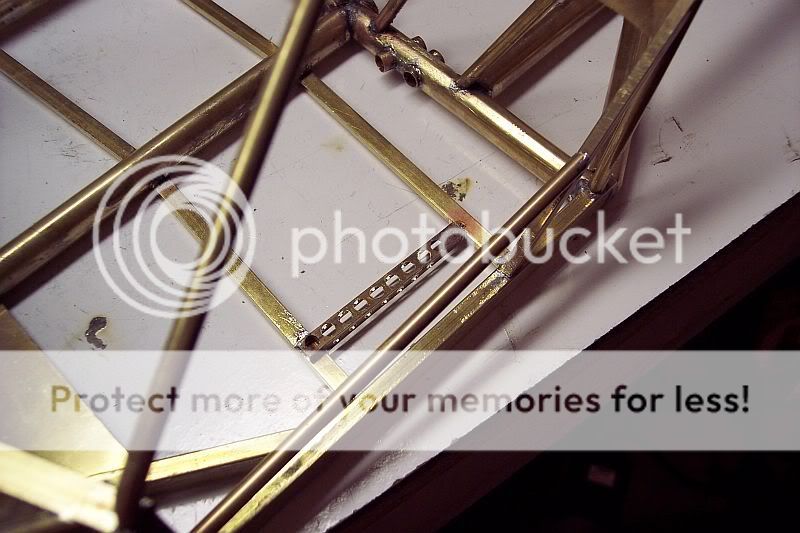

This is just a quick assortment of stuff. If anyone has any specific questions, please let me know...

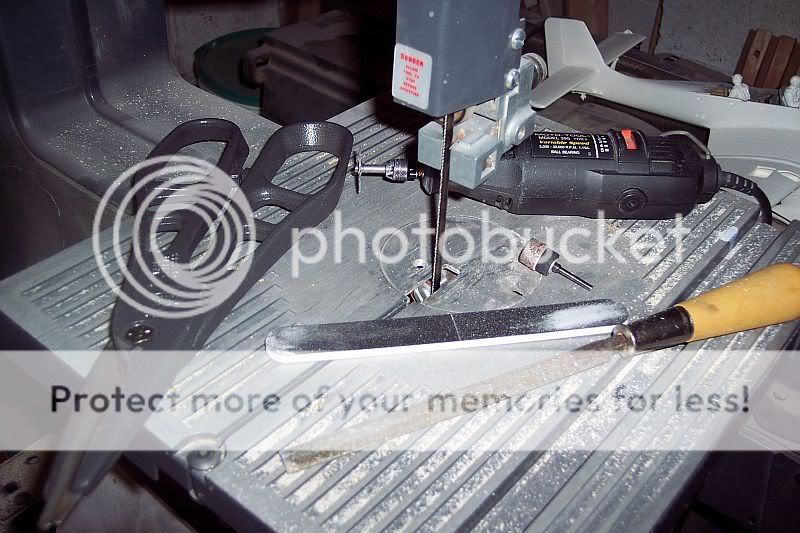

Thanks for the answer. Looks me that there's not a "easy" way to cut brass sheets. May be I try to find a smaller thread for the band saw.

I always have a few kits going at the same time. That Stuka is a diversion... about half finished. I am building that and a Spitfire to hang from the ceiling in my office at my shop. They are the old mpc 1/24th scale kits... nice and big! I did see the aircraft forums... not as passionate about aircraft, though.
I have found the big metal shears to be the best way to cut sheet, so long as it's not too thick. The cutting blades are about 40 to 50mm long, so the cuts are nice and straight. Can't do much detail cutting with them, though.:2cents:

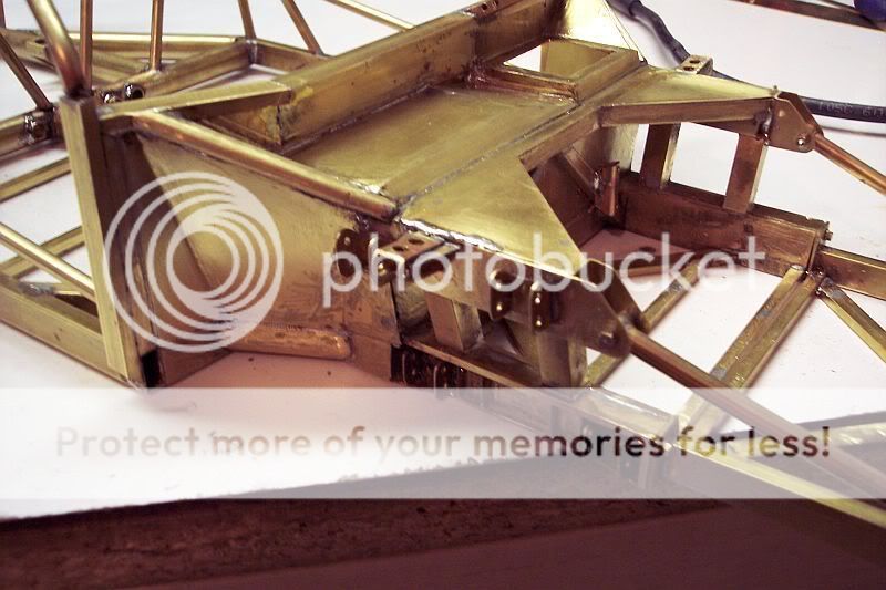

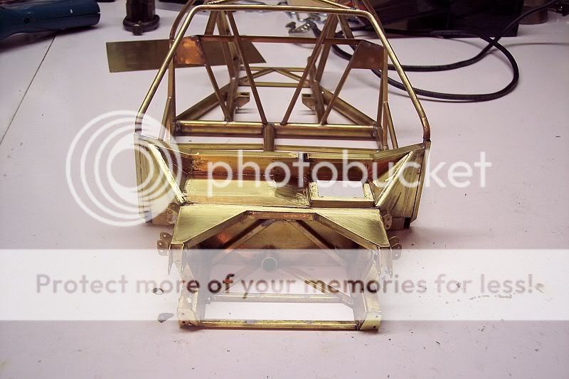

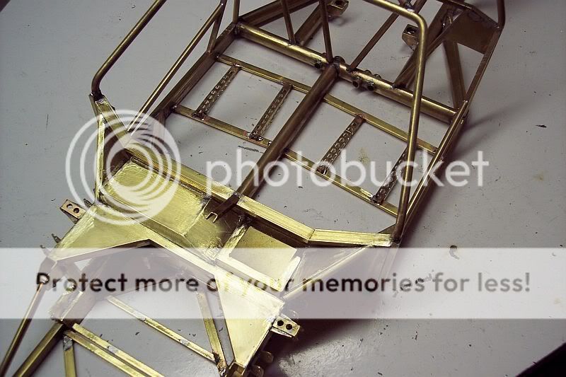

Alright, 4 more new pics of tonight's progress so far... I finished closing in the footwell on both sides, which leaves just the steering rack and swaybar mounts left to complete for the major stuff remaining up front. Now I'll have to move to the rear-end soon...:smile: It's nice when you use a piece for one side as a template for the other side and they actually fit as mirror images. That happened tonight when I was closing in the footwell. Makes you feel like your work is worthwhile... Here's the pics... Enjoy!
http://i713.photobucket.com/albums/ww136/bmwmech1/100_1957.jpg
http://i713.photobucket.com/albums/ww136/bmwmech1/100_1958.jpg
http://i713.photobucket.com/albums/ww136/bmwmech1/100_1960.jpg
http://i713.photobucket.com/albums/ww136/bmwmech1/100_1959.jpg
That's all for now, thanks for looking!!!:smile:

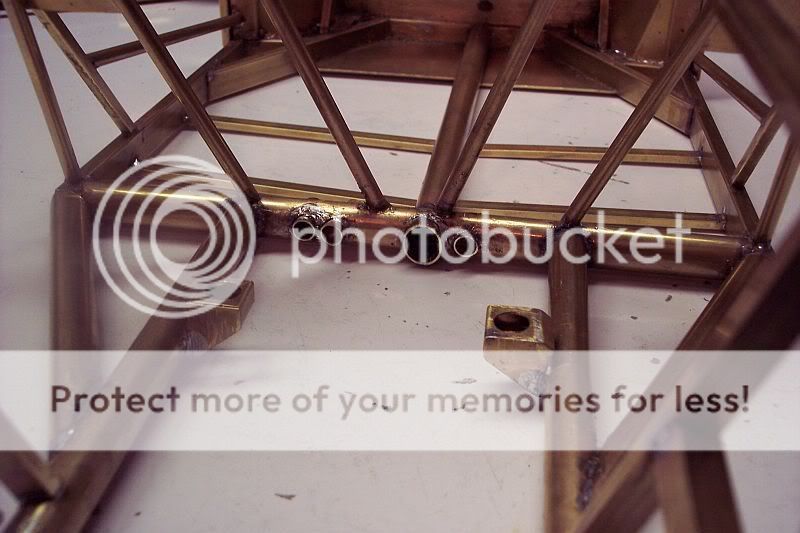

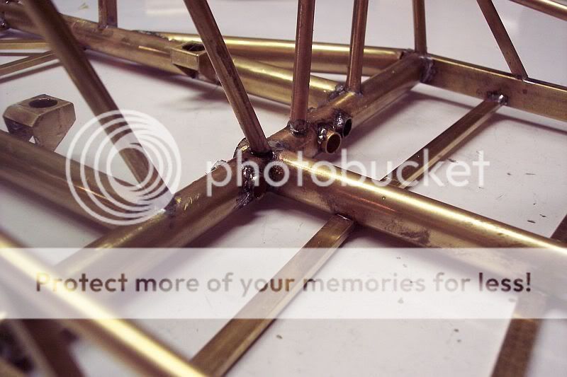

Not much progress tonight, but I did get the front shock mounts and steering rack mounts done and got the holes opened up in the rear main frame cross tube. These holes allow the shift linkage, engine computer harnesses and the coolant lines to pass through this big frame tube. I should have done this alot earlier... it would have been way easier!!!:shakehead:shakehead:shakehead
Anyway, enjoy the pics and thanks for looking!!!
Front shock mounts...
http://i713.photobucket.com/albums/ww136/bmwmech1/100_1968.jpg
Steering rack mounts...
http://i713.photobucket.com/albums/ww136/bmwmech1/100_1961.jpg
Coolant tube and other holes opened...
http://i713.photobucket.com/albums/ww136/bmwmech1/100_1964.jpg
http://i713.photobucket.com/albums/ww136/bmwmech1/100_1962.jpg
http://i713.photobucket.com/albums/ww136/bmwmech1/100_1966.jpg
Thanks again!!!:smile::smile::smile:

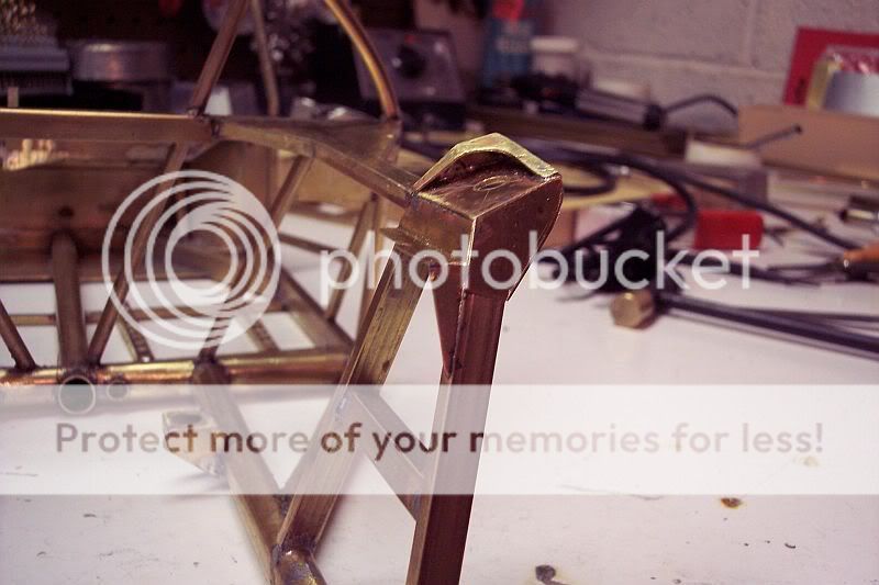

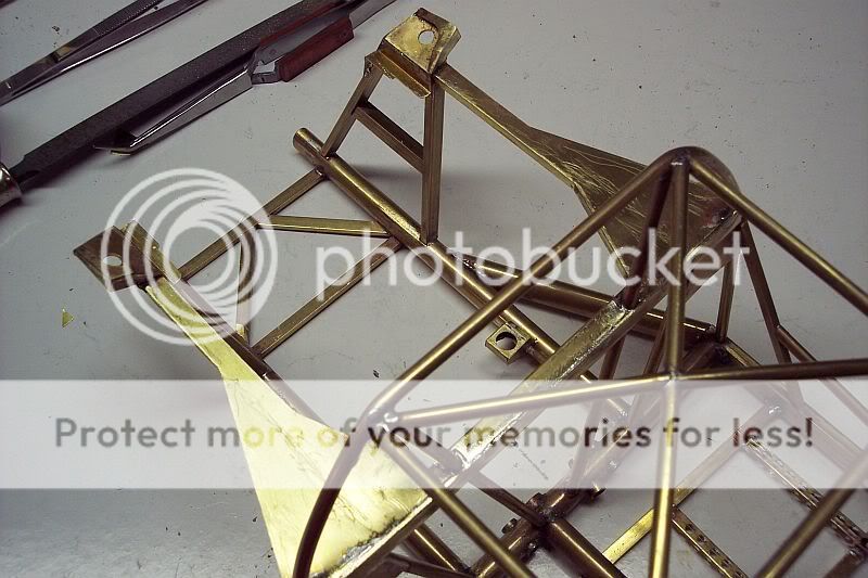

New update for tonight... finished the 3 other seat mounts. Now, just a few more little things up front, like the shifter bracket and the swaybar mounts, and it's on to the rear!!! Enjoy and thanks for looking...:):):)
http://i713.photobucket.com/albums/ww136/bmwmech1/100_1974.jpg
http://i713.photobucket.com/albums/ww136/bmwmech1/100_1975.jpg
http://i713.photobucket.com/albums/ww136/bmwmech1/100_1976.jpg

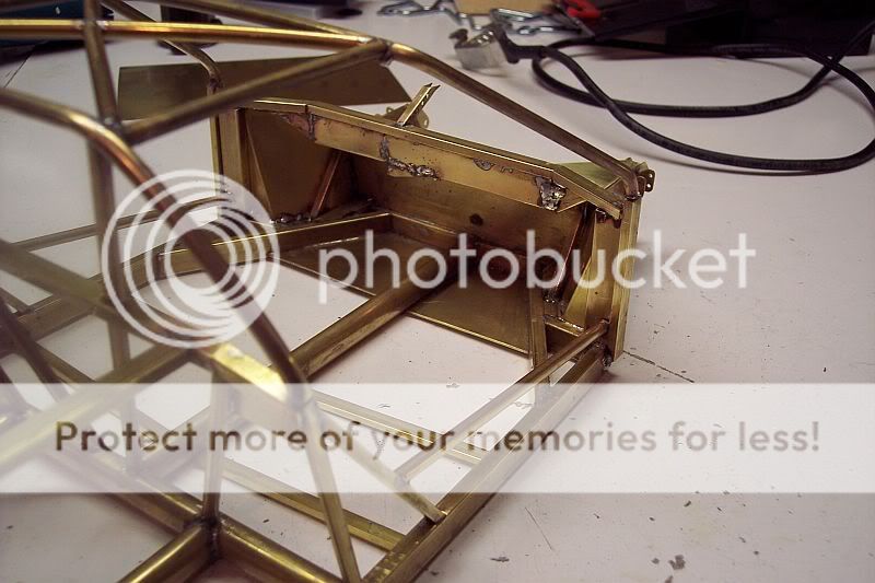

Alright, I didn't get any work done until tonight... no energy with this virus I've had. Made decent progress on the big stuff at the rear... Enjoy and thanks for looking!!!:):):)
http://i713.photobucket.com/albums/ww136/bmwmech1/100_1979.jpg
http://i713.photobucket.com/albums/ww136/bmwmech1/100_1978.jpg
http://i713.photobucket.com/albums/ww136/bmwmech1/100_1977.jpg
As you can see, I got most of the big stuff knocked out... now just a ton of brackets to fab up and solder on!!!

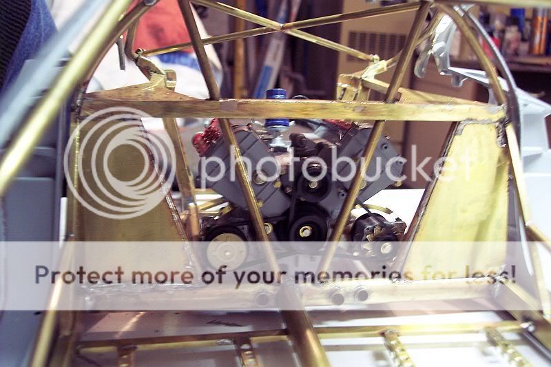

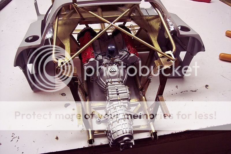

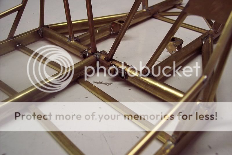

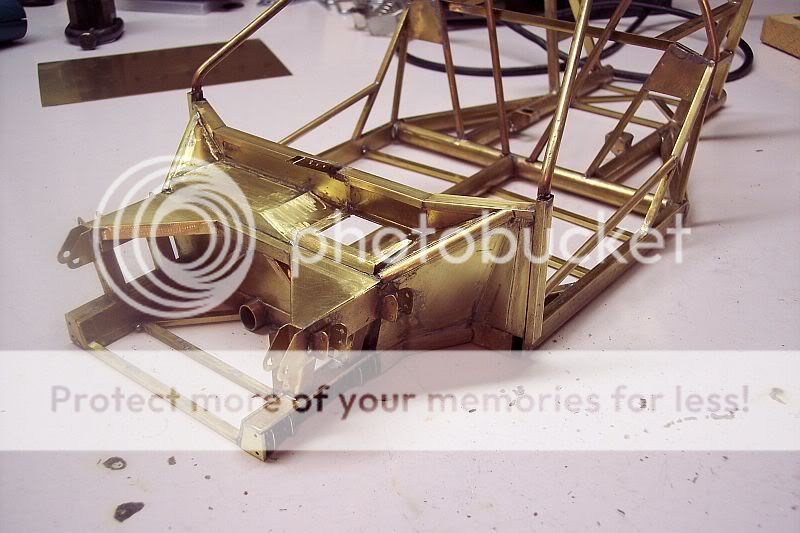

Quick Saturday night update... got more done on the rearend and the decision has been made to do a LeMans version. You'll see the X brace over the motor, which is specific to the race-only versions. The street version only has 1 diagonal. Enjoy and thanks for looking!!!
First pic you can see the X brace, the rear cage tie-ins at the tops of the shock towers and more bracketry completed...
http://i713.photobucket.com/albums/ww136/bmwmech1/100_1989.jpg
Second pic shows a good view of the gussets I added at the base of the suspension towers...
http://i713.photobucket.com/albums/ww136/bmwmech1/100_1990.jpg
Last pic is a view you never get with a Pocher F40... through the windshield opening, looking back through the bare chassis to see the front of the motor. I have may reference pictures like this view, but you can't get this shot if you don't scratchbuild the frame!!!:cool:
http://i713.photobucket.com/albums/ww136/bmwmech1/100_1992.jpg
Thanks again:smile::smile::smile:

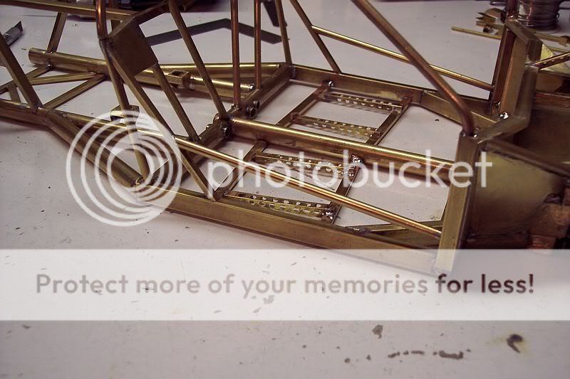

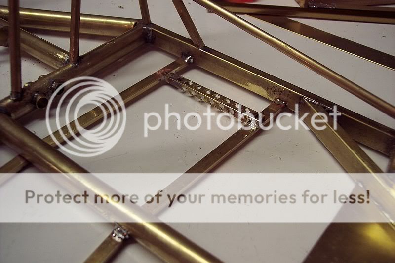

Last update for the weekend... The rearend is really coming together! Not too many big items left to do excluding the suspension. Got most all of the bracing and bracketry done, got the fuel tank outriggers done, so I'm happy! Now I guess I need to make the fuel tanks...Enjoy and thanks for looking, as always! http://www.f1m.com/main/forum/images/smilies/icon_biggrin.gif http://www.f1m.com/main/forum/images/smilies/icon_biggrin.gif http://www.f1m.com/main/forum/images/smilies/icon_biggrin.gif
http://i713.photobucket.com/albums/ww136/bmwmech1/100_1996.jpg
http://i713.photobucket.com/albums/ww136/bmwmech1/100_1995.jpg
http://i713.photobucket.com/albums/ww136/bmwmech1/100_1993.jpg
Thanks, BM1

Utterly brilliant build...really enjoying these photos.
One piece of advice though; you may want to undo the alternator mounting bolt and pull it out a wee bit as the drive belt looks a little slack!:grinyes: :popcorn:

bmwmech1
02-02-2009, 01:48 PM
You know, I think I bumped it putting it in the frame... should have caught that.:lol: It is adjustable though, just in case you were wondering...:wink:

First update this week... I decided to change it up a little and work on the bodywork a little tonight. Started out with the kit front-end and went to town with the dremel. I needed to open the giant hole in the center of the hood, enlarge the factory driving light locations, as these will become the headlight housings for the 95 LeMans version I am building and start to fill in the factory headlight openings, since these are non-existant on the LM version of the F40. Whats left is to fill and smooth the headlight delete panels I made from brass, cut-in 5 slots per side above the front wheel locations and cut-in a central NACA duct right above the hood emblem. There are more mods to be done, but that's enough for right now... Enjoy!!! :) :) :)

bmwmech1
02-07-2009, 11:32 PM
It's not an exciting update, but I completed the front subframe, tonight. Most of the joints are cleaned up and now it needs wetsanded before I plate it. I will do a copper plate first to even everything out and then a nickel plate to simulate the polished aluminum finish on the 1:1 LM version. Enjoy and thanks for looking!!! http://www.f1m.com/main/forum/images/smilies/icon_smile.gif http://www.f1m.com/main/forum/images/smilies/icon_smile.gif http://www.f1m.com/main/forum/images/smilies/icon_smile.gif
All of the electronics brackets and radiator brackets are done along with the square tubing that mounts the front bodywork to the subframe.
http://i713.photobucket.com/albums/ww136/bmwmech1/100_2004.jpg
http://i713.photobucket.com/albums/ww136/bmwmech1/100_2003.jpg
http://i713.photobucket.com/albums/ww136/bmwmech1/100_2002.jpg
BM1
BM1

bmwmech1
02-17-2009, 11:49 PM
At last, an update! Unless I have missed something, I believe the frame is finished!!!:):):) I still have many hours of prep before the main frame goes to primer, but some of the sub-assemblies are ready and I even got some pieces prepped and primed tonight! I also received my Brummel decal set from Manfred at m-tec, today, so I snapped a picture of them also. Enjoy!!!
http://i713.photobucket.com/albums/ww136/bmwmech1/100_2032.jpg
http://i713.photobucket.com/albums/ww136/bmwmech1/100_2034.jpg
http://i713.photobucket.com/albums/ww136/bmwmech1/100_2037.jpg
http://i713.photobucket.com/albums/ww136/bmwmech1/100_2035.jpg
As always, thanks for following!!!:):):)
BM1
BM1
tuned.by.twenty
02-17-2009, 11:52 PM
That frame is art! I can't wait to see it primered.

bmwmech1
02-20-2009, 07:47 AM
I'm traveling this weekend, but I couldn't leave everyone without the latest photos to look at. Got the frame prepped and shot with 1 coat of primer last night. Still some thin spots and there will be some filling/sanding to do before color, but hey, at least it's grey now! There was alot of real estate to cover with primer... I realized that this frame is big, once I started to paint it!:smile::smile::smile: Enjoy!!!
http://i713.photobucket.com/albums/ww136/bmwmech1/100_2040.jpg
http://i713.photobucket.com/albums/ww136/bmwmech1/100_2041.jpg
Thanks for looking and have a great weekend!!!:biggrin:
