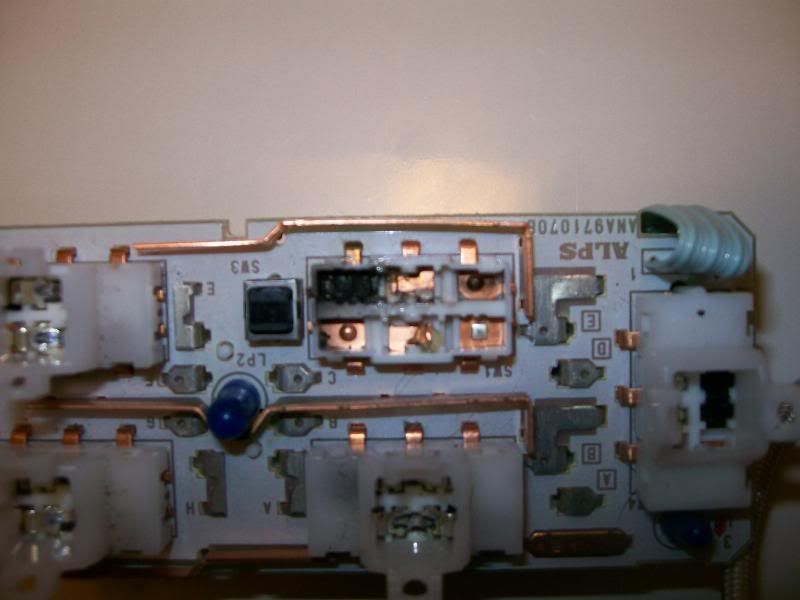

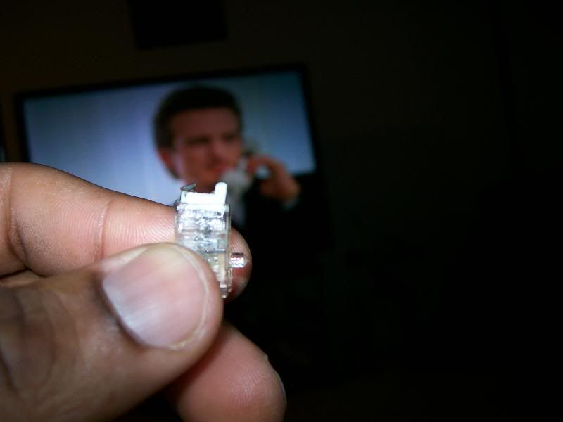

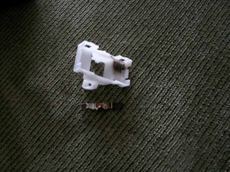

Well, I was kinda curious of why the switch stopped working. So I took it apart, and this is what I saw...
http://img.photobucket.com/albums/v307/iamsodamnconfused/100_0441.jpg
it looks like something got really hot, and started burning. The plastic around it is really charred.....
http://img.photobucket.com/albums/v307/iamsodamnconfused/100_0433.jpg
http://img.photobucket.com/albums/v307/iamsodamnconfused/100_0447.jpg
At least it didn't burn my car to the ground:evillol:

Those are great photos and its realy nice of you to take the time to supply us with your findings,it will help me and others in the future,thank's.

That is a pretty common condition. So common, in fact, that there is a procedure posted here about fixing it: http://www.naioa.com/v2/modules.php?name=Forums&file=viewtopic&t=14592
please_pimp_my_rde
01-10-2009, 10:18 PM
I think mys was beyond repair...
Iflylow
01-11-2009, 02:46 PM
So was mine, but that procedure made it work again for a few weeks, until I could get a whole new switch box.
