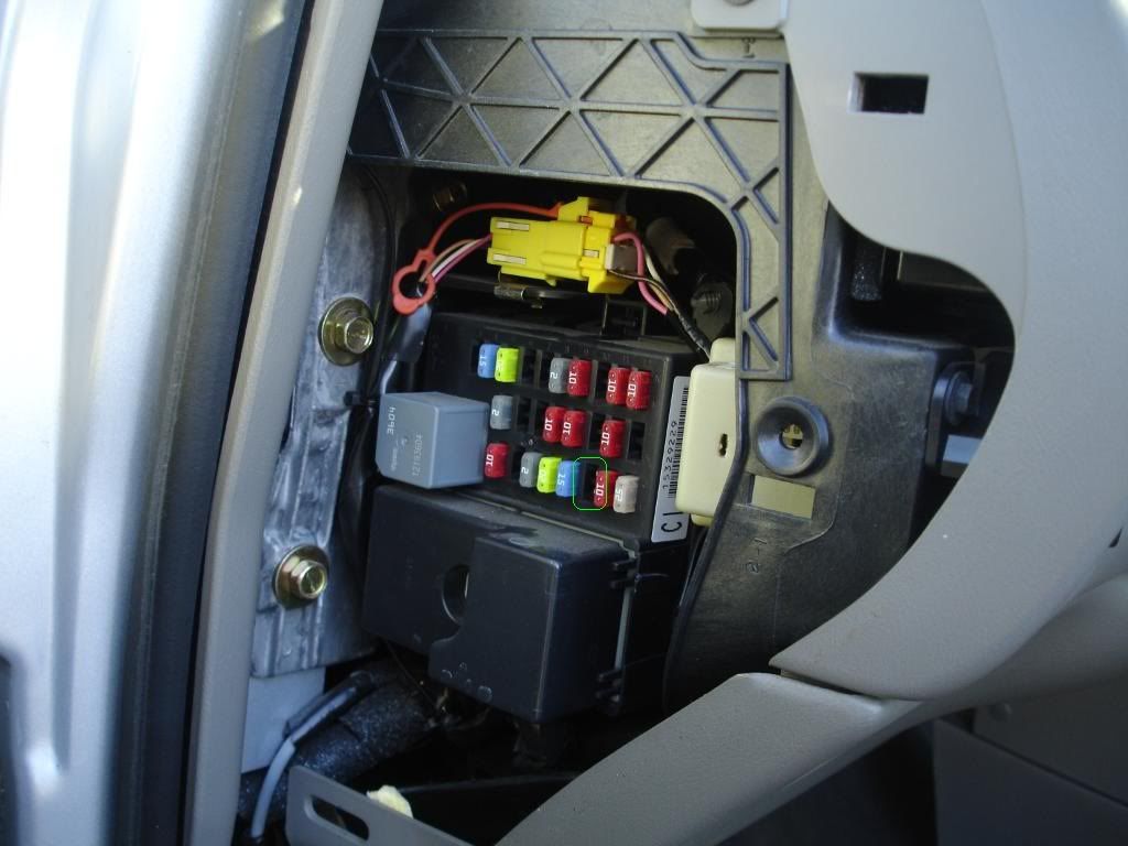

Disconnect the negative battery cable for 30mins, timed it, and removethe SRS fuse from the IP fuse panel located on the inside of the drivers door panel. If you want to test to see if you removed the correct fuse, turn car on (if you haven’t already disconnected it from the battery), and your red airbag light will stay on steady. The follow picture shows the 10A fuse I removed in this process

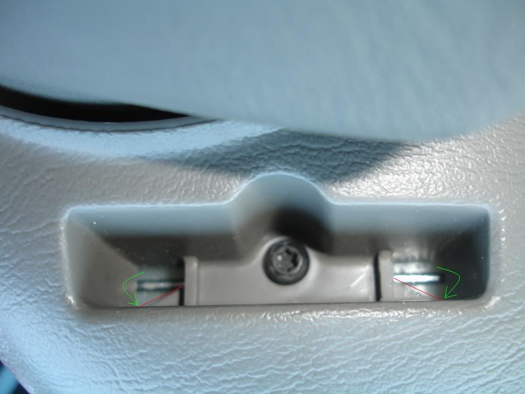

Now that you have waited 30mins tilt the steering wheel down as far as it will go. Turning the wheel will be difficult now because no power steering, but turn it 90 degrees either way. On the back side of the wheel, you should now be able to feel, or with a small mirror see this.
http://i236.photobucket.com/albums/ff143/winty03/DSC04374.jpg
There is no need to attempt or remove the torx screw in this process, so just leave it alone. What the trick is to use a “pry” tool. Slide it to the side of the pin that DOES NOT have the angled plastic. Slowly twist the screw driver to 90 degrees and pull gently on the front of the wheel on the horn’s edge. Here's an illistration of what you need to do. The pin needs to be in the red lines posistion to be freed.
http://i236.photobucket.com/albums/ff143/winty03/untitled-1.jpg

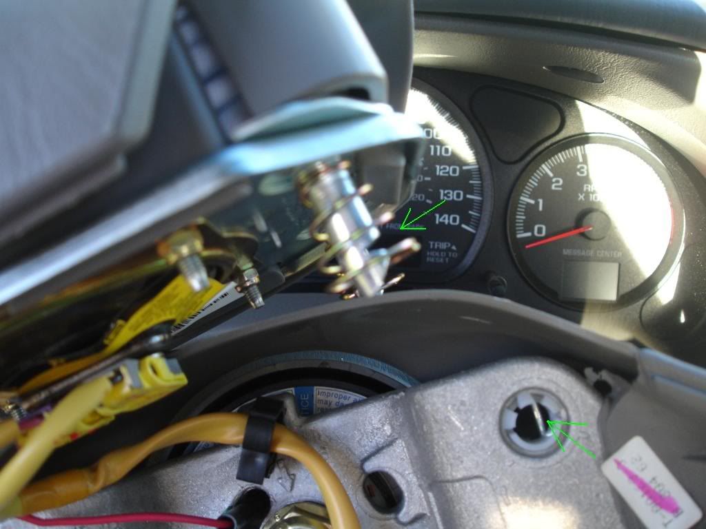

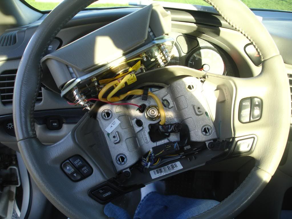

You will see the center piece (airbag/horn) trying to pop out. Applying outward force will help keep the clip from locking back in. Repeat to the other side of the airbag/horn and the entire center piece of the steering wheel will pop free. DO NOT PULL ........WIRES ARE ATTACHED. Gently lift entire assembly up and place it on top of steering column, in center of wheel. It will look like this.
http://i236.photobucket.com/albums/ff143/winty03/DSC04355.jpg
In this photo you can see the pins you were twisting/pushing out of the hooks in the previous step.

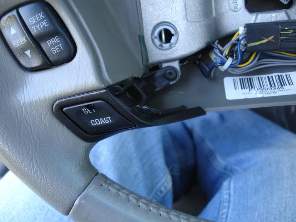

Using a torx 20 bit remove the screw retaining the button you wish to remove. DO NOT pull hard on buttons there is limited wiring attached to the button!!!
http://i236.photobucket.com/albums/ff143/winty03/DSC04356.jpg

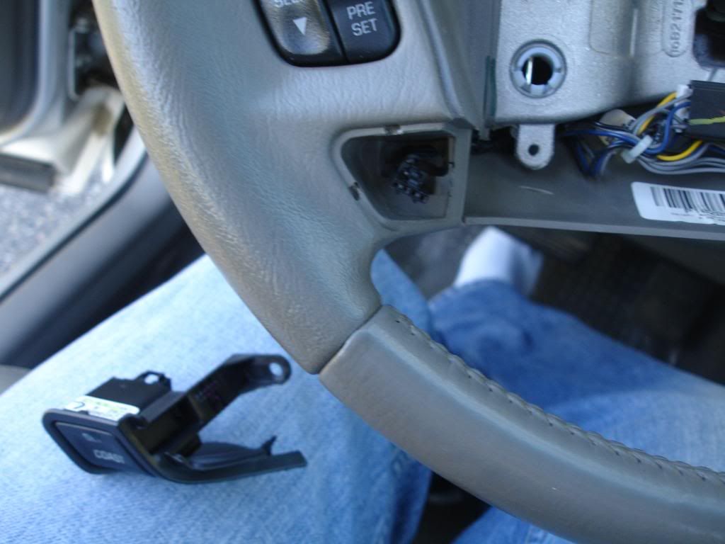

Release clip from back off button and remove.
