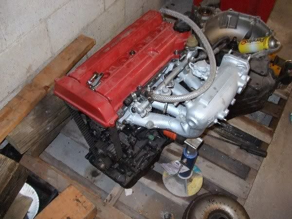

well...it didn't come with the transmission...i was going to sell it anyway b/c i'm not converting to hydraulic...just got back from Maryland and it's still ing the Cruiser...here's a teaser
http://img512.imageshack.us/img512/347/dsc02017me4.jpg
Christ
10-12-2008, 06:25 PM
Did he give it to you for less since there was no tranny? The CTR tranny is a very valuable piece... just like the engine is.
BLU CIVIC
10-12-2008, 07:22 PM
no...same price...wife wan't too happy...thought she was going to cuss him out:p but she trusted my judgement...i told her it was still a good deal
B16B
Skunk2 intake manifold
DC Sports 4-2-1 (would be nice to have a 4-1)
starter
distributor
clutch/flywheel
$1500
B16B
starter
distributor
clutch/flywheel
$1500
Christ
10-12-2008, 08:27 PM
yeah, $1500 was the low end for just the motor... at least from what I've seen.
Like I said before, 3-5k for the motor and tranny, no aftermarket parts.
The intake and header you can't really take at retail value, as aftermarket parts lose 50% of their retail value the second they're installed.
That said, you got a complete B16B for $1500. It's a great deal, although maybe not the most cost effective, but you won't see me raggin on you for it.

I can't say for sure, I've never put my hands on a B16B... but going OBD-0 should be just as easy as with any other motor... dizzy and ECU, swap the injectors if it's OBD-2 engine. You won't use some of the sensors, and you may have to change some of the plugs on your harness to fit diff sensors.
You might also have to re-use some of the sensors on your B18, if the B16B is OBD-2 (I have no idea if it is or not.)

yeah it's an OBD-2 engine...and i must say, this is the most i've ever spent on a car...$3300...$900 more than what i paid for the car

well, started yesterday evening, in the rain...should finish today hopefully as long as my distributor harness comes in
http://img207.imageshack.us/img207/6288/dsc02055ip7.jpg
http://img390.imageshack.us/img390/281/dsc02056jt4.jpg
