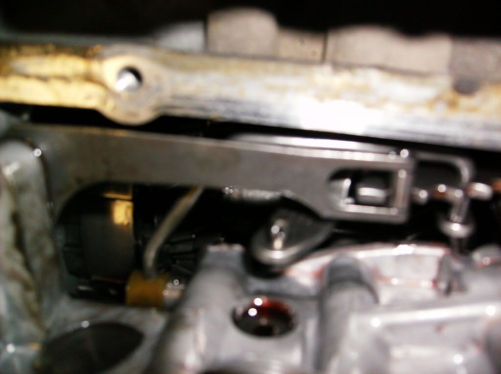

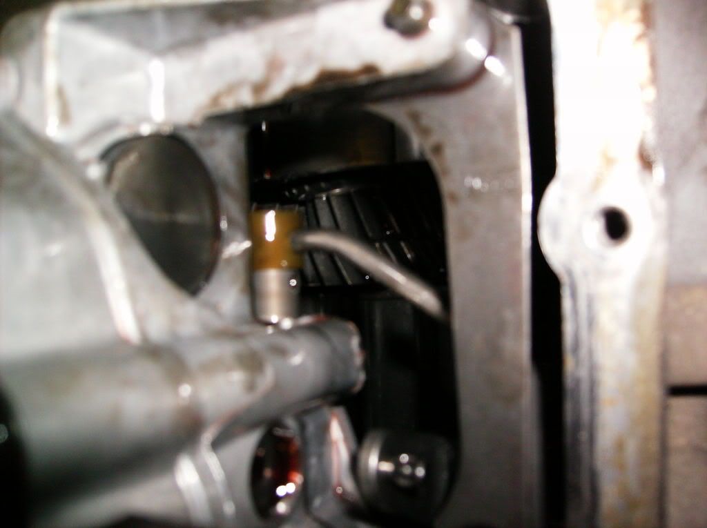

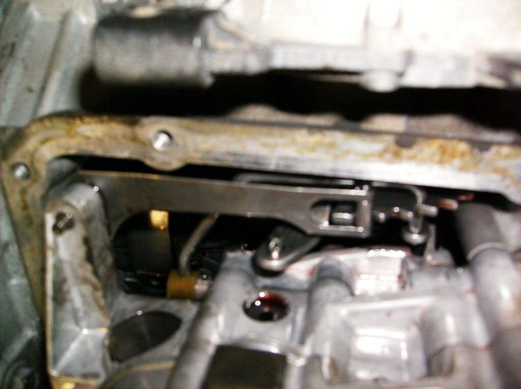

I would also take off the valve body cover. Its just a bunch of 8mm (?) bolts. There is a metal piece that goes from the gear selector to the valve body. If this is not connected then you will have no reverse.

The valve body is located on top of the tranny. No jacks or stands are nessasry. You must remove the air box, battery tray, and the tube from the air box to the throttle body. You will see the valve body cover right underneath. remove the bolts and take it off being careful of the gasket. Once off youll see the valve body. The piece of metal can be seen in these pictures. Make sure yours looks like this :
