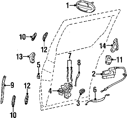

I have found a diagram of what I am taking about. It is the door latch assembly, number 4 in the diagram. Does anybody know if the actuator is part of this? It must have some sort of power to unlatch the latch when opening from pushbutton or remote. It costs roughly $80, and I hope it is easy enough for me to replace. Does anybody have prior experience replacing these?
http://img.photobucket.com/albums/0803/so2315/MT99950.gif
