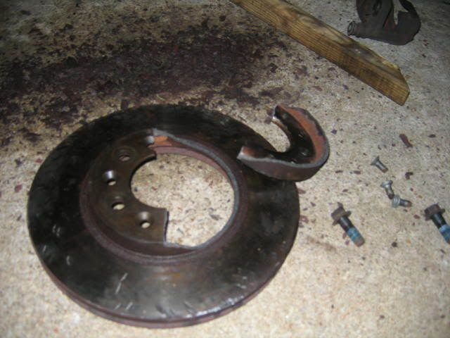

Okay I have finally been able to get them off with PB blaster, heat with quench and sledge hammer.
Should the rotor look like this when I finally get it off? LOL
http://i228.photobucket.com/albums/ee2/SlimJimRD/On%20line%20picture/IMG_0443.jpg
Thanks for the help.
Steve
Steve
northern piper
05-07-2008, 10:21 AM
yep, anti-seize is your friend! Glad it came off. Just as a future reference I tend to head until the part is dull red, then immediately quench. You need enough heat to get the part, when quenched to contract quickly, to contract and break the rust bond. I usually try to heat the part that I'm replacing as the quench will alter the temper of the metal and has potential to make it brittler.
