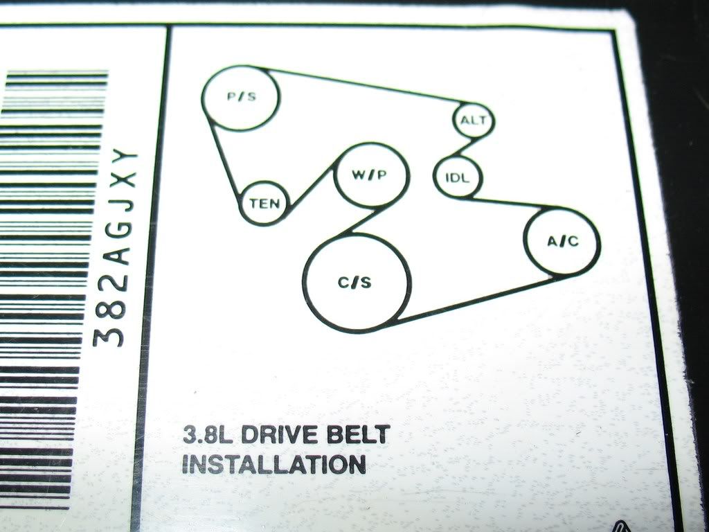

tartersauce
04-02-2008, 08:33 PM
Very quickly.......
In need of belt routing diagram for 2000 Windstar 3.8 ...
My buddy is changing out the water pump and forgot to write it down before tearing everything off.................including the motor mount removal:banghead:
http://i306.photobucket.com/albums/nn278/tartersauce2/IMG_1410New.jpg

nevermind......By the time I foundit on the web....He had figured it out...
He was used to working on Chevy's:grinno:
No sticker under the hood, in the owner's manual or in the Haynes book...
