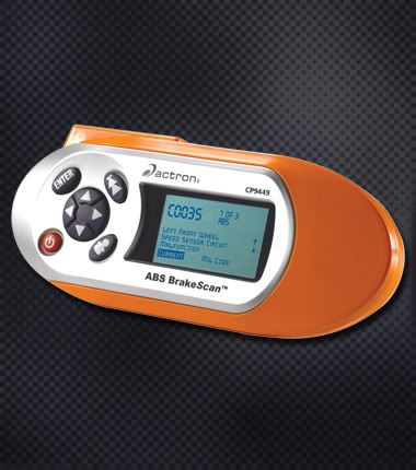

this one: Actron CP9449 ABS BrakeScan Diagnostic Scanner
http://i41.photobucket.com/albums/e274/toughguy5/f25e_1.jpg
got it at a real nice price too.
Piper
