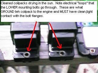

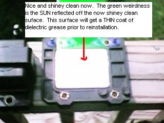

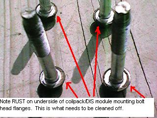

Try cleaning all the contact points on the module. These are important for grounding.
http://www.saturnfans.com/photos/data/500/3528coilpack_loops.JPG
http://www.saturnfans.com/photos/data/500/3528shiney_clean_DIS.JPG
http://www.saturnfans.com/photos/data/500/3528rustyboltheadflanges.JPG
Pictures by Wolfman.
See if that helps :)
