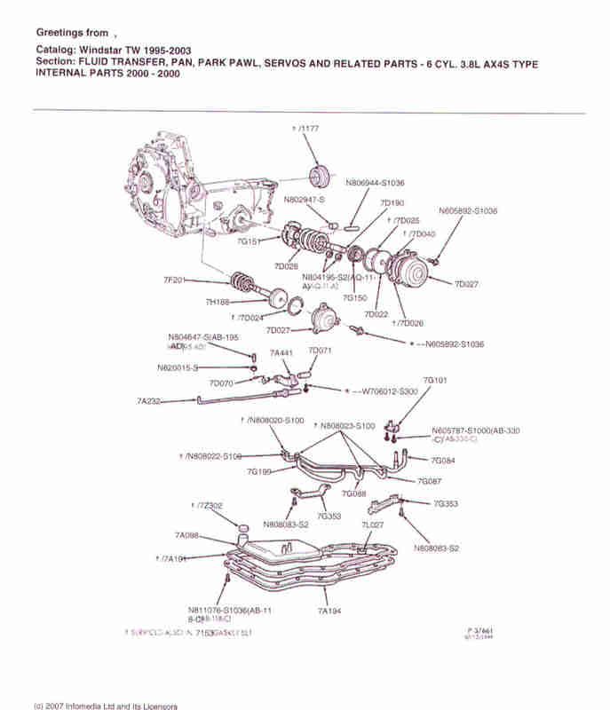

went to rizzo ford, the parts guy could not find what i asked for he did give me this :http://i41.photobucket.com/albums/e274/toughguy5/2000windstartranny.jpg
can you tell me which one is it. thanks.
12Ounce
02-28-2008, 02:54 PM
7D025, o-ring seal. (I believe this is the one that acts as piston ring.)
7D026, gasket
7D040, o-ring seal.
Check the two circlips to make sure they are in place and not fractured. Lube all parts with fresh fluid before reassembly. Have pan in place as you will lose a few ounces of fluid in this procedure.
You may want to remove one end cover screw and loosely replace it with a slightly longer screw ... then the second screw, then the third. This keeps the spring loaded stuff from "taking off"!
Good Luck! Hope it helps.

ok, circled the parts on the paper going back to ford in the morning. once i get the parts and replace them what should i expect from the tranny?
P.S looking at the parts on the sheet what happens if by accident the "spring loaded stuff take off".
how long will this job take? i do 98% work on my van. never worked on the tranny,willing to give it a shot.
thanks for your help.

You'll be looking for parts around the bottom of the car. But there isn't a great deal of spring force on this servo. On the other servo, the one you will not be removing ... there is a concern, almost a danger, it the screws are taken out without precaution.
If your current o-rings are well worn ... new ones will give you a more positive 1st to 2nd shift ... and vice-versa. If your current o-rings are in good shape, you will wonder why I ever mentioned them.
