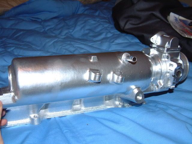

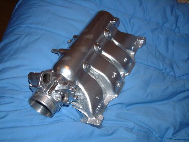

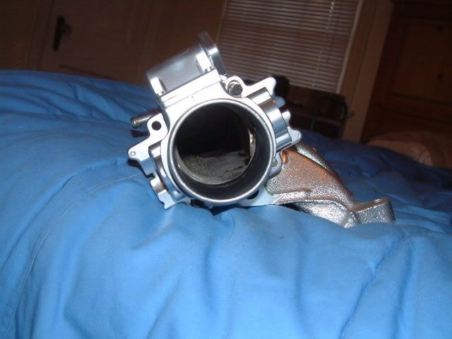

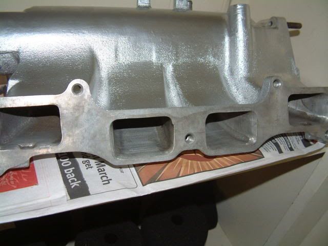

So here is the intake finally finished and painted. Im to lazy to polish out everything to a shine so I just painted everything. I used a chrome/silver paint. The intake manifold was sanded down smooth on the parts you can see. This is probably just a temporary setup, I see how long it last and when it starts to look really bad I will just get the whole thing powdercoated more than likely. The finger prints are just smudges that wipe off.
http://i189.photobucket.com/albums/z173/SilvrEclipse/DSCF2505.jpg?t=1206654628
http://i189.photobucket.com/albums/z173/SilvrEclipse/DSCF2506.jpg?t=1206654917
The huge 60mm throttle body
http://i189.photobucket.com/albums/z173/SilvrEclipse/DSCF2507.jpg?t=1206654941

vanilla gorilla
03-27-2008, 06:00 PM
what brand paint is that? I used Krylon chrome and its doo doo. But I used this stuff from DG, its Miracal brand, a dollar a can and its aluminum color, it blings pretty well.
david-b
03-27-2008, 06:47 PM
Looks nice
gthompson97
03-27-2008, 09:59 PM
That looks like DupliColor Aluminum spray paint.
SilvrEclipse
03-27-2008, 10:50 PM
Duplicolor high heat ceramic. It was just a silver color but came out kinda shiny.

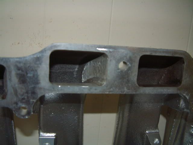

Damn son, nice job. Can you take a picture of the port matching you did on your intake manny?
SilvrEclipse
03-28-2008, 08:39 AM
Yea I can get some more but I wont be able to get them up till Sunday. I got school right now and then meet up with Dave right after that. Do you want them of the porting at the TB?

wrightz28
03-28-2008, 09:11 AM
Although it looks great already for a rattle can, a little wet sanding might make it pop a bit? :dunno:
Nice job none the less. I did the same on my air cleaner assembly in my AMC, mostly 'cause the then 30 some odd year old paint looked dog poo on stick, and dirt would just cling to it.
SilvrEclipse
03-28-2008, 11:05 AM
Have you ever tried wetsanding spray paint. I tried it once on some grey paint and it f*ed it all up. I dont think it would work, but may be worth a try. I might just paint some random metal and test out the wet sanding. I dont want to mess with the manifold unless I know it will work.

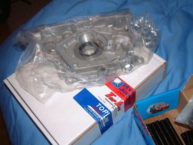

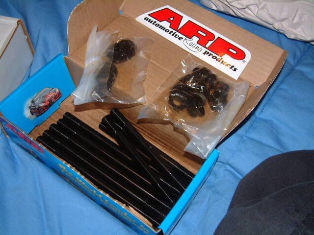

SilvrEclipse
04-01-2008, 12:40 PM

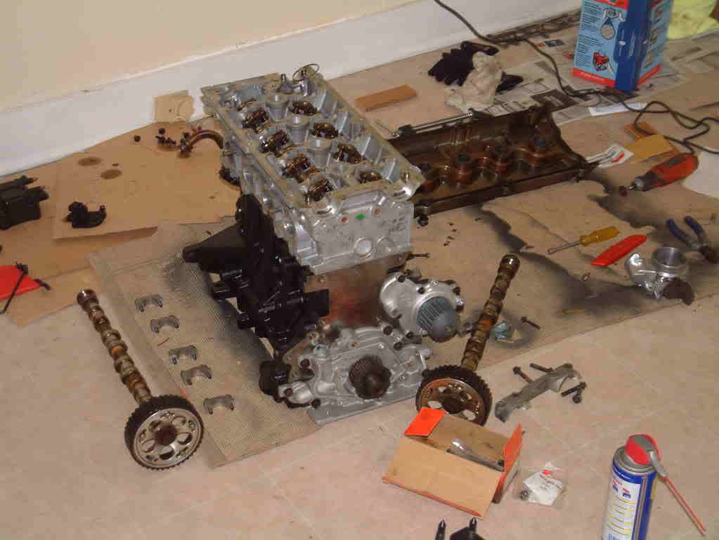

Here is a pic of the ARP heatstuds and the new oil pump. Timing belt should be in this week too. This weekend Im planning on tearing the oil pump and crank off the used block. Maybe I can get it sandblasted this weekend also. I will have to check on that. Then maybe in the next two weeks I can get the block and crank to the machine shop. I only need a few more parts, most of them will be ordered in the next week or so. These are the parts I still need.
-Hydrolic tentioner
-Timing belt pulleys
-Waterpump
-Rod/Main bearings
The start up date is July first but things are looking good from this point so the motor should be finished a few weeks early.
Megasquirt will hopefully be ordered in the next 2-3 weeks. I will have to assemble the kit so this will take time and then I will just have to wire it in to the car.
Here are some more pics.

Yes. I must say that the overall outcome depends on the quality of paint used. AND, it is a learn by practice process. But I've bought "junk" fenders of different color from the car I'm working and much success with it, and nobody knew it was from a can. I'll check and see if I have any pics on this drive or not.

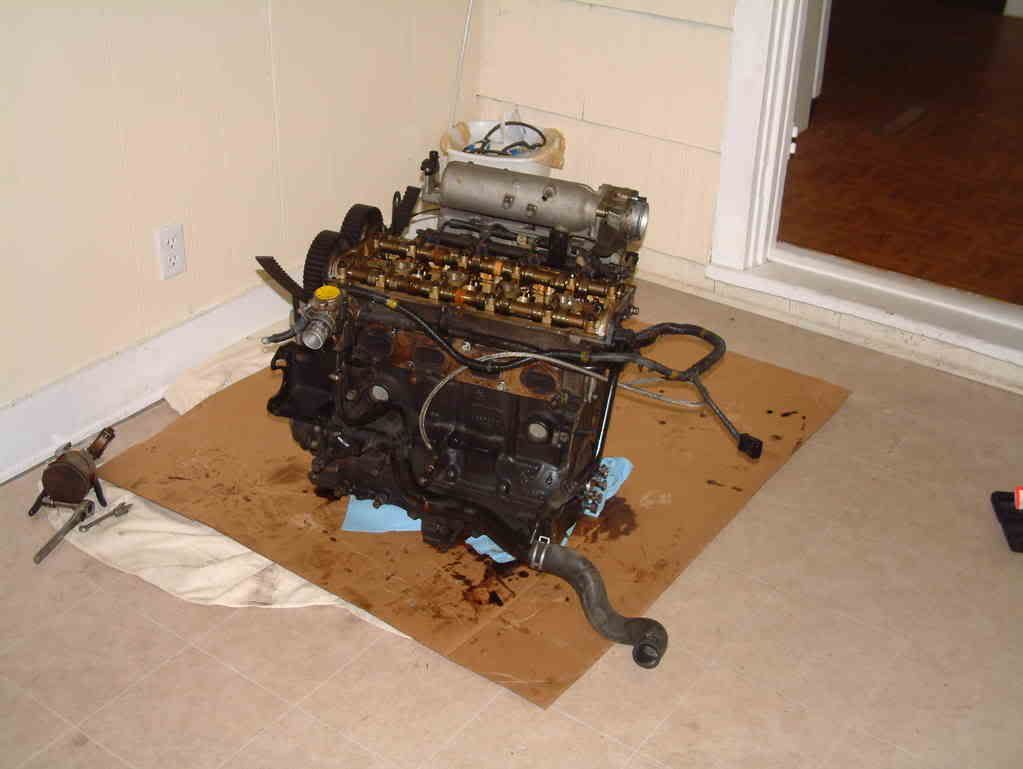

SilvrEclipse
04-06-2008, 03:06 PM

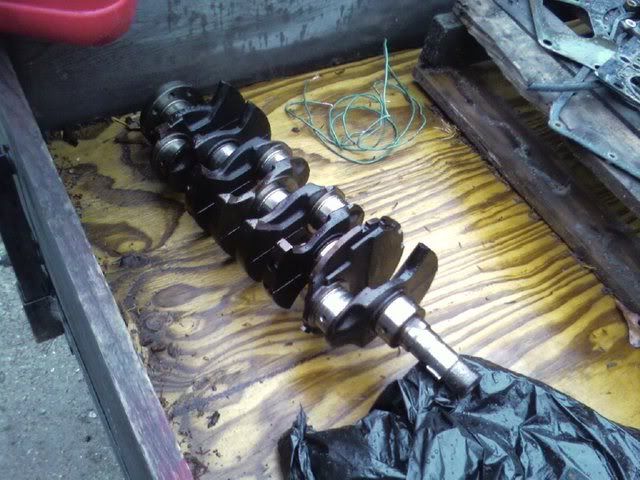

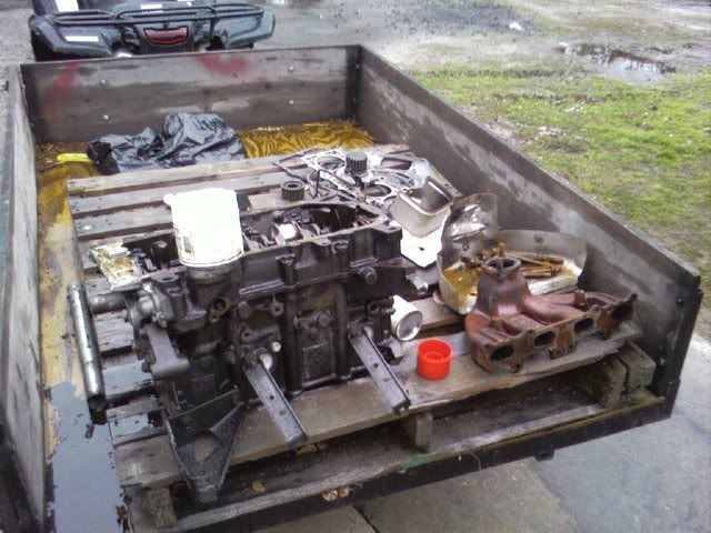

This weekend went pretty good. Got most everything done that I needed to. Saturday I went to my buddies house to work on the motor some more. Got everything off the block and the crank out. Didn't get the block cleaned up any, I am just going to let the shop bead blast it to clean it up some. My dad will be taking everything to the shop this week and then it will be ready for assembly. Timing belt also came in on Friday. I need to find out how much the machine shop is going to charge me before I order the rest of the parts. Here are some pics from this weekend. It rained pretty much all weekend, today turned out to be nice but we had to tear this thing apart in the rain.

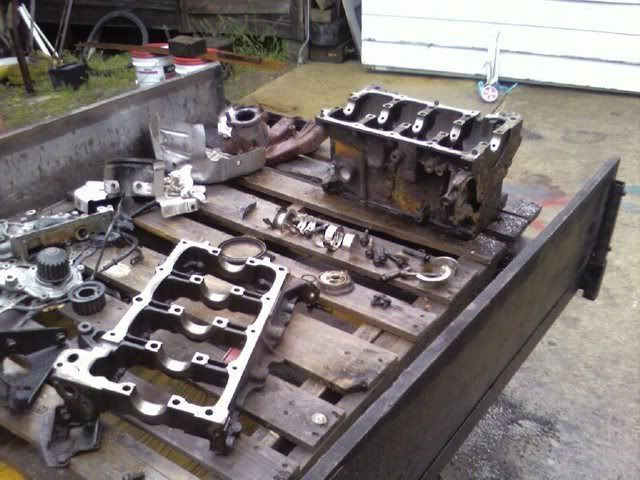

SilvrEclipse
04-13-2008, 09:04 PM
The block was taken to the machine shop on Friday to get bead blaster, bored 0.020, cleaned. The crank will also get machined. The guy said he wont be able to work on it till the end of next week so it maybe 2 weeks before its done. Its fine though cause Im so busy with school for the next 3 weeks I wont have a chance to even go see the block. My dad is picking it up for me.
Im selling emanage probably next week to help pay for the machine work and the rest of the parts. I should be started assembling by the 2nd week in May. Motor will hopefully be done a month ahead of schedule. First part of June it should be in the car and running. For more bad news the clutch has now gotten screwed up to. Oil has leaked past the rear main seal and leaked oil all over my fairly new stg 2 clutch. Thats not big deal though, I will just have the kevlar facing changed on it when we pull the motor.
Im going to sell the block and head and spend that money on Megasquirt, I will need a 1:1 FPR and 750/850 injectors. I will still be running the 14b for a while, but in a few months I hope to get a E316g.
Thats pretty much the plan for this summer, we will see how everything goes...

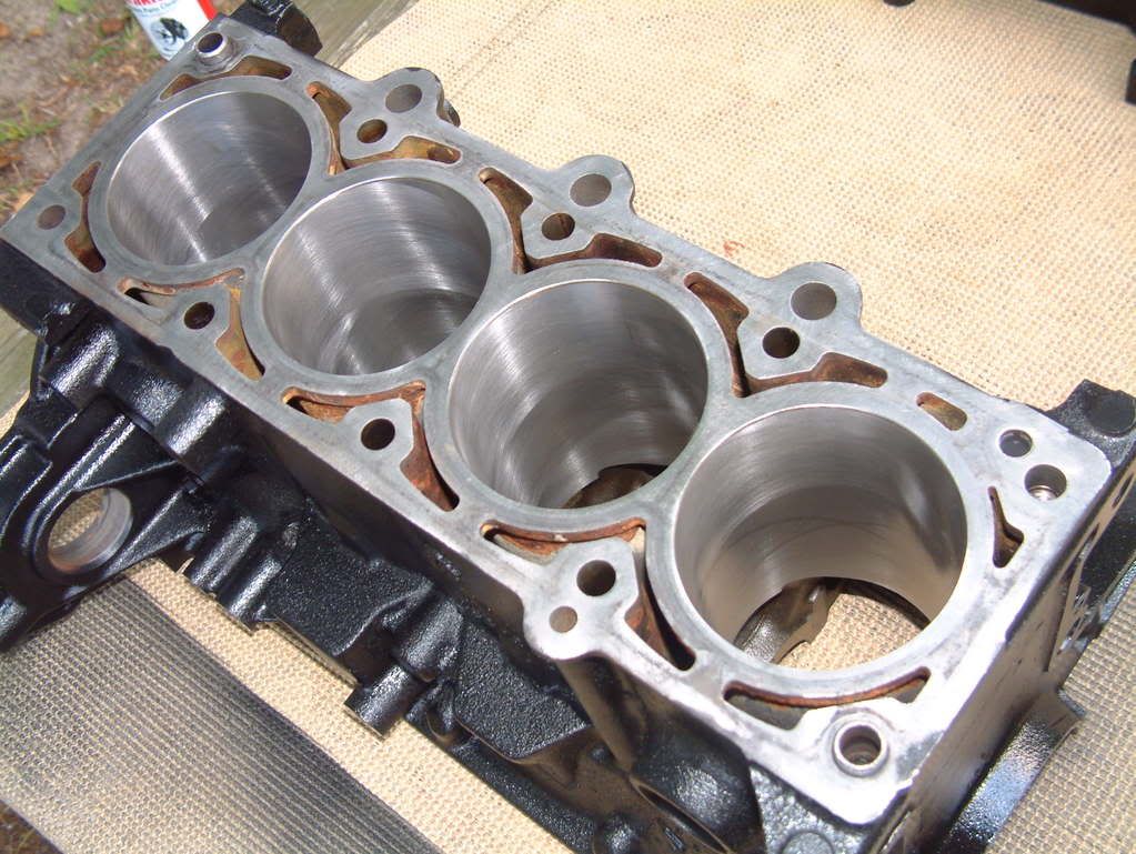

Ok so its time for an update. My dad picked up my block from the machine shop this morning. They have been busy lately so it took them about 2 weeks to get it done. Not a big deal though since I had no use for it anyways. The block was bored .020, the crank was reground .010, and the block was bead blasted. Everything totalled up to around $170 which isin't to bad IMO. I had them order me a set of main and rod bearing also which will be here beginning of next week.
My last exam is monday and I plan on going home wednesday to start assembling the motor. As some of you may know I have been looking for an internship this summer and finally found one with the army corps of engineers. I still have to finish filling out the paper work and all that shit. So depending on when I have to start will determine how much time I have to put the motor together and get it in the car.
Pics will be up next week.

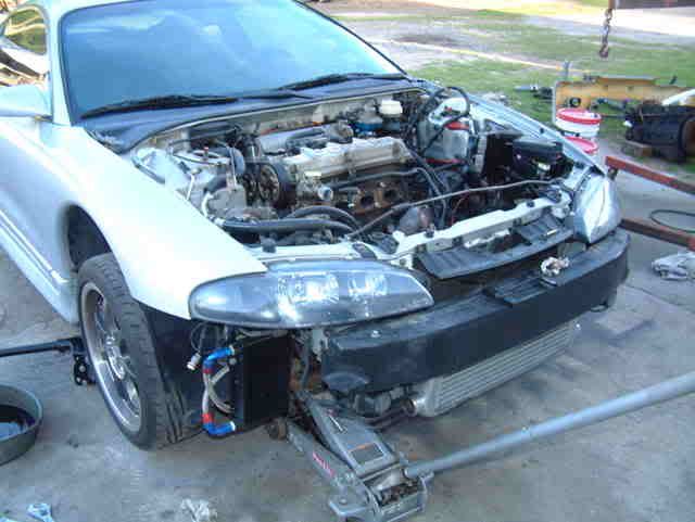

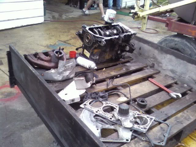

05-08-2008, 06:59 PM

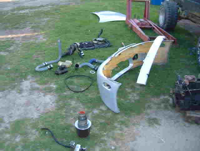

Ok guys I got a nice update. Exams are finally done and I made it back home. Things are finally starting to come together. Today I got the block painted and the bearings are coming in tomorrow. And saturday Im taking everything to my friends house on saturday and we are going to gap the rings. I start my new job on Monday back in Columbia so the block is going with me and Im going to plastigage all the bearing and put together what I can.
Next weekend THE MOTOR IS COMING OUT! Next friday I will start pulling the motor out and hopefully by Saturday it will be completely out. Im using a lot of the bolts and some parts of the head on the new motor so that whole next week I will be swaping parts and getting the more ready to drop in. Then the next weekend the motor will be going back in and will be fired up hopefully on Saturday the 24th.
Here are some pics of the progress today. There should be more uploaded every couple days as I do more work on it.

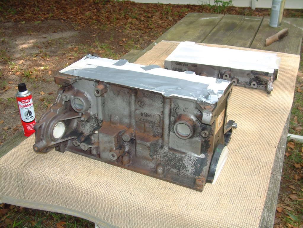

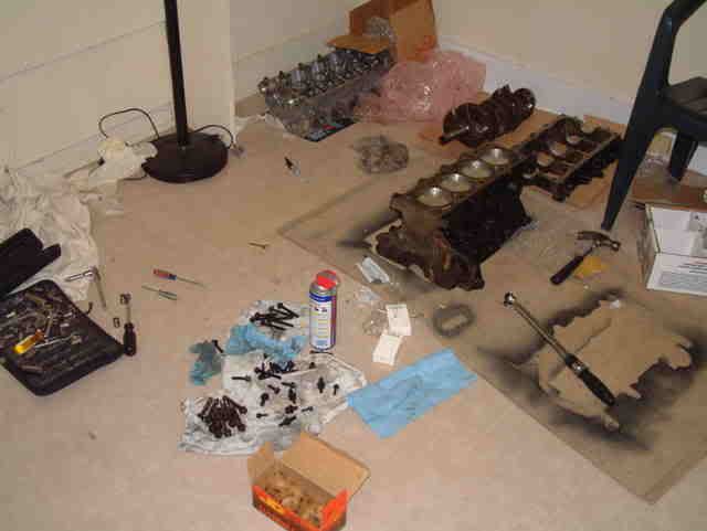

SilvrEclipse

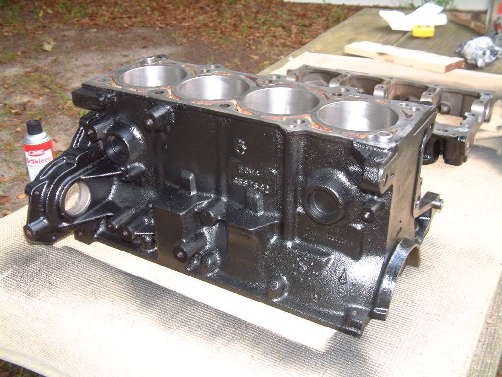

05-11-2008, 09:24 AM

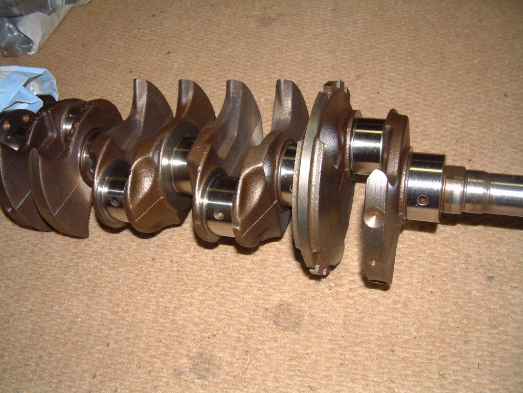

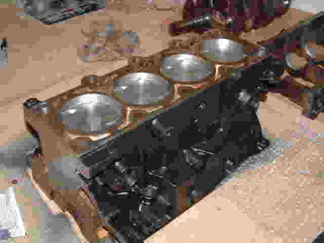

Just a little update. Yesterday I got the rings gapped.
Top ring - .022
Middle ring - .020
Oil ring - .022
the bearings finally came in and were picked up on Saturday. I also borrowed a ring compression from someone so this week I will plastigage all the bearings and assemble the bottom end. The only parts I still need are: waterpump, hydrolic tensioner, and idler and tensioner pulleys for the timing belt. All of these parts can be got from advance so thats no big deal. Im going to pick those up sometime this week also. Everything is still going smooth so far and on schedule for the drop in date.
Top ring - .022
Middle ring - .020
Oil ring - .022

Thor06
05-11-2008, 11:05 AM
Ahhhhhh, open deck! ;)
What is that flat guy next to the block on the mat?
vanilla gorilla
05-11-2008, 11:07 AM
I'm guessing its the bottom of the block
SilvrEclipse
05-11-2008, 11:28 AM
What??
The flat piece of metal that got painted also?? Yea its the bottom of the block. The 420a block splits at the bottom and the crank goes in between them. You should be able to see the main bearing journals it.
What??

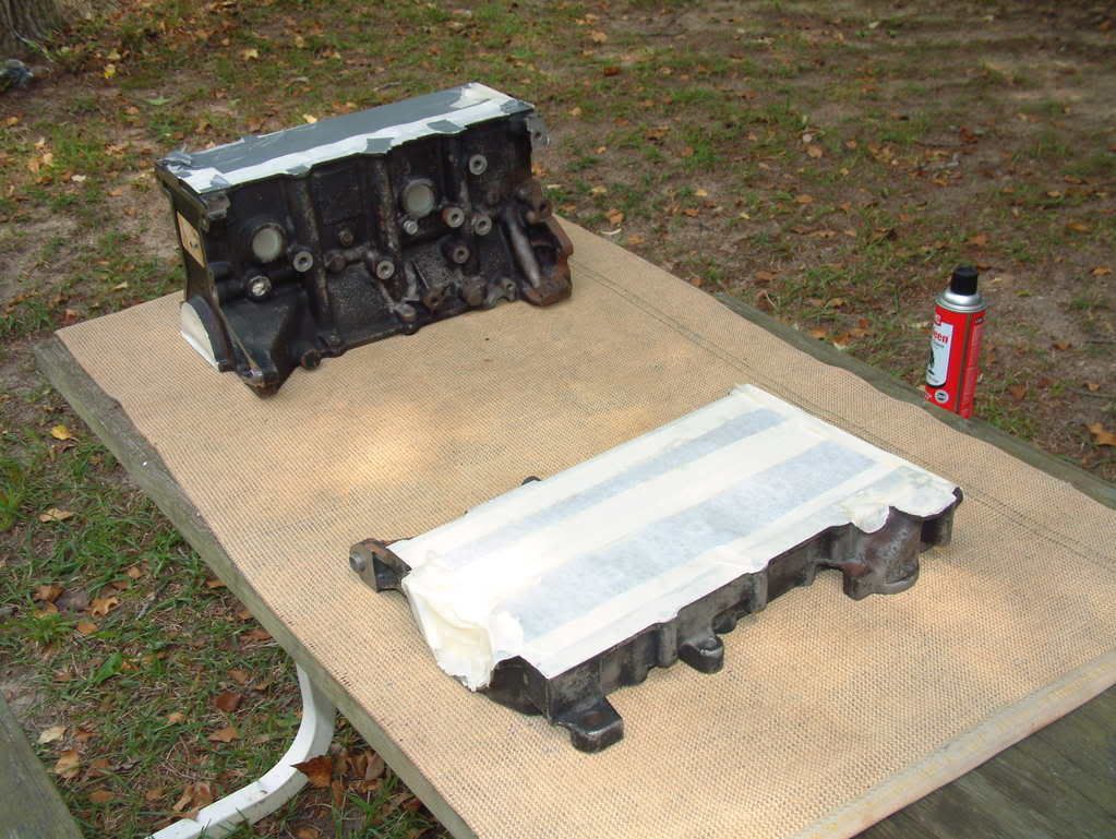

Thor06
05-11-2008, 11:38 AM
Uhhh, I'm talking about the only other piece of metal on the mat there Jason, process of elimination should help you out a ton. ;)
I have to admit I think thats kinda gay, but also kinda sweet. I would imagine that would give superior support to the crank, but I also see it as one more spot that could leak, etc.
david-b
05-11-2008, 02:13 PM
Uhhh, I'm talking about the only other piece of metal on the mat there Jason, process of elimination should help you out a ton. ;).
:rofl: I just laughed for a good 5 minutes Thor. :rofl:
And yes it leaks. Mine leaks in the back where the 2 come together.
gthompson97
05-11-2008, 02:20 PM
It's the crank cradle/bridge. You're supposed to seal it up when you assemble it so it doesn't leak. I didn't have any problems with that part leaking on any of my motors so just seal it and you should be fine.
MazdaX
05-11-2008, 11:41 PM
On the 420A it's nearly impossible for the main cap to leak. It is so flat and it has a cross thatching type pattern to lock the metal under pressure and the torquing of the bolts.

Ok guys I got a lot of work done on the motor last night. I started off by measuring the bearing clearences on the main journels with plastigage. They were all in spec so thats good. I would have gone ahead and put the crank in for good but I didn't have any sealant for the bedplate so I will just finish that tomorrow maybe. I installed the pistons and rods already so when I put the crank in I can measure the rod bearings and then I will be done for the most part.
The last pic is just a random one of my new cat.
http://i189.photobucket.com/albums/z173/SilvrEclipse/DSCF2565.jpg?t=1210714646
http://i189.photobucket.com/albums/z173/SilvrEclipse/DSCF2566.jpg?t=1210714695
http://i189.photobucket.com/albums/z173/SilvrEclipse/DSCF2567.jpg?t=1210714722

Anyways the motor is fully assembled now. Crank is in and rod bearings have been measured and installed. The head is on also along with the oil pump and water pump. The blown motor will be pulled tomorrow and the new one is going in next weekend. New pics will be up on Sunday and we will finally know how much damage has been done.
O yea and the car still runs fine. After 2.5 months of driving on a blown motor the 420a is still alive.

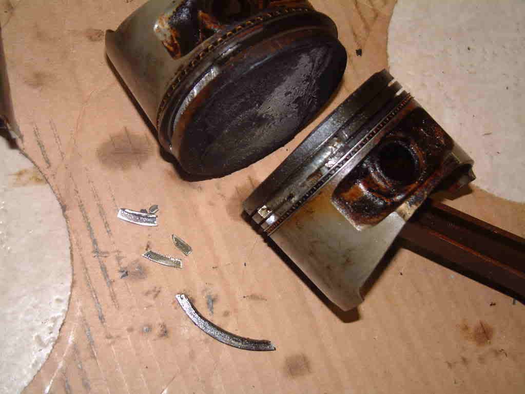

Ok guys the motor is out. It took about 8 hours to get it out. Found a few things that I didn't expect to... The exhaust had a nice big crack in it. That got welded up yesterday and braced. The clutch is bad for sure. Bottom of the intercooler was full of oil. And when I pulled the motor apart last night I found 2 cracked pistons. Im about to go to work right now so I will have pics up tonight maybe.
SilvrEclipse
05-21-2008, 11:05 AM
Ok dont have much free time now but I will post up some pics or the motor coming out. I got most of the new one assembled and those pics will be up later. Sorry for the pic quality.. photobucket is blurring all my pics when I resize them. Im not resizing them anymore so some of them may be big.

This is the damage that was done to piston number 2 and 4. The worst one is from cylinder 4.

vanilla gorilla
05-21-2008, 11:10 AM
Whoa, thats pretty crucial
steviek
05-21-2008, 11:43 AM
wow and it was still sorta running?
SilvrEclipse
05-21-2008, 04:15 PM
The car actually ran good, it just smoked a good bit. The idle was smooth, sometimes it would have trouble starting or just randomly cut off but it ran ok for about 2.5 months.

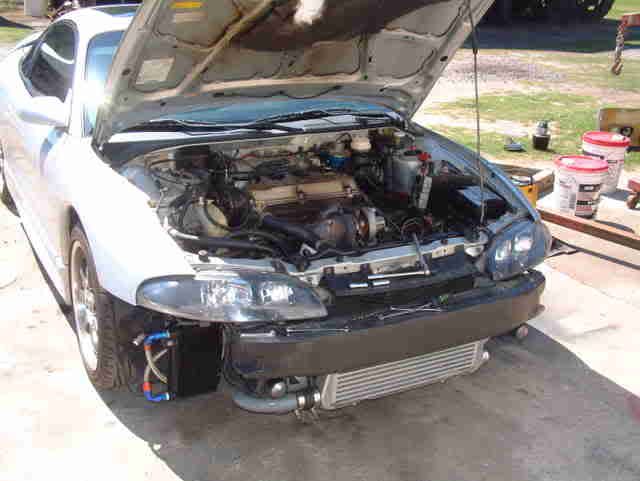

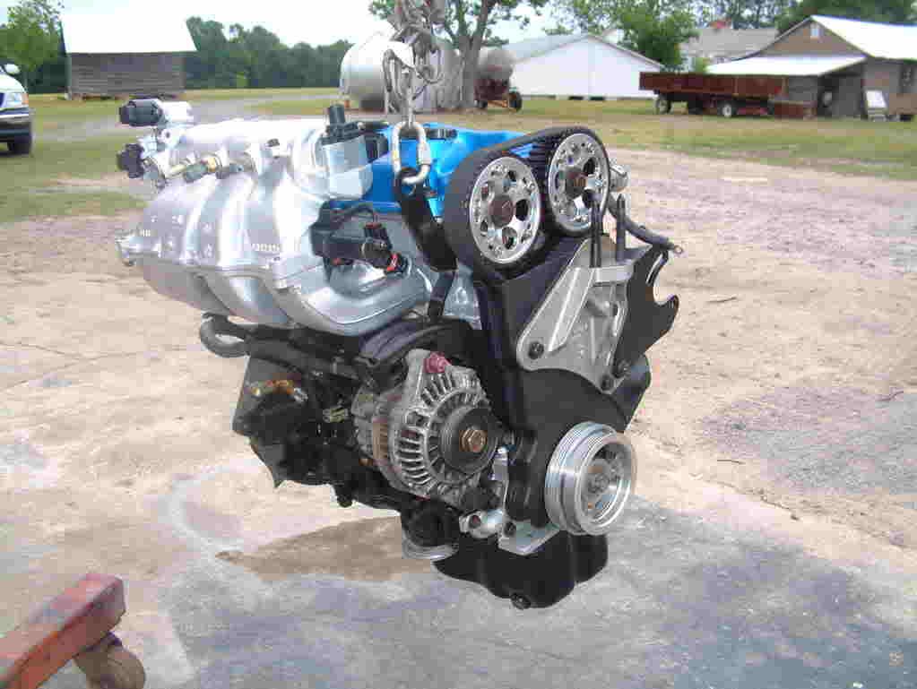

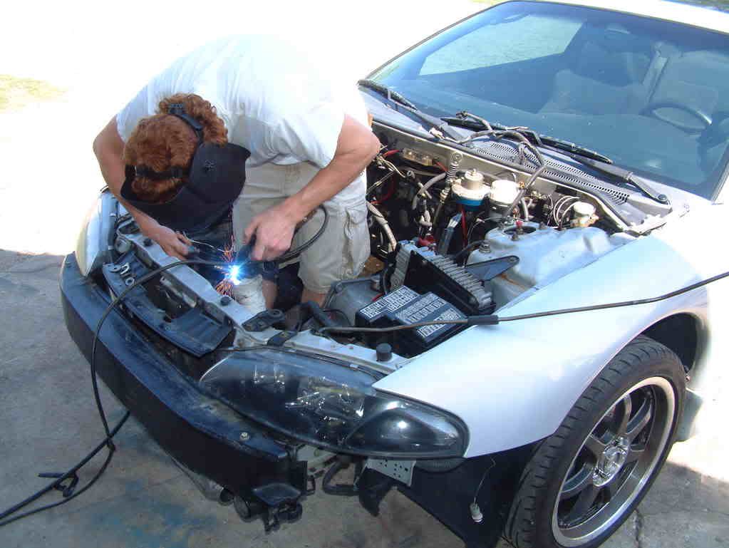

Ok some more pics of the motor. I got the cams in last night, ran in to some problems when 2 bolts snapped off inside the head. Finally got those out and replaced them with some from the other motor. So the head is done and only needs the valve cover bolted on. The intake manifold will be put on tonight. I got my jeep TB built and it seems to be working perfect. Going to try and install all the sensors, wiring harness, alternator, and the water pipes tonight. I only have tonight and tmrw to finish this motor and then Friday I pack up right after work and go to put it in. I may have to pull a late night tmrw to finish everything but it will get done.
The car should be running Saturday evening sometime. Sunday it will get driven around and broken in some. This is the plan so far. Hopefully everything will work out that way. I will keep everyone up to date...
My friend welding the exhaust back together.
http://i189.photobucket.com/albums/z173/SilvrEclipse/DSCF2594.jpg?t=1211406305
This SOB was heavy as hell. It took so long to move it from the truck into the house. It was only me and 1 more guy and it was covered in oil.
http://i189.photobucket.com/albums/z173/SilvrEclipse/DSCF2595.jpg?t=1211406354
http://i189.photobucket.com/albums/z173/SilvrEclipse/DSCF2607.jpg?t=1211406421
http://i189.photobucket.com/albums/z173/SilvrEclipse/DSCF2614.jpg?t=1211406444
http://i189.photobucket.com/albums/z173/SilvrEclipse/DSCF2613.jpg?t=1211406669
Valve cover was just painted yesterday, the letters will get polished out once I get the motor in and running, then I may clear the whole thing. I haven't decided yet. It looks nice right now though. I hope the motor can stay somewhat clean.
http://i189.photobucket.com/albums/z173/SilvrEclipse/DSCF2612.jpg?t=1211406506

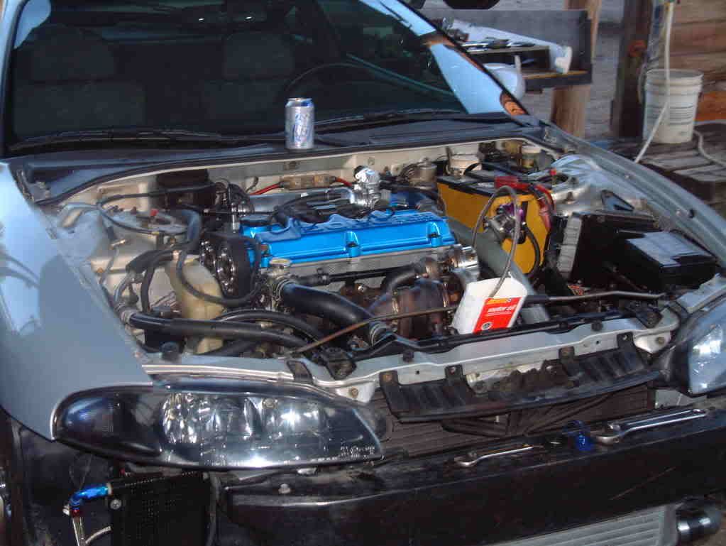

Intake manifold in installed and TB. Cam,crank,knock,map sensors are installed. Oil feed for the turbo is on. Alternator is on. Tomorrow is the last night I have to work on it and still have to repaint the heater hose tubes and install, clean the thermostat housings and install them, and just a few other things. It should be almost ready to install on Saturday. I got a new disc for my clutch, new TOB also.
The only thing I am worried about is this motor spinning a bearing. I platigaged all the bearings and they were in spec but I hear about so many new motors spinning rod bearings.

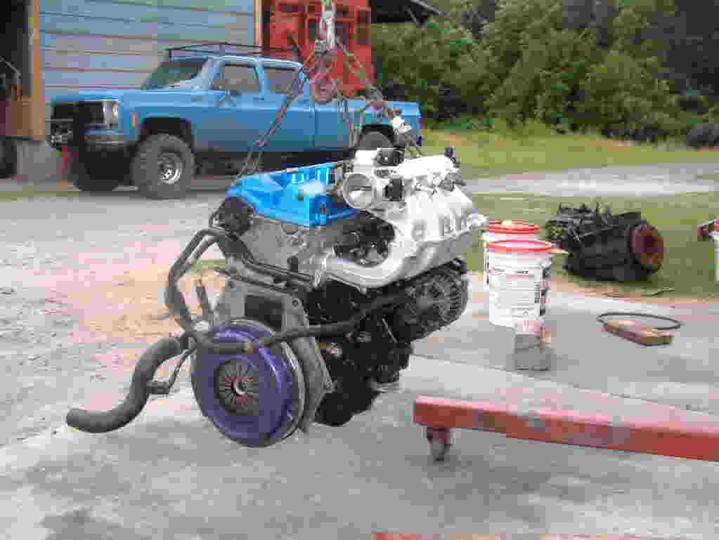

Friday night I got the motor ready to drop in, set the timing, installed the clutch and all that good stuff. Saturday about 1 we started to put it in the car, didn't take as long as expected and by about 8 that night the motor got to run. It started right up and was a little ruff but we lowered the fuel pressure for the bigger injectors and it smoothed out. Let the car run for about 30 min and shut it off to let it cool back down.
Sunday I pulled the spring from the wastegate so the turbo wouldn't boost and did some WOT pulls in 3rd to seat the rings. Changed the oil after that and it appeared to have some metal flake in it along with something else. I cant tell if it was coolant or gas. I was thinking that maybe when I primed the motor some gas leaked down the cylinders since I didn't unplug the injectors and it may have even leaked some when it was running. I am just going to run it for a couple hundred miles and see if it stops. I will just have to keep and eye on it to make sure it stays lubricating.
The car likes to idle surge bad sometimes and it idles about 950rpms which is higher than it use to. I think I am going to adjust the IAC sensor some today and see if thats the problem.
The turbo also seems to be completely f*ed. Just letting the car idle with no air filter had oil dripping from the inlet of the compressor housing. So that needs to be fixed soon.
So there are a few problems but nothing that cant be fixed relatively easy. worst comes to worse and I have to change the head gasket which isin't that big of a deal. Car has about 50miles on it right now and is still running strong.

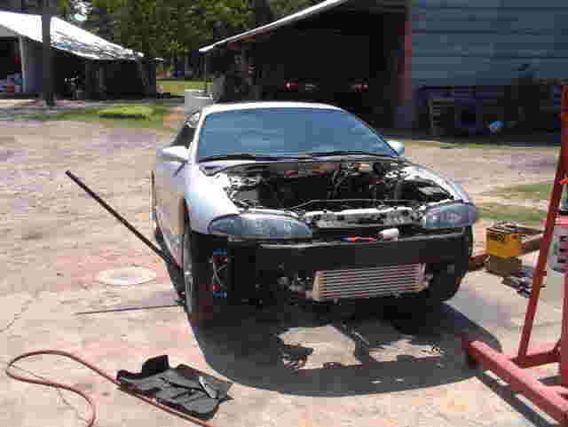

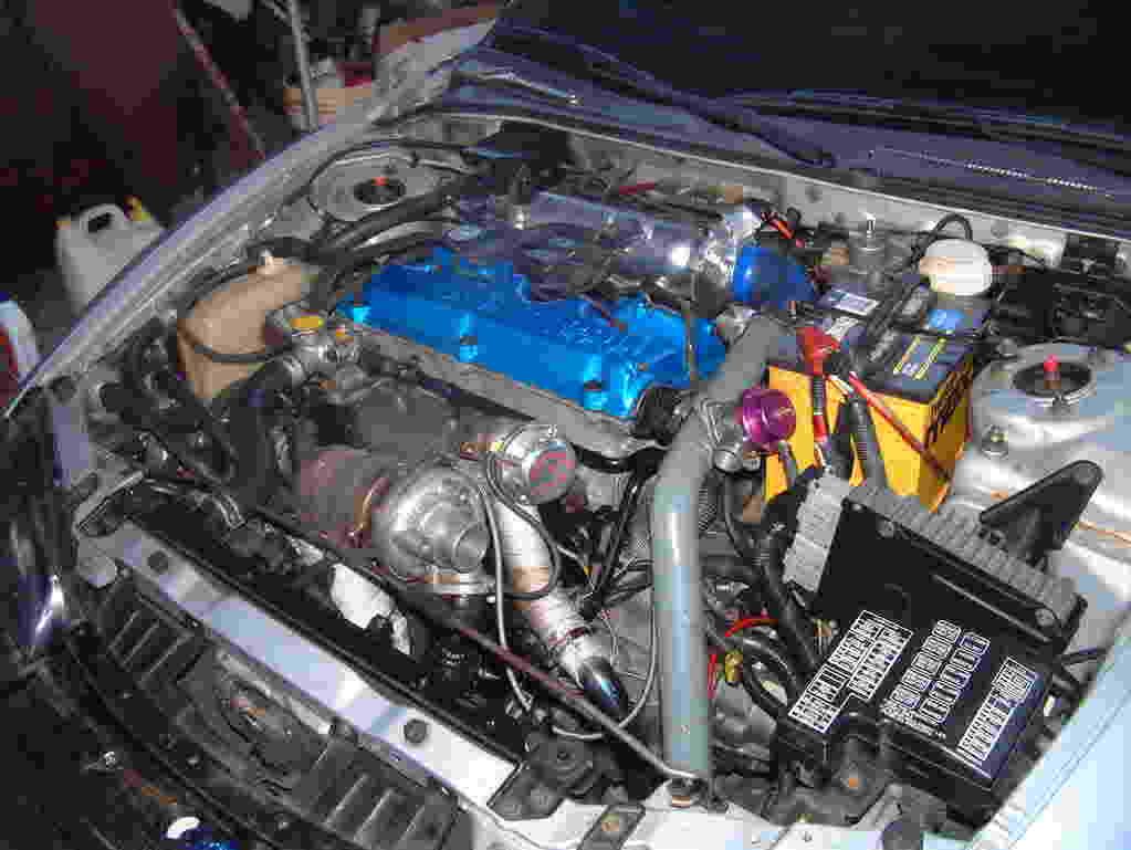

Ok guys, I have been meaning to update this thread for a while now. Just started summer school last week and have 0 free time.
The new motor has 500 miles on it and still seems to be running fine. There are a few problems that need to be worked out and hopefully everything will be done soon.
The car has a bad idle surge when rolling. Changed the IAC and it helped for a week but it started back tonight. Its that damn jeep TB on it. I think the headgasket didn't seat and is still leaking. I saw tonight where it looks like some coolant has seept out the radiator cap. The oil pressure has always been low. Sometimes idling at 10psi. Im going to try and shim the spring to bump it up some.
The turbo does not seem to be leaking out the seals anymore. Which is a good thing. Need to change the oil and reinstall oil cooler. Also need to bleed the clutch tmrw.
I ordered megasquirt so it should be here this week. Hopefully it will be installed in the next 2 weeks. The car doesn't run very well right now so maybe this will help.
I tried to put pics up but photobucket blurrys them up for some reason and they look like shit.

Ok here are some pics. I cant seem to get photobucket to not blur the pics. Or maybe its just my internet. Anyways here are a few...
