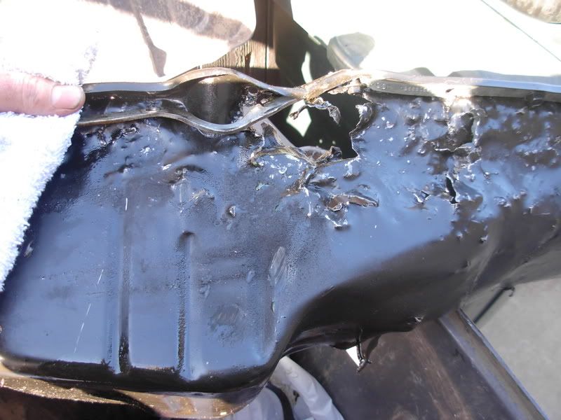

02-01-2008, 09:51 AM
Almost ruin my day? Ah Hahaha weeks later I was still paying to get it home. :banghead:
Everything is balanced and blue printed this time. :wink:
I hate it when those rods come out like this....:disappoin
http://i33.photobucket.com/albums/d75/trixxr/DSCN0553.jpg
6 PSI on a stock motor is not a good thing. Check parts for sale for a great deal on a Polished Powerdyne supercharger!
http://www.automotiveforums.com/vbulletin/showthread.php?t=886203
Look at cylinder #2 rod journal. Hard to tell where the crank starts and rod journals ends. lol :shakehead
http://i33.photobucket.com/albums/d75/trixxr/DSCN0555.jpg
Blue Bowtie
02-01-2008, 10:03 PM
All I can see is the #4 bore - The #2 seems to be cut off from the photo. At least it only scored it a little... ;)
Meh, a good crank grinder should be able to dust that off in no time.
A little J-B weld will fix it.
Maybe some SeaFoam in the oil would be good.
Actually, that looks pretty good for a ... Oh, wait, that's NOT a Honda.
I could keep going.
Anyway, where the rods fragged and punched through looks dangerously close to the pan rail Were you able to save the block, or not risk it?
