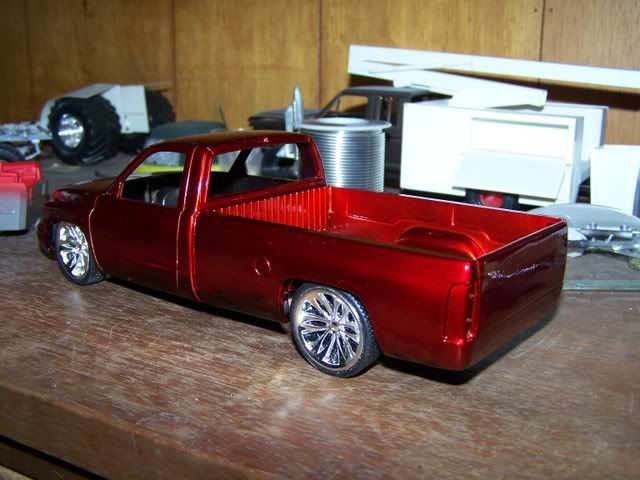

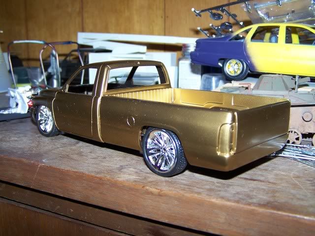

Ok I do a lot of paint jobs I don't know why this one is hard for me but this is the two ways I could do the job you all let me know if you think I'm on the right track.
Ok My paint job styles. I can paint the mane car that will be the red one.
1. You can paint the body Met. Gold base, Let dry then mask the flam images off and paint a clear candy red over the Met. Gold base pull off the mask, let dry all of it dry. Re mask the edge of the flam and put your airbrush on fine setting and paint around the edge of the mask with clear Orange and then a Clear cot over it as your last step pull off the las mask and that is it for that way.
2. You can paint the body witha Met. Gold base let dry., Next paint over the Met Gold wht clear candy red Let dry. Mask the flam images on the now dry Cl.red.
Paint the Met Gold over the red let dry and re mask only the edge of the flam paint around the edges of the new masked places with Cl. Orange pull off and put on a Clear cot over it.
So you all tell me what you think.
Oh and as for the Stolin car from the move it was just painted a solid Gold color and that will be the first one I do.
Here's the Red I want to use over the Met gold base on the Red vette.
This is a project that I used the same paint job tha I will use on my vettes.
Gold Base:
http://i162.photobucket.com/albums/t248/White_r34/WIPs%20Car%20and%20Truck%20types/CustomDodge_Project6.jpg
Clear Tamiya Red over the Gold Base:
http://i162.photobucket.com/albums/t248/White_r34/WIPs%20Car%20and%20Truck%20types/CustomDodge_Project13.jpg

prortiz80
03-30-2008, 12:03 AM
I love the clear red over the gold....... thank you i didnt think of that thats the right color i was looking for.......... better than any other other i seen
