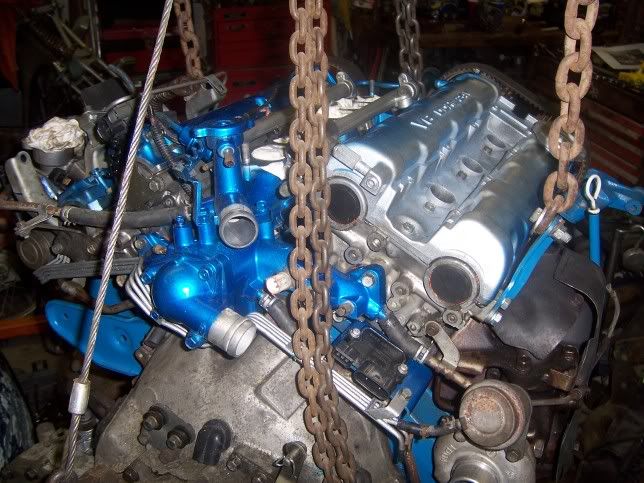

Well so far these are the things I've bought:
SAFC - $180.00
EGT Gauge- $90.00 (plus shipping)
Boost Gauge- $10.00 (plus shipping)
HDI EBC- $145.00 (plus shipping & ins)
1993 TT Engine - 4 bolt main
7,XXX miles after rebuild
- New Pistons & rings
- '99 Lifters
- New Rods
- Reground crank shaft
- New Rod Bearings
- 3SX Performance Light Weight Crank Pulley(not an underdrive, but 6lbs lighter than stock)
- All Gatorback belts
- New Timing belt
- Accel 8mm Wires
- New Spark Plugs
- 3SX Solid Motor mounts
- New Oil Pump
- New Water pump
- all gaskets replaced
- Starter & Alternator
$2500.00
http://i27.photobucket.com/albums/c164/jace16mx/myCar/100_0099.jpg
I pick up the engine Saturday and the rest is on the way :D
