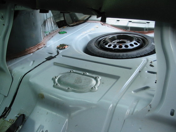

BNaylor
08-25-2007, 12:49 PM
Last time I checked most if not all Impala LS models have the rear seat pass through option with an access door/panel at the rear seatback so removal of the rear seating is not necessary to remove the fuel pump assembly. See example pics below.
http://i5.photobucket.com/albums/y186/lizzywiz/fuelpump_top.jpg
http://i5.photobucket.com/albums/y186/lizzywiz/fpaccess.jpg
For base models without the option here is a pic with the rear seat removed.
http://www.supermotors.net/getfile/555013/fullsize/trunk-carpet-and-rear-seat-out.jpg

INF3RN0666
08-25-2007, 12:53 PM
Ok yeah that's true, but not through the trunk... I have the police package.. So my seats are all vinyl and they don't flap down.
