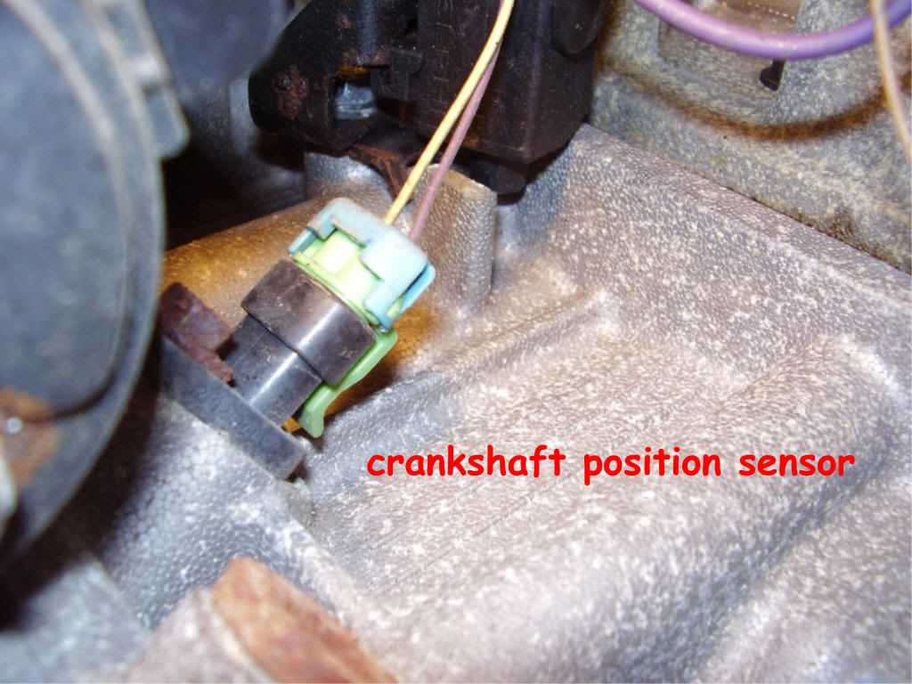

Sounds like the crank position sensor ( CPS ) reasonably priced and not too difficult to replace. When replacing, make sure it seats fully and the retaining bolt is used.
richpin4real
05-04-2007, 06:42 PM
I second that.... sounds like the CPS alright.
http://i202.photobucket.com/albums/aa293/richpin06a/Crankshaftpositionsensor.jpg
