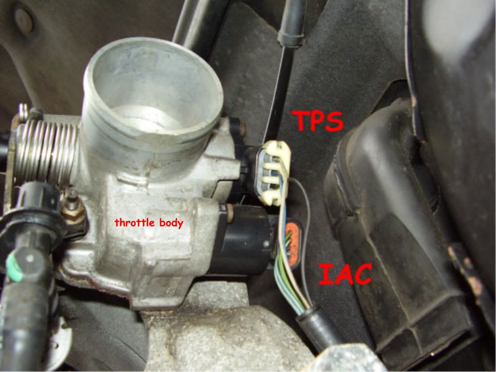

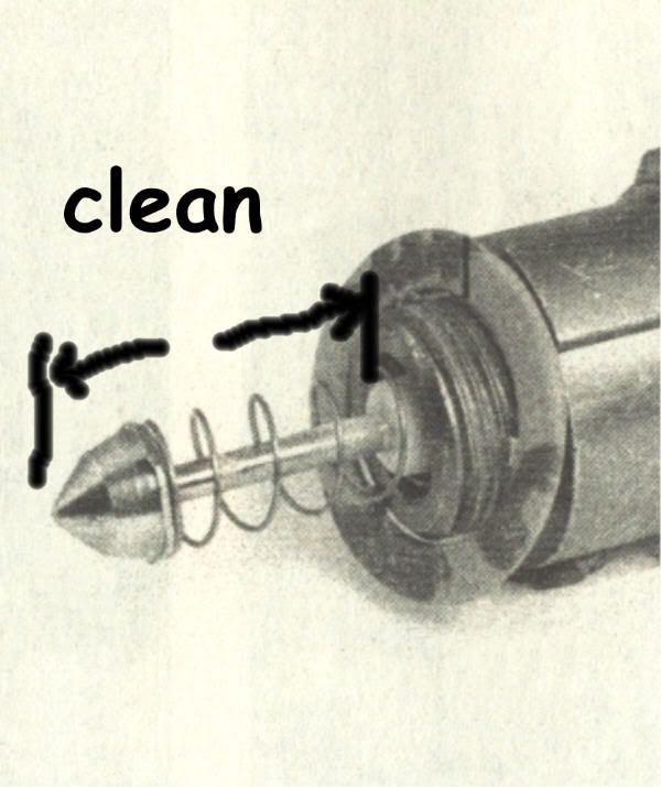

The best way to fix it would be to take the throttle body off first.Then remove the idle air control valve and clean it and the throttle body.Most people use carburetor cleaner but i have had good luck with lacquer thinner.
http://i202.photobucket.com/albums/aa293/richpin06a/iaclocation.jpg
http://i202.photobucket.com/albums/aa293/richpin06a/IACclean.jpg
