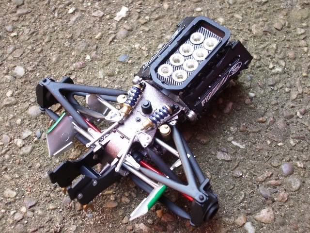

It's been a while since I last updated.I've been quite busy of late on other things and didn't have much time for modelling,so it took a back seat for a while.To be honest I've not progressed a lot further on the build,but I have made a little progress.I had quite a headache trying to paint the Ford logos onto the engine covers.I tried all sorts of methods,masking,painting by hand,even applying Bare Metal foil,painting black and scraping off the black to reveal the foil.The method I settled on was to spray them black,drybrush the logo's with Citadel colours chainmail silver and then apply a wash of Tamiya X-18 enamel to neaten the area around the logo's.It's still not perfect after 4 attempts but I'm fairly happy with it this time.I'm also going to rectify the ejector pin marks on the two side pieces as well.
http://i17.photobucket.com/albums/b61/stevenoble/IMGP4585.jpg
http://i17.photobucket.com/albums/b61/stevenoble/IMGP4587.jpg
I painted 2 of the tyres (fronts) and added the decals.The yellow stripes were a little tricky to fit.I used the Studio 27 ones at first and they seemed a bit too big all over.So I removed them and went with the Tamiya ones instead and they fitted a lot better.Gunze Mr Mark Softer used sparingly helped them to conform without wrinkling and I sealed all the decals with 2 coats of Finishers Auto Clear.I'm not sure yet wheather to use the stencil or decals for the Goodyear logo's on the tyres.
http://i17.photobucket.com/albums/b61/stevenoble/IMGP4597.jpg
I've also singled out the air intake cover as an area I can improve.So I've removed the moulded in trumpets and am preparing the part to accept turned metal items from Meri Kits.The 2 pieces of white are some styrene rod I added to fill a couple of holes in the plastic.These will be sanded flush later.
http://i17.photobucket.com/albums/b61/stevenoble/IMGP4592.jpg
These are the Meri Kits turned trumpets.I think they are a big improvement over trying to paint the Tamiya moulded in ones.
http://i17.photobucket.com/albums/b61/stevenoble/IMGP4598.jpg
I should be able to update more often now I have a little more time on my hands,so until the next update.Best regards.

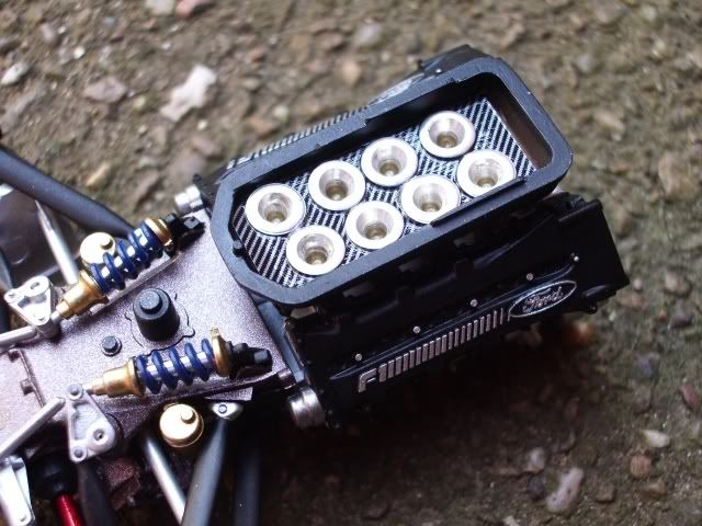

After cleaning up the part that holds the trumpets I painted it black and added some Crazy Modeler carbon fibre decal into the bottom where the trumpets fit.Once this had dried I glued in the trumpets with 5 min epoxy and added a wash of dark copper to the bottom of the trumpets to give them a little depth.The small black 'rails' that the trumpets fit onto needed modifying by drilling out the holes so the trumpets would fit onto them.Once this was done I super glued the whole trumpet assembly onto the engine,added the valve covers and also the rear brake ducts.Later I may add a small amount of wiring,just to give it that busy look,but without going overboard as I'm trying to keep the build fairly simple.
http://i17.photobucket.com/albums/b61/stevenoble/Benetton%20B192/IMGP4614.jpg
Close up view of the trumpets
http://i17.photobucket.com/albums/b61/stevenoble/Benetton%20B192/IMGP4621.jpg
Next I'm going to work on the seat and other cockpit parts.See you on the next update.

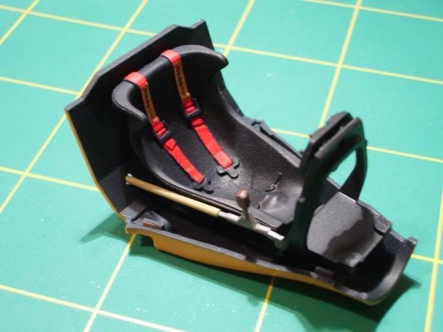

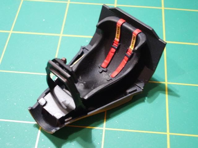

Finished the seat and installed it into the bottom section of the monocoque.I sprayed the straps red,masked them out with strips of Tamiya tape and then sprayed the seat black.Once I've filled the headrest part that fits into the main cockpit tub to smooth out the join,I will add the seat section and fill the main join line that remains as there isn't a join on the real car.It means I will have to mask the cockpit opening whilst I spray the main body colours or the seat will get oversprayed.Reminds me of my aircraft modelling days all over again!! Here's a couple of cockpit pictures so far.
http://i17.photobucket.com/albums/b61/stevenoble/Benetton%20B192/IMGP4662.jpg
http://i17.photobucket.com/albums/b61/stevenoble/Benetton%20B192/IMGP4661-1.jpg
Hope to start painting the monocoque soon in the yellow and green and also start on the front wing assembly.

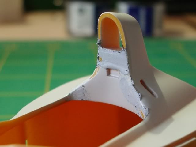

I started on the monocoque and the first job was to remove the join where the headrest fits.Whilst doing the initial sanding I found it to be very awkward to reach because of the shape (the headrest curves inwards) also the small part shown circled on the picture below was complicating matters being moulded as part of the headrest.
http://i17.photobucket.com/albums/b61/stevenoble/Benetton%20B192/IMGP4670.jpg
So to gain better access I removed it with side cutters and a file.Once I have filled the whole thing flush I will remake the part I removed with plastic strip.I have seen some pictures though where this part was not fitted? If anyone has any reference photos and can confirm this I would appreciate it.
Here is the part now awaiting the filler to dry.
