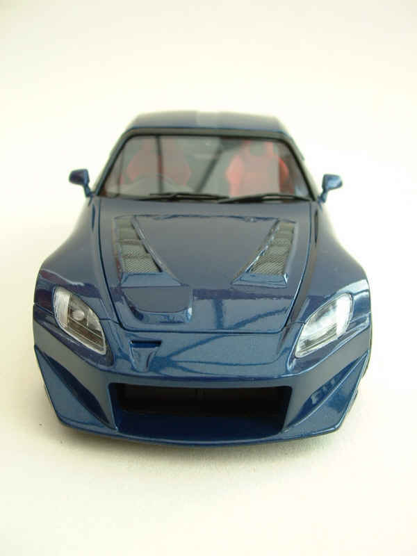

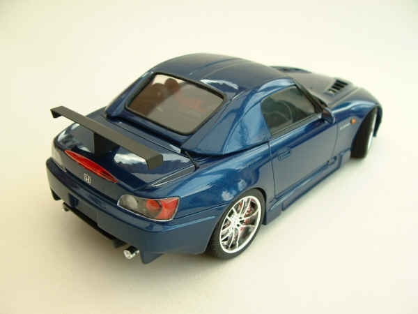

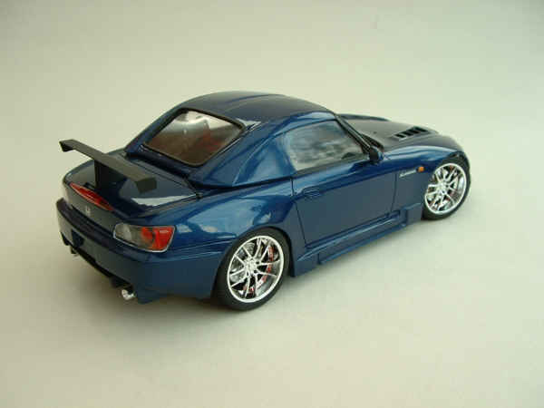

The transkit is now molded so i can finally get this built
Below are all the parts (minus wing at moment) as they came from the molds. My aim with these products is to make them as user friendly as possible which means as little work as poss for you guy's.
The rear is made up of two parts
Parts will fit fine if you cut along the relevant panel lines and some areas may need to be filled with plastic card. The rear is the trickiest to cut away but if care is taken its not too much of a problem.
All the lugs and nodules for fitting parts such as headlights and chassis are left intact so no major surgery is required. The front of the chassis however needs the original lip removed and two new connectors added from plastic card to slot into the new bumper.
The chassis now fits no differently to the original
