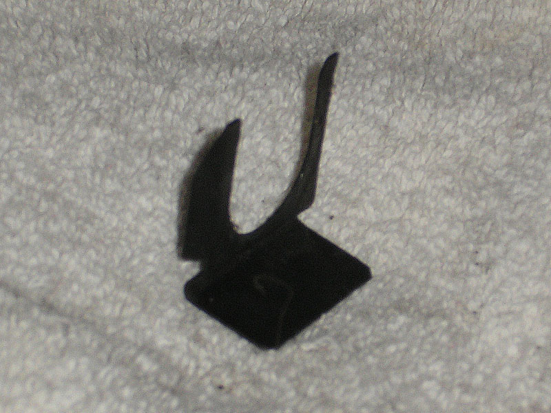

I read this on another forum and I think it is the problem.
"Think of how the brake cables work on your bike. The inner cable actually pulls the caliper because the outer housing is held fixed relative to the frame. These cables work the same way. The end of the housing goes into a slotted hole cast into the tranny case, and a little metal clip (here's a photo (http://www.saturnfans.com/photos/data/500/shifterclip1.jpg)) holds it in place. If the clip comes off and the housing pops out, the shifter MAY still move the cable some, and it won't feel totally loose, but you'll have severely limited or no function. Cross your fingers; that clip MAY still be laying around in the engine compartment."
Is this something a mechanic should check out. I have no Idea where to start. If anyone has had this problem please comment.

No, you should be able to check that yourself. You may need to remove the air intake tube for better vison. You will see that bracket where the cables go into. There will be a brass colored fitting at the end of the cable near the bracket. If you can move that fitting back and forth, then that clip is probably not there. You should be able to see if it is there anyways.

that could possibly be it. and it is easy to check. i've had a few vues do that, but never an s-series.
