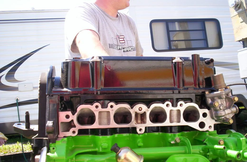

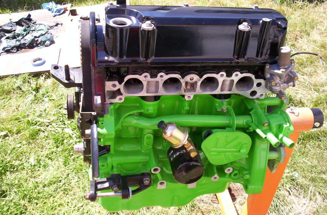

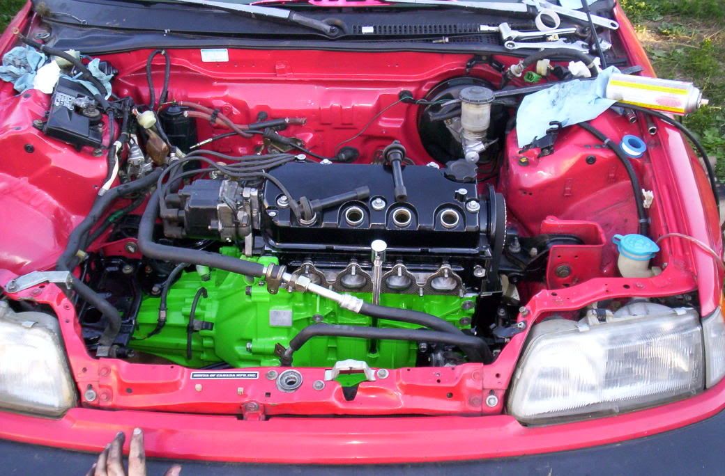

Well I finally built my engine and a am getting very impressed with how this new engine is starting to perform. Fisrt of all the cool stuff:
d16a6 block bored .010 over
d16y5 vtec head ported and polished and port matched for the new manufold that I havent built yet
KMS block guard
eagle connection rods
custom ARP main studs
custom ARP head studs
polished crank
p29 pistons (11.5-1)
4-2-1 header
2.5" exhaust
accel 8.0mm wires
solid front and rear motor mounts
0-60 mph time so far is 6 seconds
here are some pictures of the engine and build
now for the question on the distributor i had to notch the nounting holes to get it to time right. I have heard of this before but never paid attention to the cure for this and now i have the some problem. This will only matter for a little bit because i am thinking of going motec4.
Any help would be appreciatted.http://img.photobucket.com/albums/v386/Verv/Picture180.jpg
http://img.photobucket.com/albums/v386/Verv/Picture104.jpg
http://img.photobucket.com/albums/v386/Verv/Picture122.jpg
http://img.photobucket.com/albums/v386/Verv/Picture095.jpg

Is there a dead body under your trailer? (bottom left corner, second picture)
