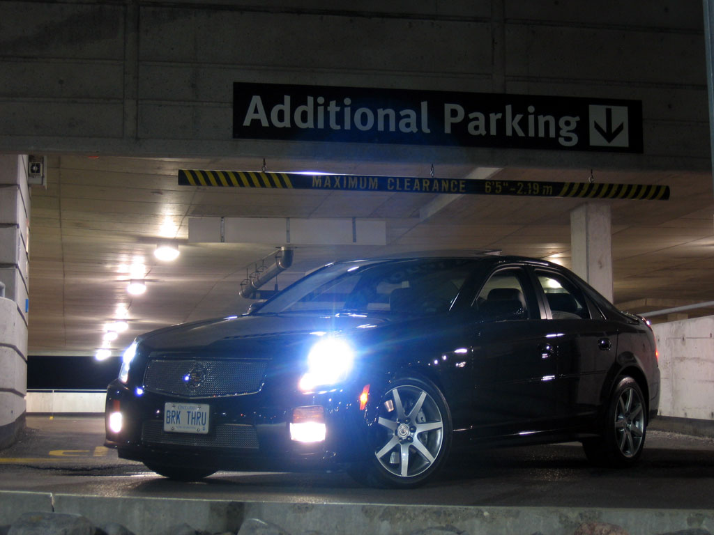

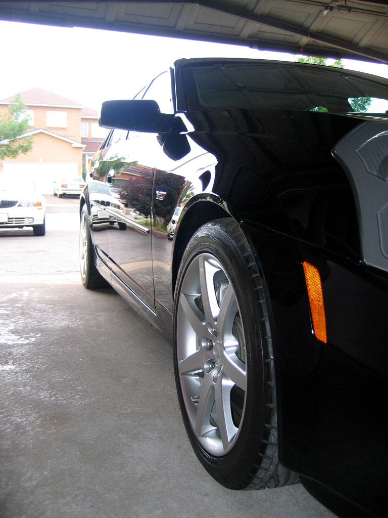

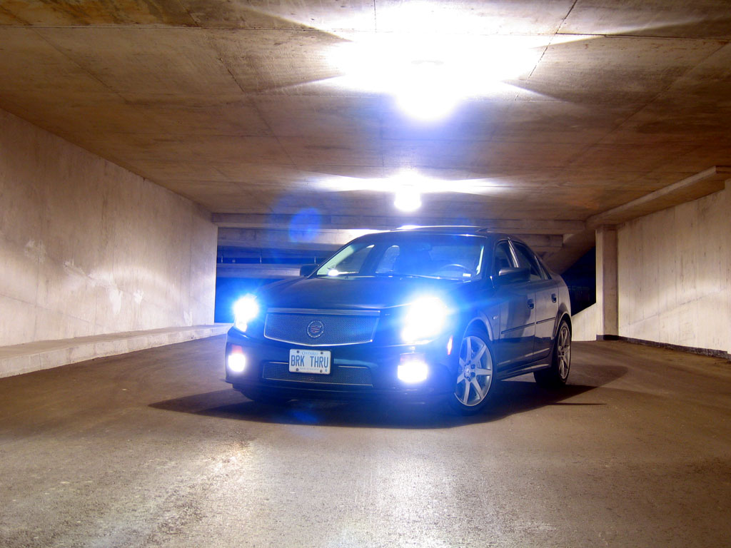

Jon04CTSV
08-24-2006, 08:51 PM
Man I can only imagine how much fun that thing would be. Do you have any pics of it??
http://www.jon04ctsv.com/Detailed/IMG_6582.jpg
http://www.jon04ctsv.com/Detailed/IMG_6604.jpg
http://www.jon04ctsv.com/Detailed/IMG_6571.jpg
http://www.jon04ctsv.com/Detailed/IMG_6616.jpg
http://www.jon04ctsv.com/Detailed/IMG_6643.jpg
http://www.jon04ctsv.com/Detailed/IMG_6630.jpg
http://www.jon04ctsv.com/Detailed/IMG_6648.jpg
http://www.jon04ctsv.com/Detailed/IMG_6651.jpg
http://www.jon04ctsv.com/Detailed/IMG_6652.jpg
http://www.jon04ctsv.com/Detailed/IMG_6660.jpg
http://www.jon04ctsv.com/Detailed/IMG_6655.jpg

my99cavy
08-24-2006, 08:58 PM
I'm in love with that thing man!!!!! :boink:
corning_d3
08-24-2006, 09:48 PM
No doubt, that is a b-e-a-utiful car!! I just looked it up...All the V-series DO have hand-built engines. Who would've though..we spend all these years trying to make machines to assemble engines, and yet they're no match for a set of hands...
