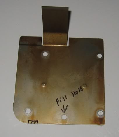

I’m in the process of changing the isolator bolts on my ’00 Windstar and have a question.
I am going to modify my valve cover instead of buying a new one. It looks too simple to do and it seems like a waste of $$ to buy a new one. Im’m having a problem though. I don know how the valve cover is modified. Looking at the photo on http://www.miracerros.com/mustang/pcv_filter.htm (http://www.miracerros.com/mustang/pcv_filter.htm), it appears that the Mustang baffle is a mirror image (reversed) of the Windstar’s. (is this correct or has the Mustang’s baffle pic been accidentally flipped). If the Windstar and Mustang baffles are reversed from each other, I will assume that I need to bend up the small tab on the left of the large one, then notch out a section on the bottom left near the corner with the large radius. This is opposite of the Mustang's. Can anyone confirm this?
Below is a pic of my ’00 Windstar baffle with marks where I will bend and cut.
THANKS,
TOM
THANKS,
TOM

You're right; I hadn't noticed before: The Mustang and Windstar valve covers are very similar - but not the same.
I took a picture of my old-vs.-new valve covers when I did my isolator bolt fix. Take a look at the 4th picture in this album:
http://community.webshots.com/album/551942761oSNGgS
Hmmm - annoying: My picture didn't quite catch the edge of the baffle where the notch is (but I recall the notch being there).
Your modifications look just right. That's exactly what I'd do.

Thanks, That answers my question perfectly.
