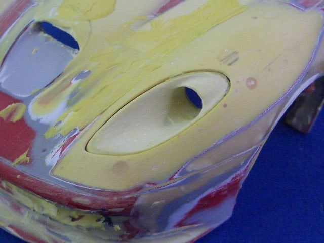

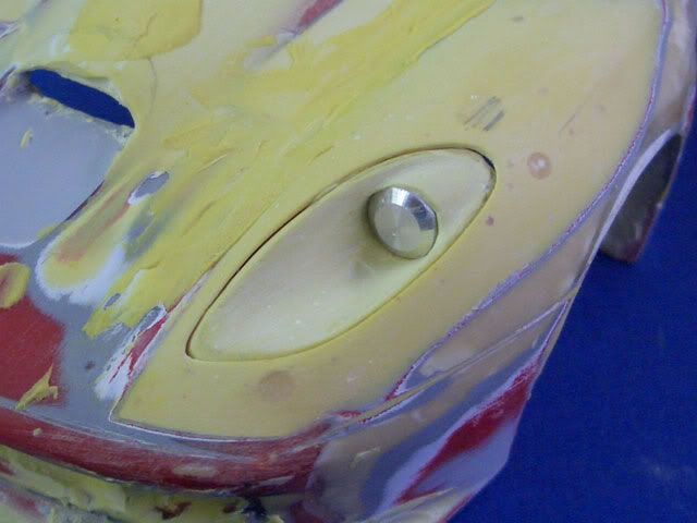

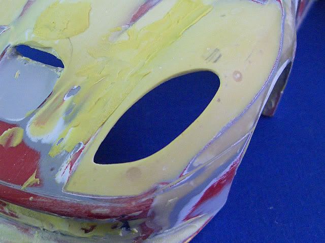

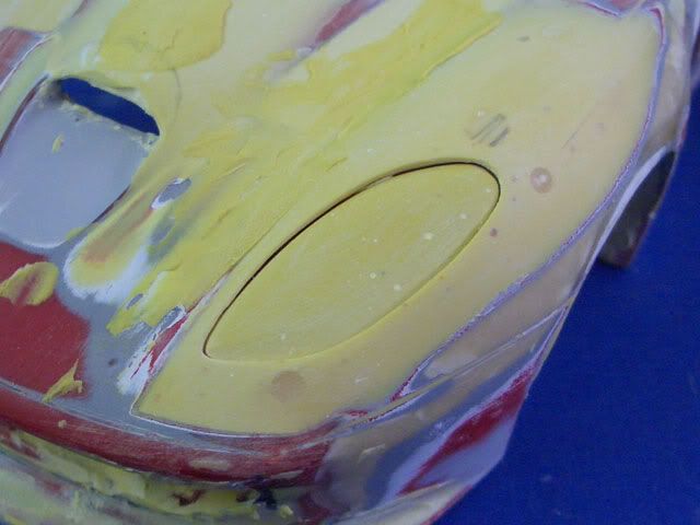

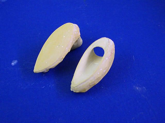

Updates: more on the headlights jobs: a mold to warmcast the transparent cover, another one that would be carbonized as the inner housing part. Fitting is not at 100% also cos the tack glue used. Few touch and would be perfect. The projector is just a sample to test dimensions: I want to turn a better one with lens and "hi-tech" appeal. have fun ;)
Final shape, milled down from inside to remove the mold from below

Glass mold for vacuform, I sanded down the shape of 0.5mm, aprox the acetate thickness
http://i27.photobucket.com/albums/c159/gionc/GTO2005/CIMG6010.jpg
The projector housing:
http://i27.photobucket.com/albums/c159/gionc/GTO2005/CIMG6011.jpg
Parts alone:
http://i27.photobucket.com/albums/c159/gionc/GTO2005/CIMG6006.jpg
Fitting test with the projector's shape roughly turned:
http://i27.photobucket.com/albums/c159/gionc/GTO2005/CIMG6012.jpg
I'd really appreciated all criticism since they keep my focus, my concentration on the design's problem HI. I have to say that I'm having more care of the method to do the things than of the result. Really I'm having fun, learning something that missed in my experience and, at last, improoving the learning curve.
I need to manage well this tips for some interesting project next.
