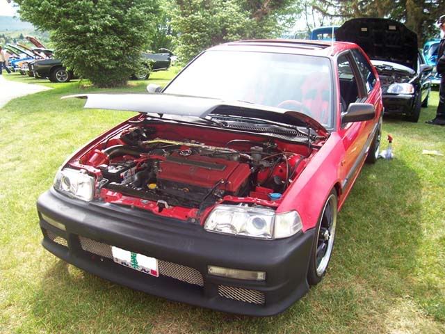

our 89 Si with ITR b18c5....
http://i29.photobucket.com/albums/c262/88CRXDemon/Picture003.jpg
http://files.automotiveforums.com/gallery/watermark.php?file=/500/25765ITR.jpg
here's the link to the thread i made a week or so ago.
http://www.automotiveforums.com/vbulletin/showthread.php?p=4055348#post4055348
fat wallet indeed!
b18c5 + tranny + stuff: $4500
HASport mounts, axels, linkage, hydro to cable conversion: $1250-ish
not required but helps:
z10 traction bar $500-ish
recommend to run obd-1 which depends on if you just run an obd-1 ecu or chipped p28 + conversion harness $150
don't forget to budget in labor. which depends on your local market. w00t! i'm owner of a swap shop so we did it ourselves :icon16:
you can use other mounts than HASport. however, other mounts such as AVID sit the engine a little lower. which is great for a b16 as you need the hood clearance. i don't suggest that with a c5 as the engine is naturally bigger/lower. HASport is just about the only mount that will seat the engine high enough to not rip a hole in the oil pan.

hey did you have to change mounts on the engine bay ?? because my car is a 89 civic si , and the sir civic have differnet engine mounts on the drivers side , also did you the lsd type r gear box ?? u brought the whole car of a type R 96 integra wreaked in using the cvs etc

not to be rude, but i answered those questions already....
please go back and read. you need new mounts. i posted which aftermarket mounts i used, and why i used them verses other mounts avalible.
yes, i am using the hydro LSD gearbox...something else i already posted as well. tranny (american) = gearbox (new zealand). i had to use the HASport conversion to use the hydro tranny in my cable driven car. it's the shiney billet piece mounted to the front of the tranny in this pic:

not i did not get a whole car. most of the stuff in a Type R engine bay is useless in the 88-91 Civic. you can not use the linkage, axels, mounts, or other various parts. you need aftermarket parts in order to fit the Integra parts into a Civic. my b18c5 arrived on a wooden pallet from the engine distributor i use for my shop. the other option is a whole front clip where they chop off the front end of the car right behind the front seats. they send you everything complete including the dashboard, fenders, bonnet, and in some cases the floor mats. that option is good for 92+ Civic or 94+ Integra as those parts switch over....but not good for 89 which does not switch over.
i think your best option would be to find a wrecked ITR or an engine distrubitor. we have a couple of members who have been on this forum a few years, they are on your side of the world. they could help you translate my wacky american slang :screwy: into useful info...and help you locate the parts i speak of.

at the current moment i am using the stock cross-member. however, i have a z10 bar on it's way here. you can cut the stock mounting bracket on the crossmember out. we simply whacked the mounts in towards eachother making room so that after it's pulled out it can be used in another car.
the harness you need depends on which ecu (computer) you use. the ITR ecu you have is obd-2. you really should run it obd-1 so you can check the codes should the check engine light pop on. i'm not sure if you can get the harness over there or have to order one from here....this is where Moppie is supposed to come in....
