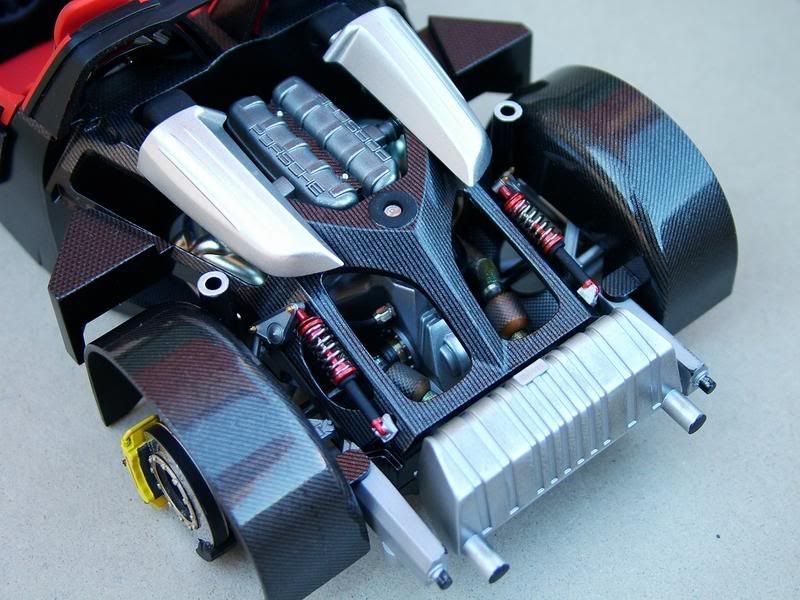

A small update, here is the rear spring and shock assembly. I forgot to take pics of the seperate parts before I put it together. I'm still debating whether I should add further details. :dunno: There is also some minor plumbing on the engine but it's hard to see.
http://i14.photobucket.com/albums/a315/RallyRaider/Carrera-GT/Dscf6360.jpg
I've only got a couple of weeks left to finish this off if I'm to take it to the Melbourne Model Expo.
auw12 - the clear coat is Tamiya TS-13 straight from the can. It's nice to use it without having to worry about wrinkling decals for a change. :) Then I used Tamiya polishing compound, Hasegawa ceramic compound, Hasegawa polymer coat, carnuba wax and finished with Tamiya wax. The Hasegawa system is the secret to such a good shine I think.

klutz_100
05-26-2006, 02:42 AM
I just can't help staring at that picture :lol:
Are the springs hand wound and out on the kit dampers or are they aftermarket parts?

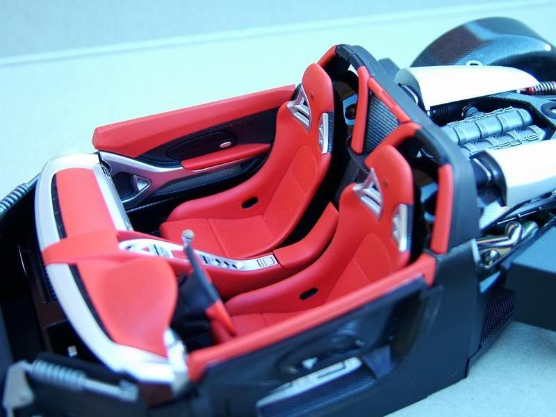

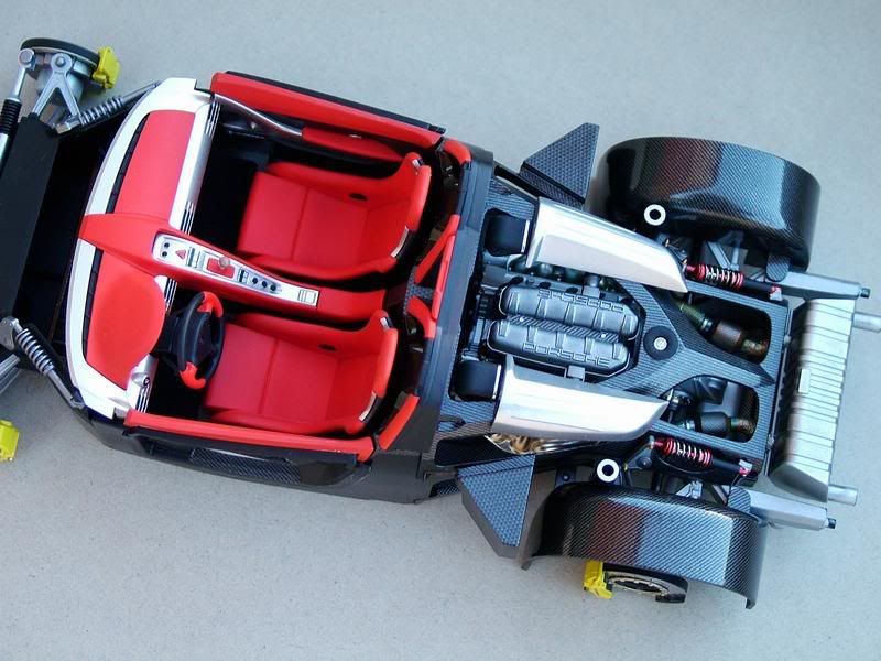

A few quick pics of the almost complete chassis/interior mocked up. Not far to go now. The fit on this kit is so good many parts amost a snap together.
http://i14.photobucket.com/albums/a315/RallyRaider/Carrera-GT/Dscf6472.jpg
http://i14.photobucket.com/albums/a315/RallyRaider/Carrera-GT/Dscf6476.jpg
http://i14.photobucket.com/albums/a315/RallyRaider/Carrera-GT/Dscf6478.jpg

heroblast
06-03-2006, 07:40 PM
wow-weeeeee...
Decs0105
06-04-2006, 04:11 AM
so beautiful... please make sure that we get some high-res shots when you finished it because It will definatly make an awesome wallpaper :iceslolan
91p10nizmo
06-04-2006, 05:15 AM
Stunning. Just dont know what else to say!!!!!!
klutz_100
06-05-2006, 03:23 AM
Outstanding!

RallyRaider
06-05-2006, 04:27 AM
Sorry Steve, I missed your question earlier. I used small springs cut to size. Then used plastic card, metal rod and brass tube to rebuild and strengthen the damper. I should have taken photos of all the pieces to make it clearer.
klutz_100
06-05-2006, 10:22 AM
Sorry Steve, I missed your question earlier....I should have taken photos of all the pieces to make it clearer.
:thumbsup: - clear as crystal, thanks.
BTW this build just doesn't cease to amaze me. It's bloody perfect.
