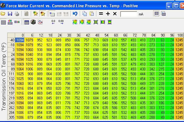

is it possible to just adjust the FM current, that's what it sounds like, it is only happening at a certain temp, a harsh or firm shift
http://i53.photobucket.com/albums/g80/viking_03/fm.jpg
across the top is the % of line pressure, down the side is trans temp and this is from a 4T65E
The higher the current the softer the shift, that's why at 100% line pressure it is max current.

Where did you get that ^^^???
