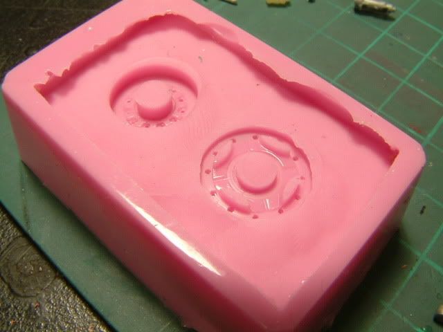

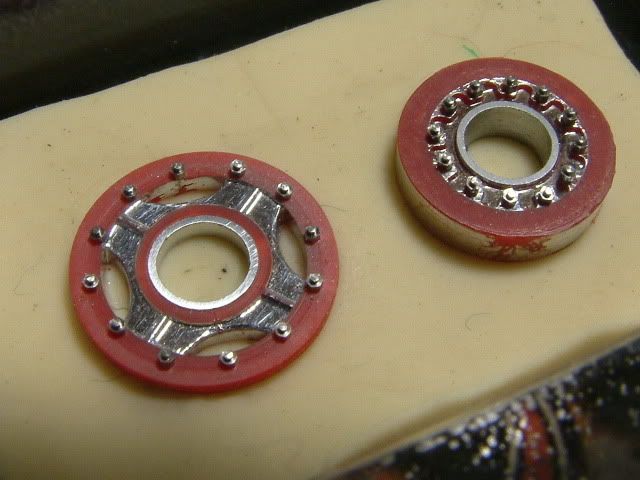

In fact, I decided to make another version of the 312T3 based on the standard Tamiya kit. There were about 3 or 4 different cowling shapes on the 1978 312T3 and I had a couple of extra kits anyway. This time however, I am going to make an extra set of all the turned parts and when the kit is completed I'm going to sell the extra set on EBay. I'm not trying to make money, just help pay for my hobby!
It is probably easier to keep this thread going rather than start a whole new thread with the same name.... so...
First up, if I am going to make two sets of wheels I need to make the wheel centres as well. I turned the Tamiya wheels down so they will just slip into the machined wheels. Then I replaced all the molded on nuts with Sakatsu items. I then made a rubber mold of both the front and rear wheel centres. These wheels will be designed to fit neatly onto the hub and have working wheel nuts like my other kit.
Next, I'll turn 2 sets of front and rear wheels!
