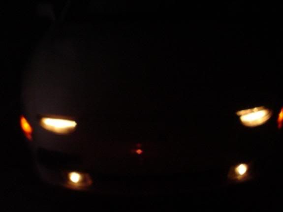

AudibleSilence
11-06-2005, 01:38 PM
http://img.photobucket.com/albums/v328/AudibleSilence/My%20Baby/Snakes.jpg
Here are my snake eyes... 1st gen love.

deagle50ae
11-07-2005, 02:59 AM
Here's my snake eyes. I am using Silverstars in mains and fogs. deffinitely worth the money!
http://i8.photobucket.com/albums/a32/deagle50ae/IMG_2529.jpg
