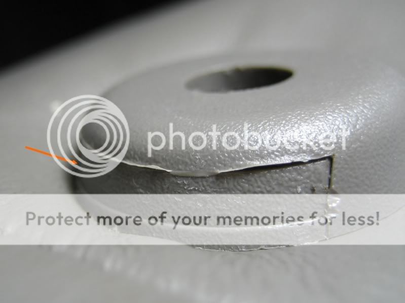

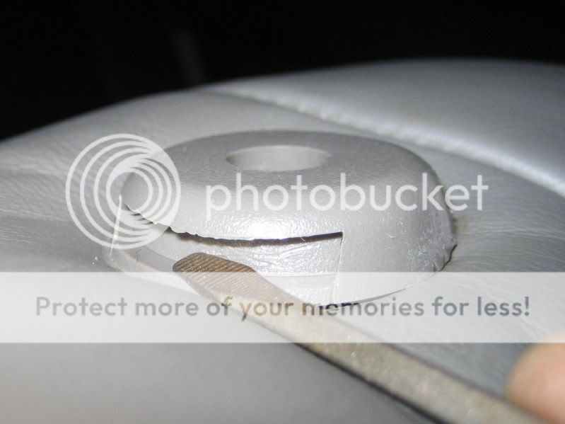

This will probably work for Impalas from 2000 - 2005. There are tabs that are hard to see (until close up) on the side of the round plastic guide that sits on top of the seatback. Both will probably faces the passenger window. Depress each of these tabs with a small screwdriver or similar, and work the headrest posts out. It is easiest if they are depressed simultaneously. The following pictures show the story.
http://i360.photobucket.com/albums/oo41/josephk300/2001%20Impala/Headrestguidetab.jpg
http://i360.photobucket.com/albums/oo41/josephk300/2001%20Impala/Headrestguidetabdepressed.jpg
