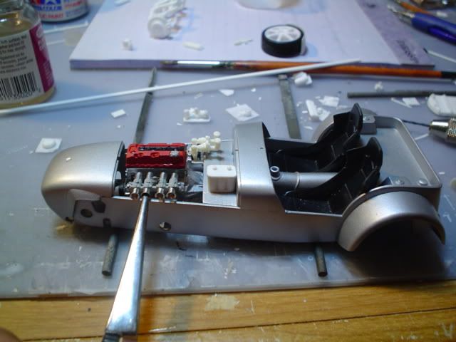

The lightest car I can find crammed with the one motor that has the most power to weight that I can think of. Lotus 7 and a Honda F20C.
Of course, it needed a brake upgrade and the whole rear end had to be redone to take the power. And there will be a lot of cutting of the car and it's hood to get the tall motor to fit, but it'll be worth it. Oh, and this is not normal F20C, it's gonna have individual throttle bodies and a 4-2-1 header making it nice and heavy breathing, and keep throttle response instant. Not a particularly complex project at fist glance, but the Lotus is tiny, and the F20C is surprisingly large. So there's a long way to go on this one.

The throttle bodies I made myself. Some styrene rod, some styrene sheet, some styrene strip for the bodies themselves (some widgetry, unfortunately), I stuck a thin wire through all four to control the butterfly valves, and used a velocity stack as provided in the Tamiya kit as the throttle valve thing... the part that attaches to the cable that hooks to the go pedal. You know what I mean. Then I used Sakatsu turned aluminum velocity stacks, and some aluminum tube for the runners. You can see it on the hood in the pics, needs detail paint and the flange to bolt to the head still.
The mods to the rear suspension - didn't use a single Lotus part. I have a couple S2000 kits that are being parted out, so I narrowed the S2000 rear end (it's a simple tube job) and stuck it in. Some trial and error and it fit fine.
It's right hand drive. At first I cursed it, as I wanted to make it an American racer, but it turns out to be better as it would be harder to rout stuff around the throttle bodies than the header. I have a little more latitude with the header and where I route it. I do, however have to box out the entire footwell from scratch - a total pain as I have to get around the pedals and the F20 tranny (I will actually have to sand away some tranny... shhh!). The actual steering column will need u-jointsto get around the header, which will also be a pain. Yarr!
The biggest problem will be the hood. I will need a rather large hump in the hood just to clear the motor, an it will look funny with as far forward as it has to start. Oh well. The price we pay for mad power at the track, eh? And I guess it's good that I never did find the aluminum Sakatsu hood, would've been useless.

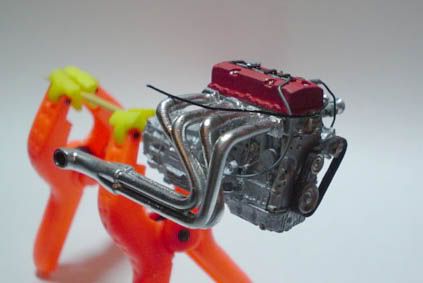

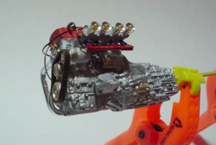

Steady work but not very fast. I decided to paint it before going further, and since the car is open, most detailing can be done after paint and major assembly, and indeed will be easier. Right now it's in Tamiya gloss aluminum, waiting for blue lacquer through the airbrush tomorrow. That'll give it a nice week before I polish it. This model will probably go months before the hood is made and put on. HLJ just sent my last order from them (I had an outstanding order of a Sakatsu motor, velocity stacks and aluminum hood and I didn't cancel it in time) so I have a hood coming in, I am thinking about somehow pressing the bulge in the hood. Yeah right. You can't tell in the picture but that motor sticks about 2.5mm over the hood, it'll be a big bulge. I'll let it run straight back and have it vent out like a.... whatever hood it is muscle cars get with the vent in front of the windscreen. What else? The hole where the original Lotus 7 exhaust goes will get an bent aluminum sheet scoop, and will wash air over an oil cooler that will nestle under the throttle bodies. I will have to cut a hole in the other side for the new header, but it will be surrounded by an aluminum sheild, so the cuts in the paint will be covered. I'm planning on plumbing the brakes and the clutch, wiring the battery to a fusebox and ECU (though they may be imaginary and in the passenger footwell) and all that jazz. The only thing it needs that I don't have laying around is a "Powered by HONDA decal... though I'm sure if I scour my decal sets I'll find one.
Just in case anyone's interested, this probably has a higher percentage of aluminum than an NSX. For a tenth the cost. [/pretending the car is real]

Damn those are really nice ITB's! Keep up the good work! :iceslolan

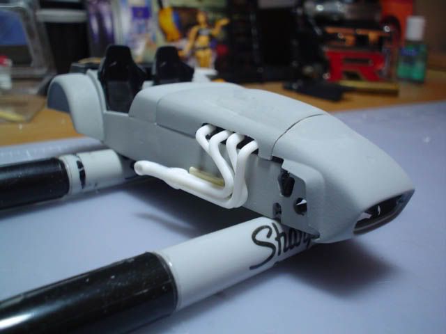

A little back pedalling and then starting back in the right direction. The blue crapjob paint was stripped, and I did the hood while it the rest was in primer. Better idea. This time the car will be green. Unfortunately, in primer, you can't really tell how the hump in the hood looks. Let's just say it big, and funny looking. But I kind of like how it's got to have the big hump to hold all the performance in. I also opened holes in the hood for the intake and the exhaust. Thanks, CADguy for finding me such a great header! Though, my girlfriend called me out in the hobby shop ("Hey, isn't that the kit you want for one part?") and I got a lecture from the car guy there ("You should scratchbuild the header from solder [young lazy punk kid - ed].") Oh well. Looks perfect, though. This car looks really weird with no wheels, by the way.

Those headers are very fitting for sprint cars, salt flat racers, and Super 7's alike ;)

Did a little work this weekend. Slow and steady on this girl. Some motor work, most of the plumbing is done. Still have to add a O2 sensor and bung to the exhaust, wires for the fuel injectors throttle sensor and map sensor and stuff. Have to still prepare the cap that goes on the oil filter hole, and sends oil to the remote cooler. Also have to add the fuel line to the rail and the return line (with a banjo bolt). But mostly the motor is done. Save for the Vtec solenoid, damn I keep forgetting about that bit. Oh well. Here it is, the all-motor F20C.

mike@af
08-29-2004, 08:44 PM
Wow. Super detailed! I love the spark plugs, and the headers look superb!

Man that is one neat F20C! Loving every bit of it! :iceslolan
StephenDeli
08-29-2004, 09:42 PM
Nice job Willimo. You attention to detail is amazing. There is something about that header I really like but I dont know what it is!

Oh man :)
Love those velocity stacks.
Out of curiosity, the 4 thingys on the valve cover are spark plugs/coil packs?
What happened to the VTEC strip on top, or does that come on later?
What size/type wire are you using because it looks so money!!

Good job with the wiring, and i love the header too. But didn't you put the A/C compressor in place of the alternator ?

The for thingies on the valve cover are supposed to be the coils, or at least a reasonable facsimile. I'm not going to use the VTEC strips since most of the real heavy duty performance engines I see do away with pretty stuff like that (extra weight, I suppose) and because it's a photoetch part in the Sakatsu set that I didn't cast. The wire I use is Detail Master, though I can't tell you the size. I just grab what I can at my LHS, bring it home, and use whatever wire looks the right size. Since they are usually funny colors (mostly blue wire was used on this) I paint it with Tamiya acrylic, which is ok if you don't handle it. Some of the vacuum lines are miniature solder, and connecters may be the wires from inside a telephone wire. All painted, of course.
But didn't you put the A/C compressor in place of the alternator?
I did put the alternator where the A/C compressor normally goes to save some underhood space, but it is indeed the alternator. I figured with the amount of fab work the owner had to do with this, relocationg the alternator wasn't any biggie for him.
