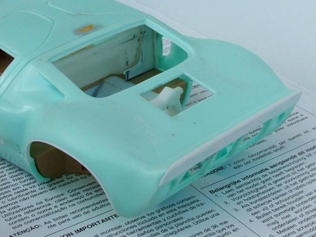

Been doing a bit of fiddling with the GT40. Although I toyed with the idea of dropping it for the comp when MickSz entered his already completed, HRM engined version. I decided to press on with it and up the ante for accuracy.
First thing to be attacked is building up all the missing structural parts, especially at the rear which missing a lot. At the front I've cut off the sides of the nose to be built up with tube and sheet styrene. Holes have been drilled in the radiator return housing and some tubing added to the floor. I don't have any detail pictures of P/1079 so will be doing this as a generic GT40, albeit one that is prepared by JWA to full '68 "Gulf Spec"

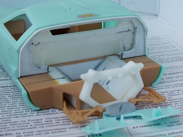

At the rear I've started on the bulkheads, the pen marks indicate where the suspension and engine mounts will eventually be located.
http://files.automotiveforums.com/gallery/watermark.php?file=/502/50846Dscf2088.JPG
http://files.automotiveforums.com/gallery/watermark.php?file=/502/50846Dscf2086.JPG
That's all for now folks.

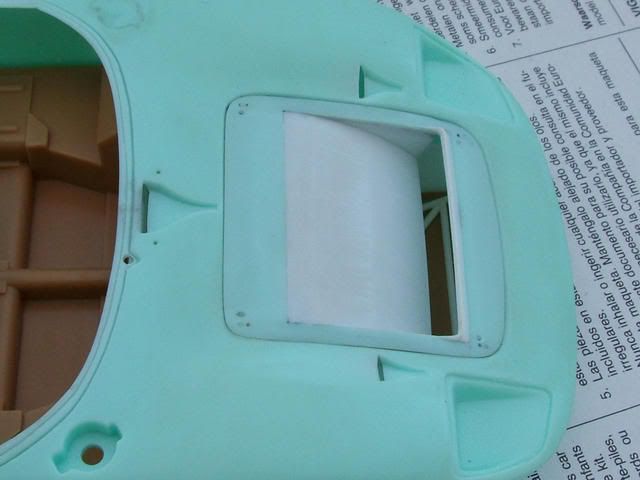

Time for a bit of an update, not a lot to show. First pic shows the nose where I've tried to make a more realistic framework for the cover to sit on. Second pic shows the wheel cover that I've cut up to rebuild with styrene sheet. The radiator exhaust opening on the Fujimi part is too shallow, curved at the front where it should be straight and starts too far back. I was originally going to try and modify a Mk II part (which is an extra in the kit), but figured I might as well do it right! The opened up grill at the front can also be seen. Unfortunately the Studio 27 photo etched grill is too small to cover the hole, so I'll have to build it up a bit on the sides.
http://files.automotiveforums.com/gallery/watermark.php?file=/502/50846Dscf2975.JPG

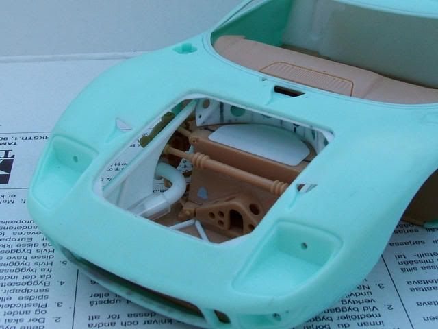

Last pic shows the engine cover that is being modified in various ways and the wheels that have been stripped to be painted gunmetal at a later date. Also the P/1075 style door handles have been filled in, I'll have to make more conventional GT40 handles for it. If I had any sense I'd have just started with a non gulf kit :silly:
http://files.automotiveforums.com/gallery/watermark.php?file=/502/50846Dscf2989.JPG
http://files.automotiveforums.com/gallery/watermark.php?file=/502/50846Dscf2984.JPG

RallyRaider
03-27-2005, 07:16 PM
Only two months left until the comp deadline. :eek: So time to pull the finger out and make some progress, although all this styrene work is very time consuming. New, deeper, straighter, radiator exit is ready for primer. Next pic of some detailing underneath, all the white stuff is styrene.
http://i14.photobucket.com/albums/a315/RallyRaider/GT-40/Dscf4511.jpg
http://i14.photobucket.com/albums/a315/RallyRaider/GT-40/Dscf4522.jpg
Lots left to do!

pettercardoso
03-27-2005, 07:18 PM
ahhhhh, finally! :)
I was wondering when you would pull this out of the drawer, Phil.
The inner front details look very, very good. I hope you will keep us posted with this marvelous build.
I am also taking some notes to when I build my GT40 ;)

RallyRaider
04-02-2005, 01:59 AM
A little bit more work, on the rear end this time. First up a lip has been added to the wheel arches as well as a big ol' Gurney flap on the back. Second pic shows some work to the rear bulkhead as well as the seating for the rear bodywork, used 0.5mm rod to simulate the rubber seal.
