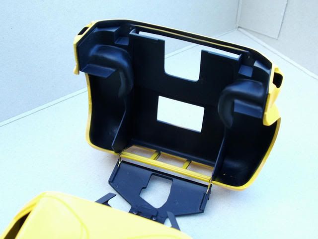

Hinged the back end. All I need to do now is rescribe the door handles, build up the inner structure of the engine cover and fix up a few intakes, then I'll finally be ready to start painting...

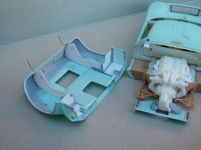

Back into things this weekend. :) Mainly working on the inside of the engine cover, one of the trickiest things I've ever done on a model! Basically I wanted the entire rear structure to be one part that can be painted separately then dropped in. As is stands now the structure clips in and holds its position without glue. Still lots of gaps to fill and I need to figure out a way of building the ducts from the side intakes to the rear brakes.
Making everything fit resulted in some compromises compared to the real car, but GT40s were dynamic race cars changing spec all the time - so that will be my excuse. :icon16:

Thanks guys. I should've got motivated a lot earlier to meet the deadline, left it a bit late now. Anyway I'm one of the judges so not eligible for the main categories.
SF - the hinge is made from a brass tube with a smaller brass rod inserted through the middle. The tube is super glued inside the rear lip of the cover. The ends of the rod fit into two more small tubes on the back of the chassis. I've had to cut up and modify things to make it work. In general I'm not following Fujimi's instructions much building this thing!

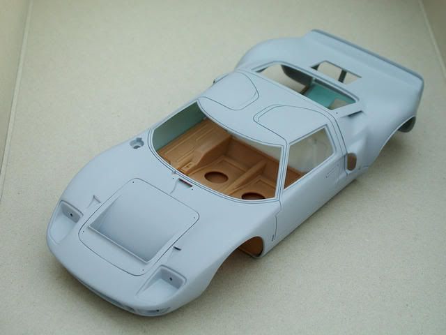

Body work is now primed. :) Still a few rough edges to clean up. In this pic you can just see the rescribed door handles as well as the extensions on the three NACA ducts on the nose. Also the panel lines were scribed deeper and the window/light surrounds sharpened up. I was a bit worried how the full width radiator exit would look but it came out fine. Next some white primer followed by Tamiya Chrome Yellow.

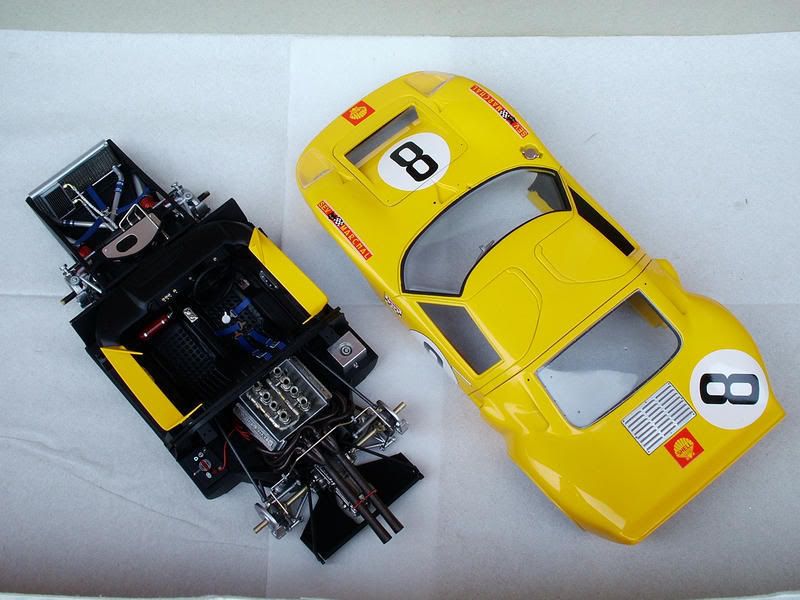

I'm actually a judge Straight six, so can't enter the two main categories. Besides have you seen some of the other entries?! :eek: Some absolutely stunning stuff happening, this may not even be the best GT40 in the comp! :)
Anyway the decals are now on, I'm kicking myself because I slightly misaligned the number decal on the nose - not enough time to fix it (great having an excuse like that! :)). The colour just keeps getting lighter and lighter too, what initially looked like a fairly orangish shade now looks stark yellow with the decals and trim painted.

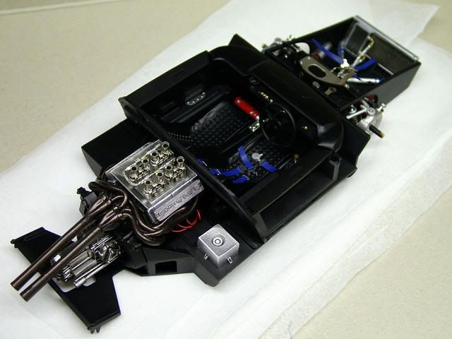

Interior and front end basically finished, just need to work on the rear end and exterior...
http://i14.photobucket.com/albums/a315/RallyRaider/GT-40/Dscf4841.jpg
http://i14.photobucket.com/albums/a315/RallyRaider/GT-40/Dscf4832.jpg
http://i14.photobucket.com/albums/a315/RallyRaider/GT-40/Dscf4834.jpg
