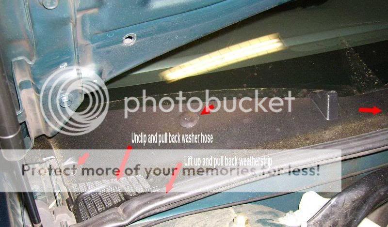

Overview of cowl with short arrows pointing to clips/screw to come out (center clip not visible). The round hold down is a plastic screw.
http://i360.photobucket.com/albums/oo41/josephk300/Airfiltercover.jpg[/IMG]

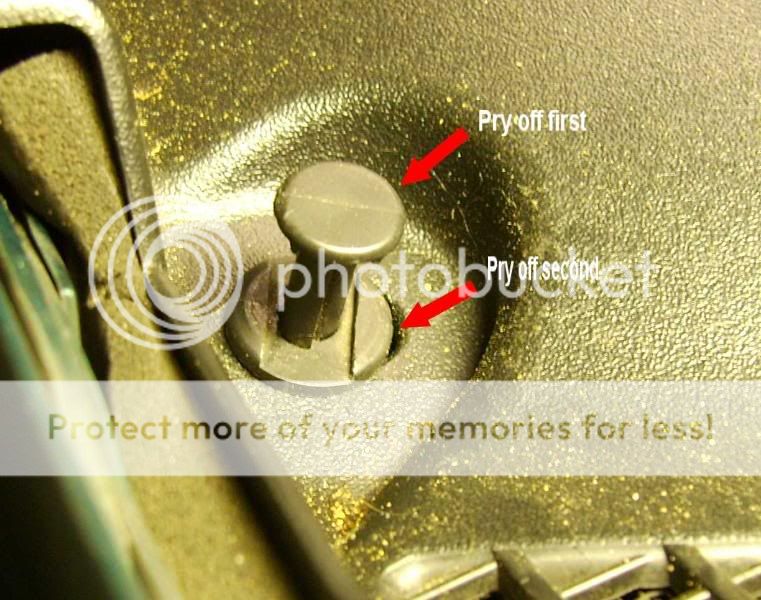

Closeup of of clip. Remove the center part first, then pop out the entire clip
http://i360.photobucket.com/albums/oo41/josephk300/Cowlclip.jpg[/IMG]

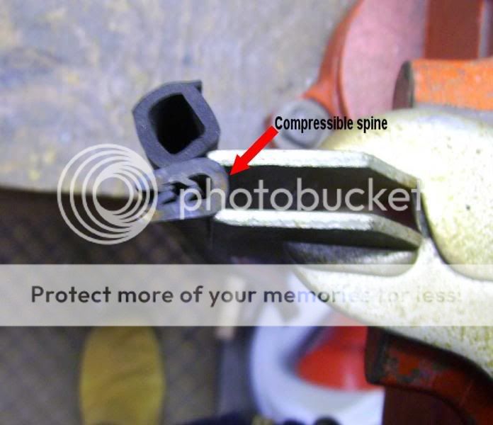

Weatherstrip side view, being crimped by welding pliers. There is a metal spine which can be crimped to "tighten" the strip to hold better. Some of the posts indicated using sealant, but after crimping the entire length, it went on nice and snug
