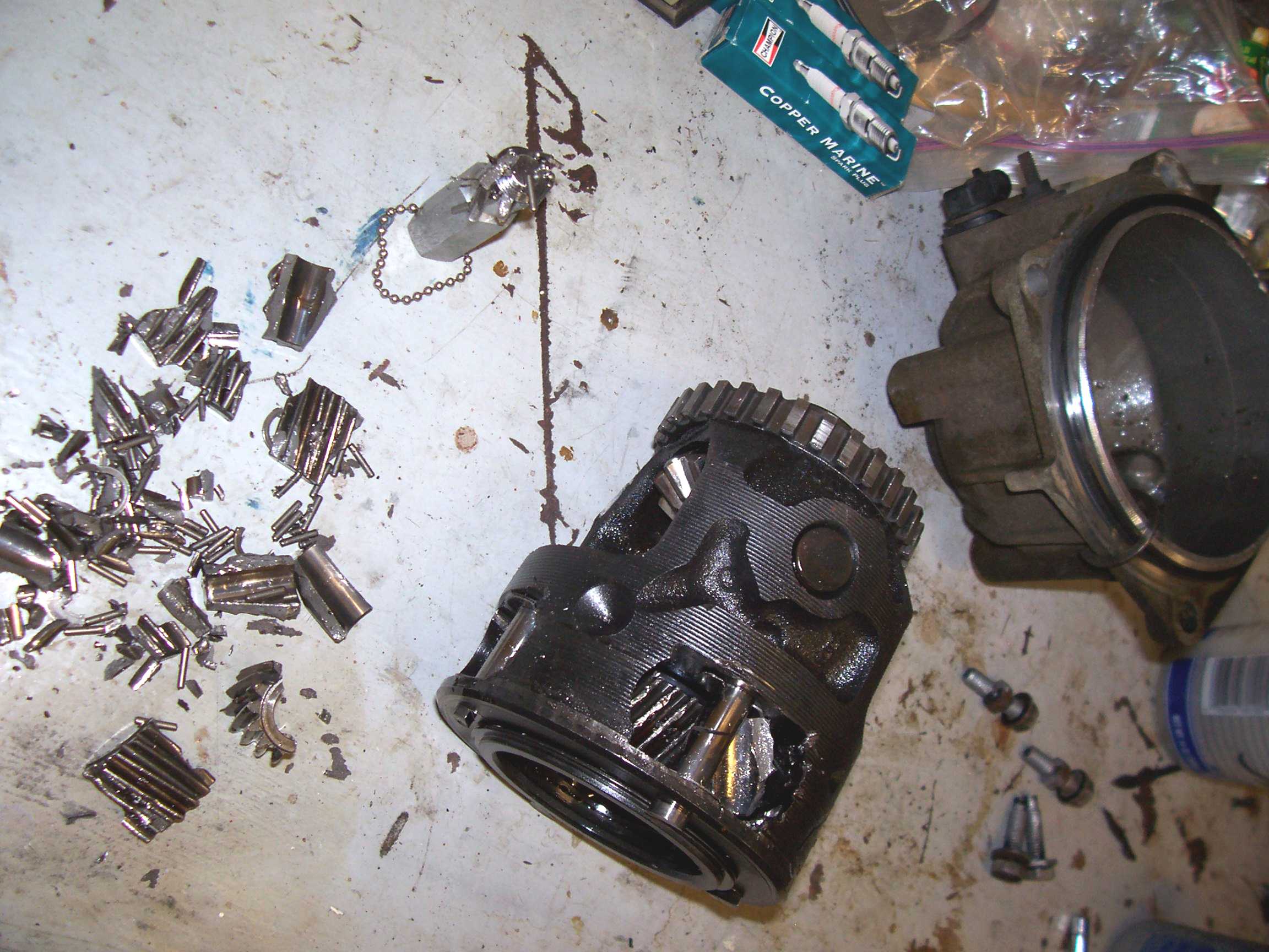

The differential in the 4T60/65 and variants was a problem in even N/A cars with any torque. Been there.
http://www.wwdsltd.com/files/4T65DifferentialDamage02.jpg

:runaround: Geesh that differential definitely couldn't handle the load
