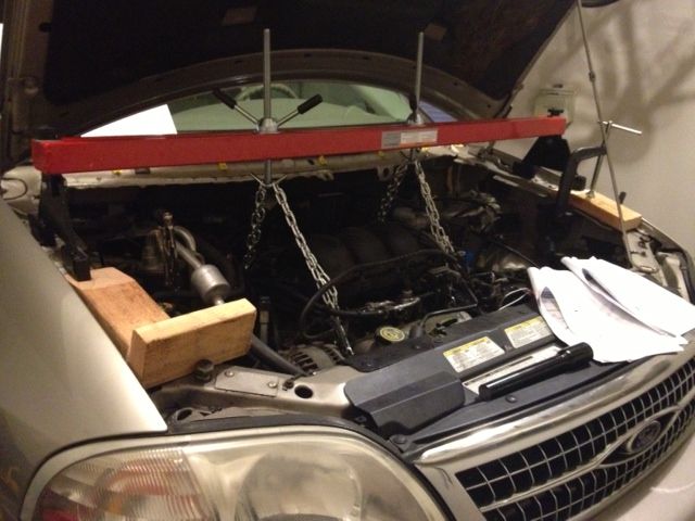

Agreed, the strut is very robust ... just think what happens when the front end of a vehicle happens to bound off the ground ... the piston stop must be rugged enough to stop the spring force, probably thousands of times.
I don't have a good image of how you intend to remove/support the engine ... please be safe!

I disconnected the suspension components last night and, as predicted, the spring barely noticed the weight.
12ounce, I'm using a support bar mounted across the fenders to support the engine when the subframe is out. Here's a picture of one installed on a Taurus:
http://s1235.photobucket.com/user/dhollow2/media/enginesupportbar.jpg.html
This is the process Alldata and Haynes specify. I won't proceed until I'm certain the engine is securely supported.

wiswind, thanks for the input. I did buy a Ford reman transmission so it comes with all new sensors. Before I dropped the pan I disconnected the cooler return line and started the van to check the fluid flow. It pumped out about a quart per 15 seconds which is adequate flow according to what I have read. I ran transmission flush through the cooler and I'm installing an in-line filter as well. I installed an aux cooler a couple of years ago hoping to delay the demise of the old transmission so I'm good there.
I planned to spend a couple of full days over the weekend and get close, if not totally finished, but life got in the way and I only spent a couple of hours on it. For 12ounce, here's a picture of the installed engine support bar:
http://i1235.photobucket.com/albums/ff440/dhollow2/Windstarenginesupportbarinstalled.jpg (http://s1235.photobucket.com/user/dhollow2/media/Windstarenginesupportbarinstalled.jpg.html)
I did have to make some wedges out of 2x4's to ensure the bar didn't slide on the sloped fenders but it's rock solid hanging from 4 chains. I should have the subframe (all-thread method, thanks again 12ounce!) and maybe the transmission out tonight after work.
12Ounce
05-22-2013, 04:44 PM
Nice looking store-bought rig! I have a similar one ... well, kinda ... LOL! It amounts to two lengths of 2x4's ...longer that what you have, but there to protect the tops of fenders and leveled for good sliding about. And my cross-beam is a 4x4 ... with chains around the engine. I've used this on other models ... not yet on the Windstar. But I will use it soon as I want to replace the Winny sub frame, and replace the front engine cover gasket.

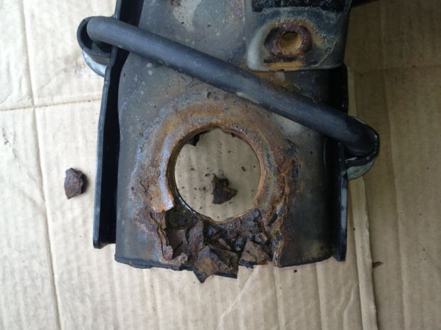

I finally had time to work on the transmission and subframe swap over the weekend and I'm just about done. I just have to get the old flex pipe separated from the Y-pipe and then reinstall and it's ready for the road again. I did make one rather disturbing finding when I pulled one of the rear body mount "pucks" out of the old subframe and the steel completely fell apart around it.
http://i1235.photobucket.com/albums/ff440/dhollow2/2000%20Windstar%20Transmission%20Replacement/IMG_0543.jpg (http://s1235.photobucket.com/user/dhollow2/media/2000%20Windstar%20Transmission%20Replacement/IMG_0543.jpg.html)
http://i1235.photobucket.com/albums/ff440/dhollow2/2000%20Windstar%20Transmission%20Replacement/786569ec-346c-4717-90a6-53c64ccea491.jpg (http://s1235.photobucket.com/user/dhollow2/media/2000%20Windstar%20Transmission%20Replacement/786569ec-346c-4717-90a6-53c64ccea491.jpg.html)
The only thing keeping the subframe from breaking loose was the bracket installed during the recall. To anyone "Up North" that hasn't had the recall performed - GET IT DONE! I feel much better knowing it now has a rust free subframe on it.
Plata
05-29-2013, 12:06 AM
WOW that subframe was literally ready to broke
i also removed mine in my old windstar 2000, because of the same, removing the transmission, and it doesnt seem to be that damaged, really, that is serious damage.
The mine was broken from nearly that place, but it has no rust, so i could weld it.
Something that i could see, its other bad designed thing, just under the battery comparment, the subframe it has rust (yes in that lace it has rust) exactly in the drain hole of the battery comparment, i dont know if that is caused by the battery, because of the acid or what, but well its very strange, and its another place to verify the subframe, just to be extracareful and avoid future damage, we could paint that zone or something to avoid the rust

One final post to put close the loop on the thread. We picked up the van today after being out of town most of last week. The transmission feels great and the 2/3 shift issue is gone. Per the repair order: "Disassembled valve body and inspected, found scoring in 3-2 shift timing valve and gaskets out of position. Replaced valve body". Best of all: "Total Invoice $0.00".
So the project is finally complete and we have a new transmission, subframe, control arms, motor mounts, flex pipe, exhaust hangers, left side outer tire rod (my bad on that one), sway bar bushings, and tires. I have pictures from the project and I'll try and get them up in a new thread sometime this week. Thanks to the community for all the advice along the way!
