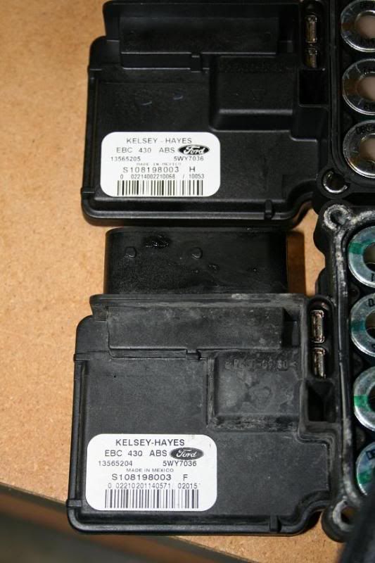

holy *****, mine was $500.xx from ford. was your amount much different? did you notice any revision level difference on your parts? AA to AB, etc.?
here's mine.
http://i26.photobucket.com/albums/c117/parkerbrooks/IMG_3759a.jpg
looks like mine went from a F to a H
and you're aware of TSB 02-7-5? it basically says they are aware of issues with the low tire warning lamp saying on after 1 or 2 tires have been replaced. the ECM was too picky [like a true AWD setup] and wouldn't give leeway. their fix was to replace the ECM. :iceslolan

here's mine.
