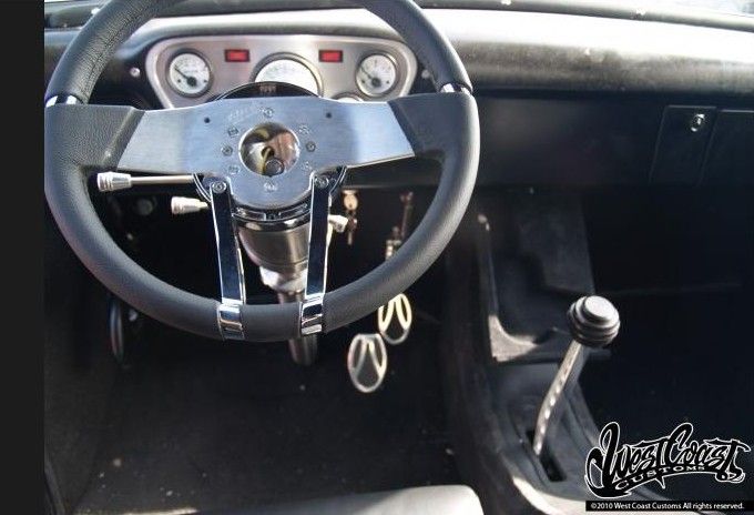

Wheels have not reached me so I can not really do anything with the chassis. So I looked to interior.
This is the interior of the movie truck
http://i49.photobucket.com/albums/f257/grafit_photo/F100/1010tr_081955_ford_f100interior.jpg
http://i49.photobucket.com/albums/f257/grafit_photo/F100/wcc01.jpg

Next action in the center tunnel
http://i49.photobucket.com/albums/f257/grafit_photo/F100/1010tr_081955_ford_f100interior1.jpg
http://i49.photobucket.com/albums/f257/grafit_photo/F100/IMG_1253.jpg
http://i49.photobucket.com/albums/f257/grafit_photo/F100/IMG_1254.jpg
I made a templet to test the shape
http://i49.photobucket.com/albums/f257/grafit_photo/F100/IMG_1255.jpg
http://i49.photobucket.com/albums/f257/grafit_photo/F100/IMG_1256.jpg
