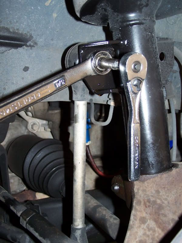

3. With one wrench on the stud, I broke the nut off the link (top attachment and bottom attachment.
http://img695.imageshack.us/img695/2374/033sa.jpg

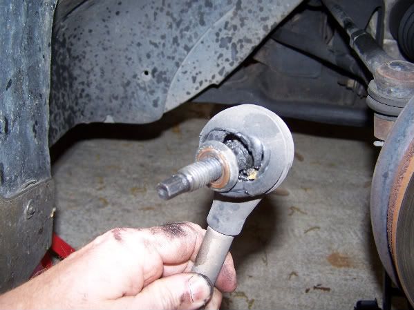

Here is the old busted one.
http://img263.imageshack.us/img263/4154/036wf.jpg
