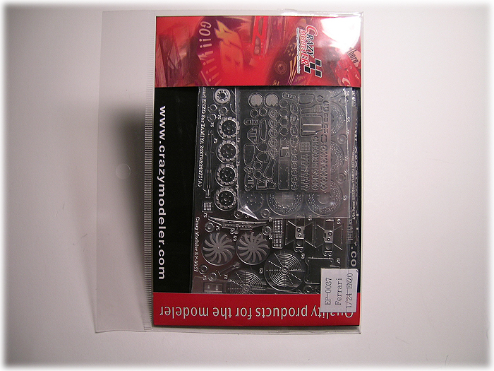

Crazy Modeler's etching set. These are very crazy indeed.

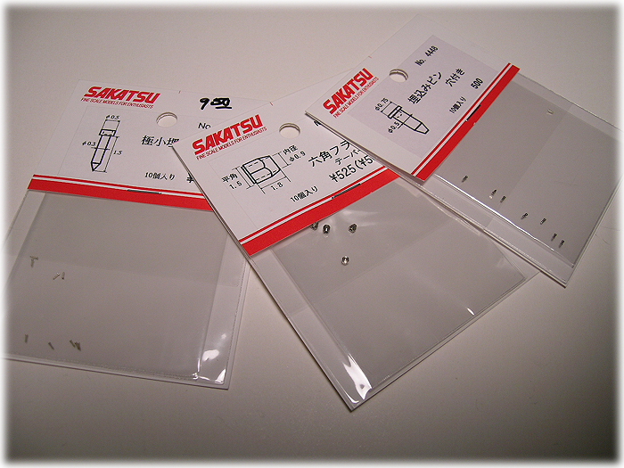

Sakatsu tuned parts.

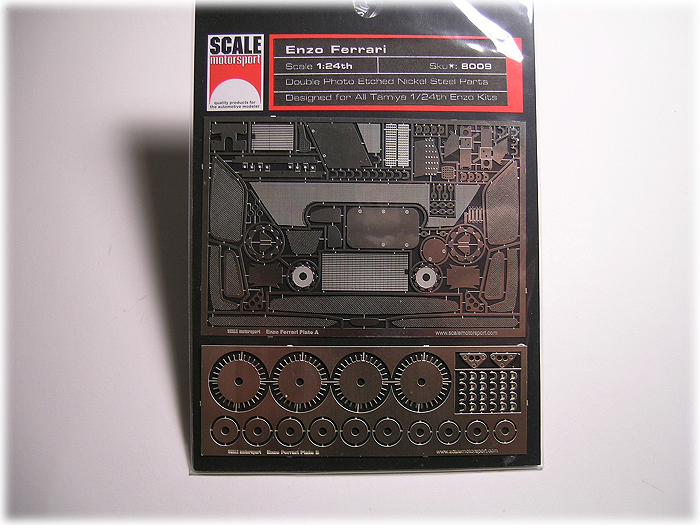

And of course, SMS' parts.

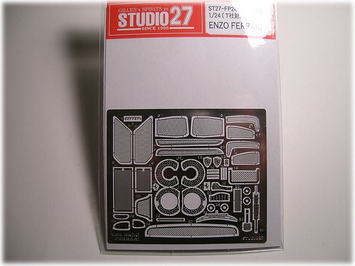

S27 as well...

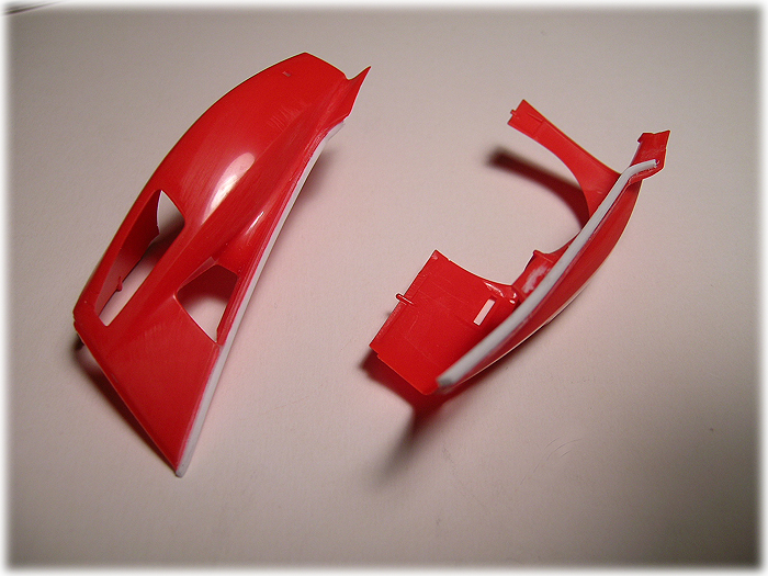

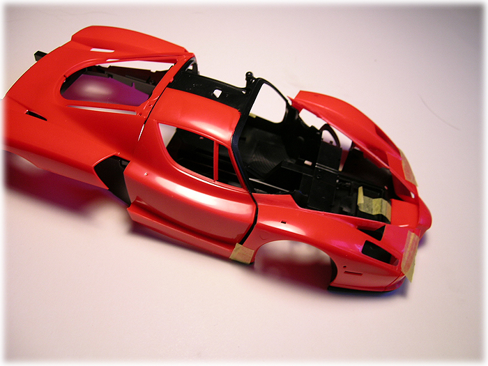

I decided to open the front hood for this model, so I cut the front peice without thinking too much. Whatever happens here, I will take care of it later.

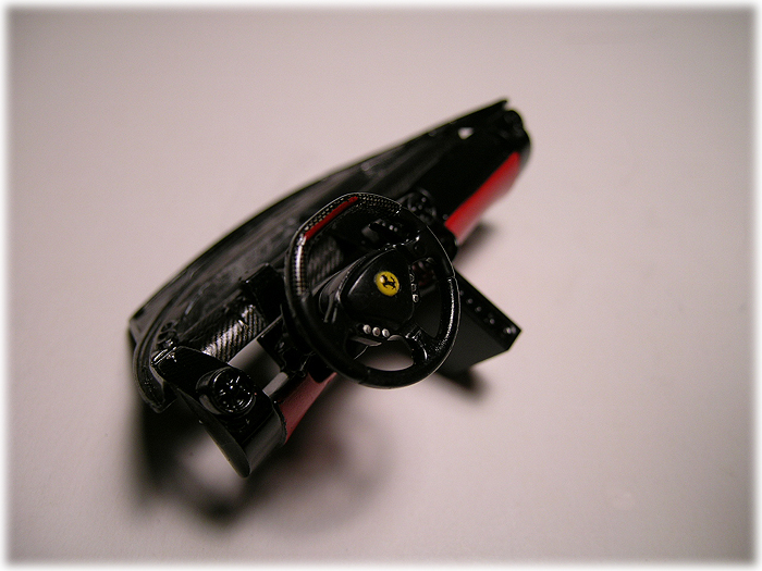

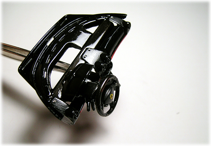

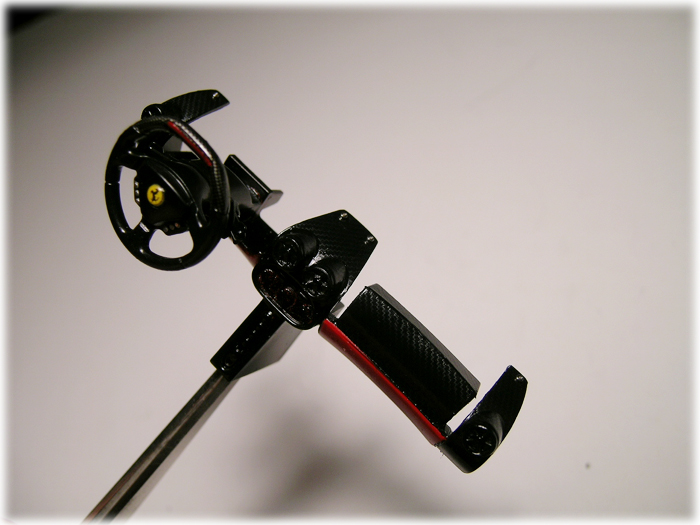

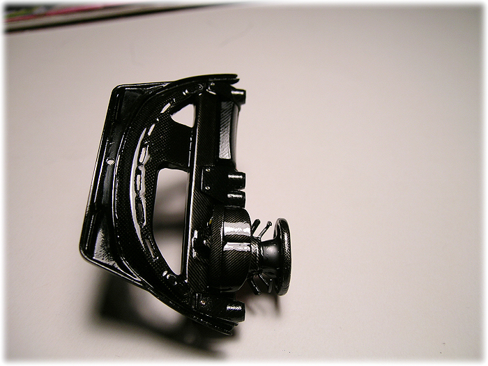

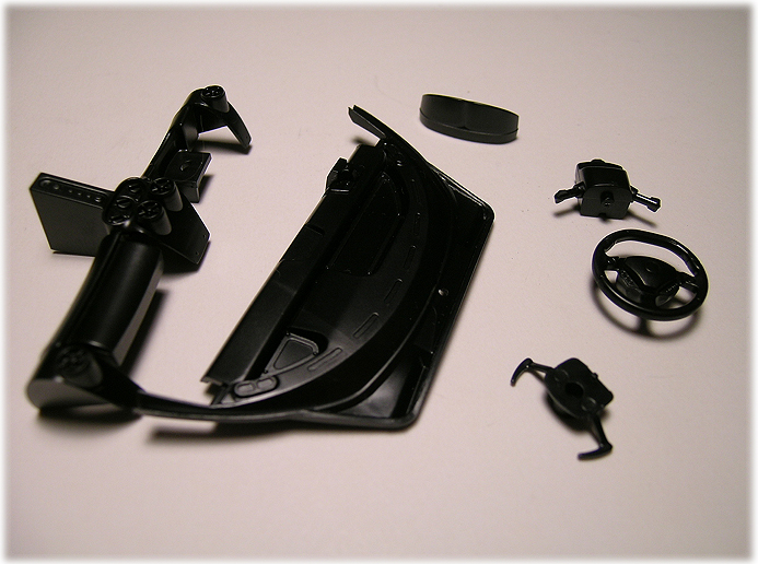

Preparing the front dashboard assembly...
This part will need some detail up work...
Adding minor details on the steering wheels as well.

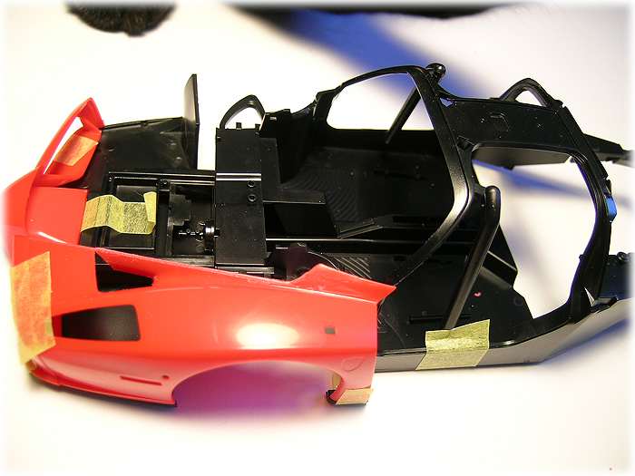

I am trying to test fit the front fender area to understand the work load involving the opening the hood.
It doesn't look good and it is going to be tough to get everything fit correctly.
Now I am regretting what I have done. But I still don't want to think about this too much now.

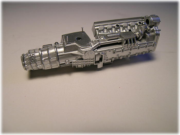

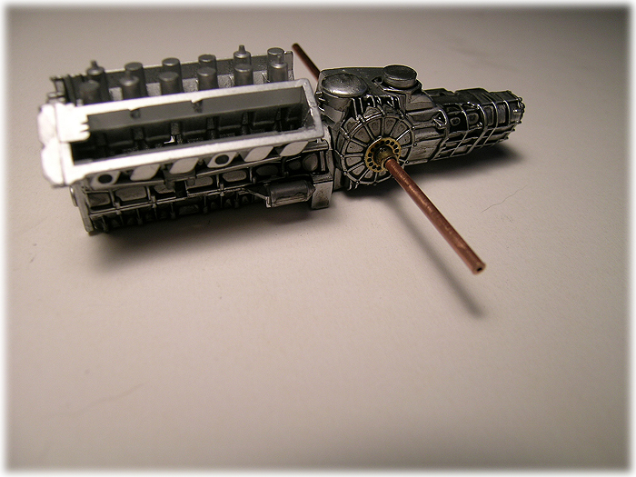

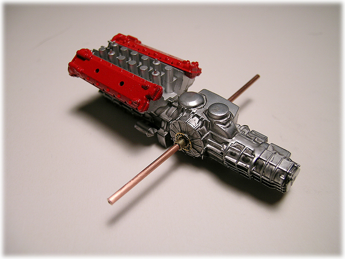

Starting with engine, I applied Testor's Metalizer Aluminum and gave little polishing. I also add some minor details.
Adding rivets...

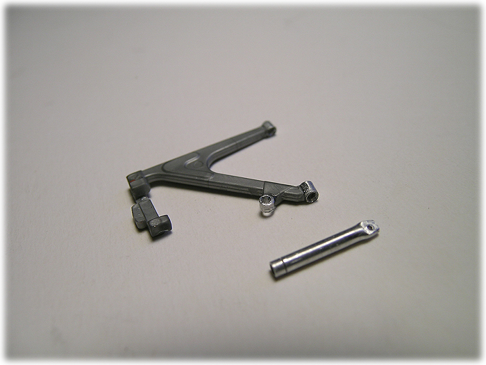

Axle shaft is being replaced with my left over parts...
Drive shaft being installed here.
I would like to give an excessive "dirty" feel to this engine here. Most of the
engine won't show when the kit is complete, I would like to highlight the engine details by giving a heavy wash. It will be a big contrast when everything is assembled.
Like this... Dirty and oily. After everything is complete, I will give a nice "thinner" wipe to the surface to remove excessive wash.

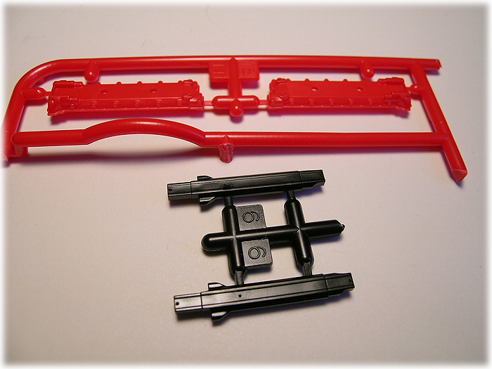

Getting into the valve cover assembly now...

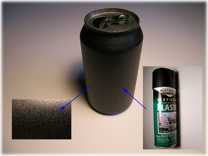

I wanted to give some rough texture, so I took an easy route. This is the texture paint for plastic, I think it works okay for what I want to achieve.

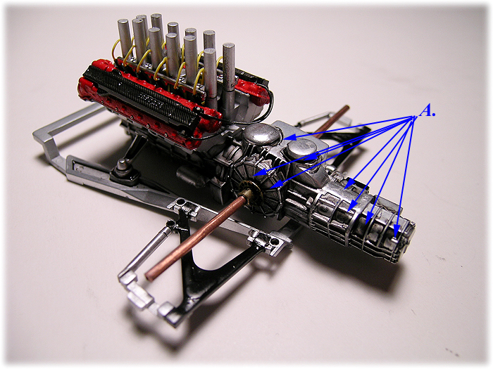

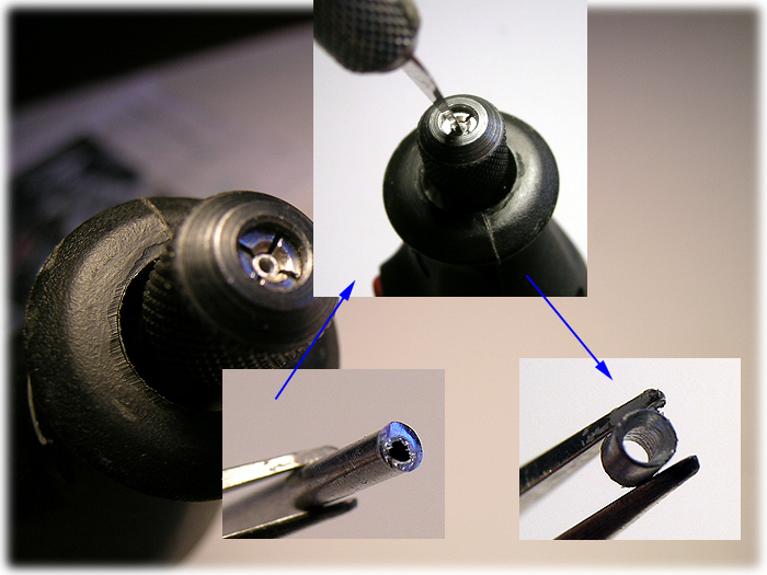

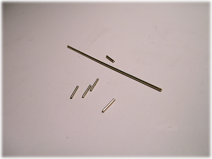

Rivat is going into (A), I had to modify my drill (B) to hold the drill bit because it was quite small...
I am satisfied with the texture of the valve cover now.
The rivets are being installed here. Each of the rivet costs roughly USD $0.90 x 10 = USD $9.00 x 2 valve cover = USD $18.00 for just rivets... I must be losing my mind.
They are extremely small, but they do add details to this.

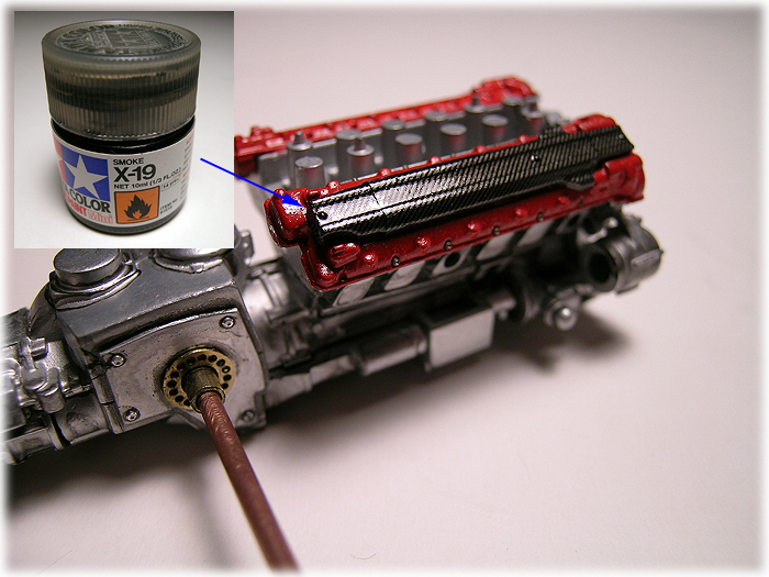

Now starting the carbon fiber decal work, the electric coil cover on the valve cover gets a carbon fiber dress here.

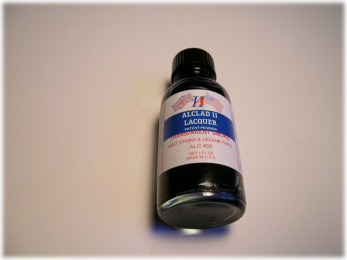

Adding a smoke coat, the carbon fiber gets some depth and the coat protects the decal from chipping off...

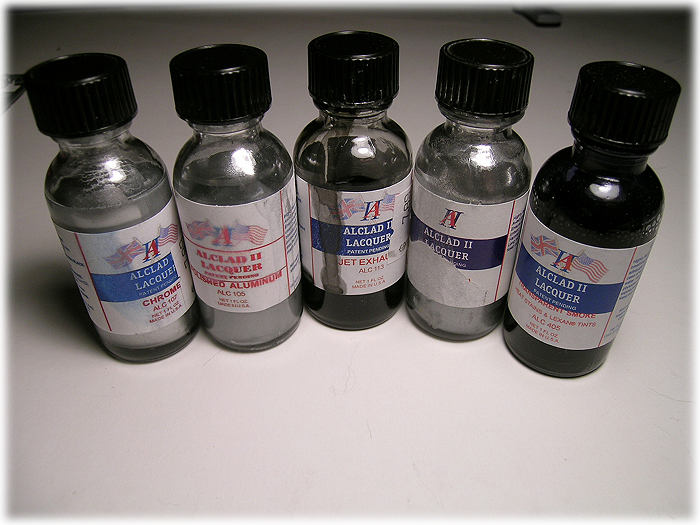

I bought this Alclad thinking it might help me detailing the exhaust better, but I haven't seen the actual color yet. I will find out soon...

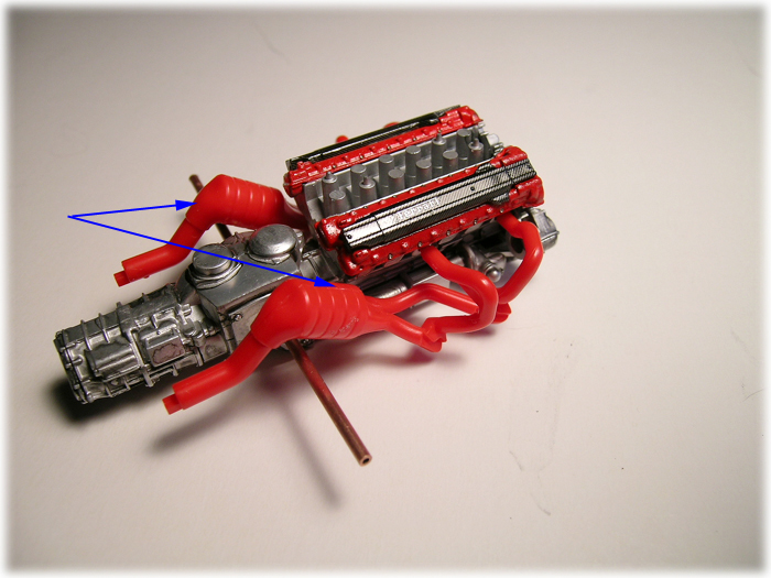

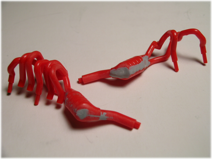

Exhaust parts...
I decided to remove everything and do my own. I used CSC also known as "Castrol Super Clean". The magic purple liquid does a job well.
These (blue arrows) seams will need to be filled.
I used Gunzo's surfacer 500 to do this kind of job...

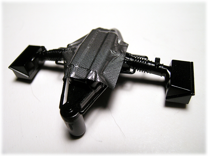

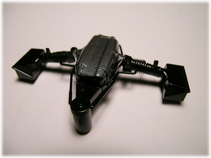

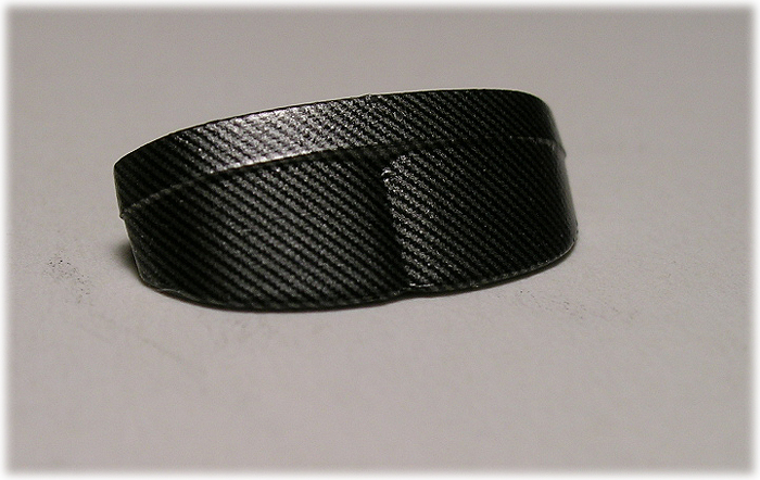

I got bored working on the exhaust area, so I moved on to another "boring" part... Getting carbon fiber decals on the dashboard... Again, I am covering everything here because I want this to be very shiny shiny carbon fiber dashboard.

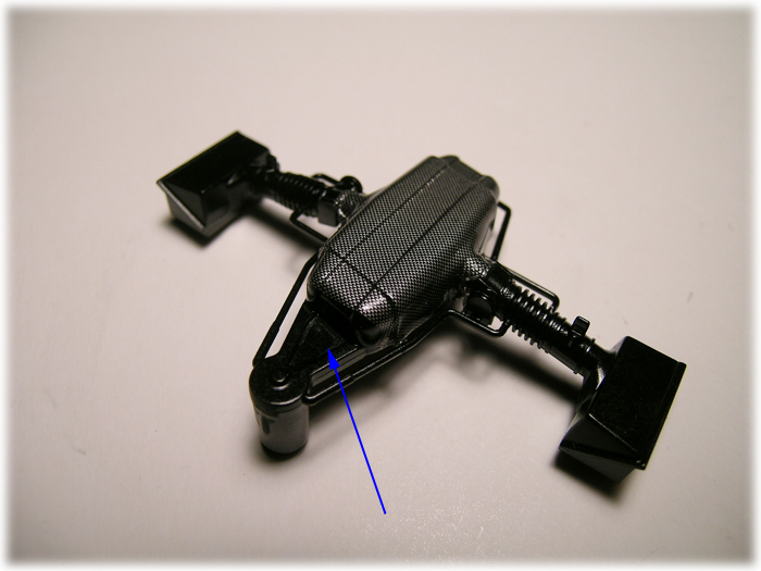

When working with carbon fiber, I noticed that I have to repeat the task multiple times because I fail to successfully lay down the decal. Sometimes, I just patch up the bad areas locally as shown with the blue arrows.
Trying again... I think I perform the repair for my mistakes more often than the work itself.
Some fellow modelers use hair dry-er to cure the carbon fiber decals, but I like to use 60w light bulb to cure and help adhering better to curves. Adding Sakatsu rivets...

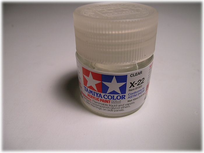

Smaller etching parts, I just use this acrylic clear as a glue. It does hold small parts okay and it won't make mess on surfaces.

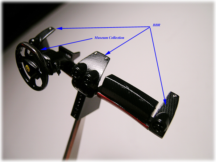

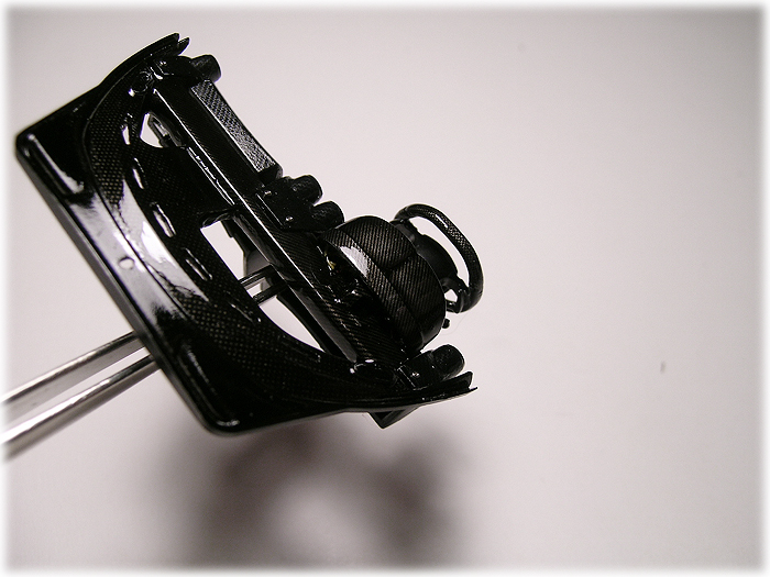

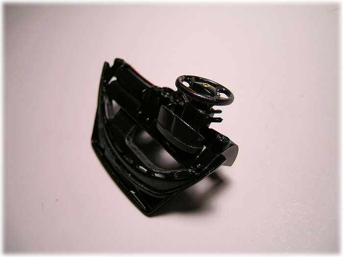

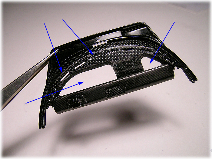

The dashboard...
I used different carbon fiber decals to make things interesting. I personally
like BBR's decal because they have the pronounced textures.
I am really bad at this... More mistakes to repair and more mess I made. I just sand them out and reapply till I am happy with the result.
I think it is about 50% complete. I also opened the dashboard covers.

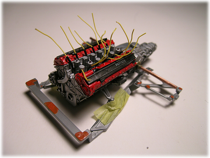

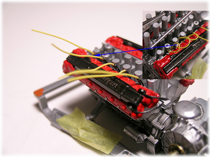

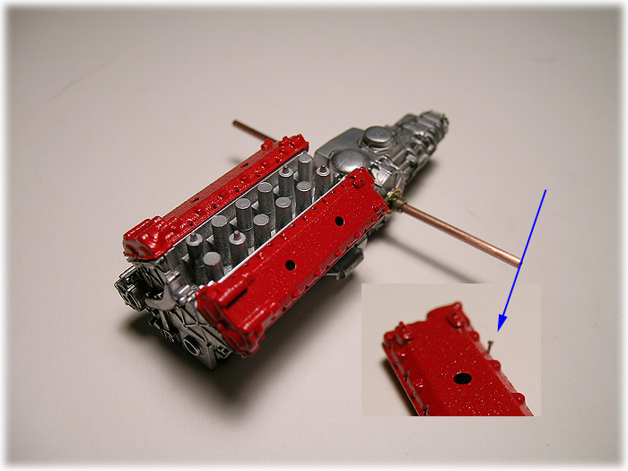

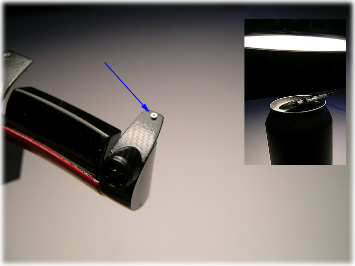

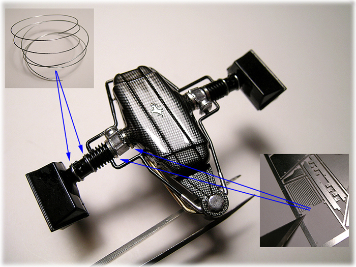

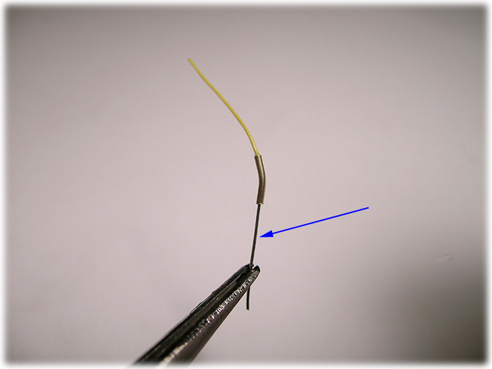

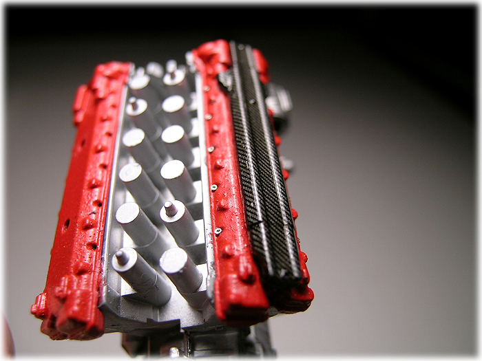

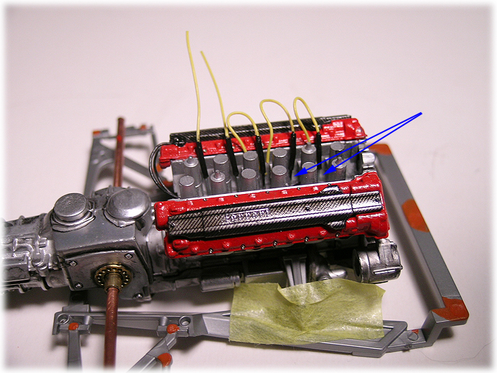

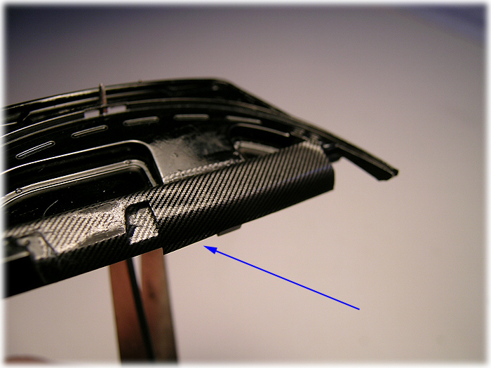

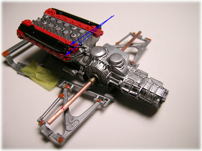

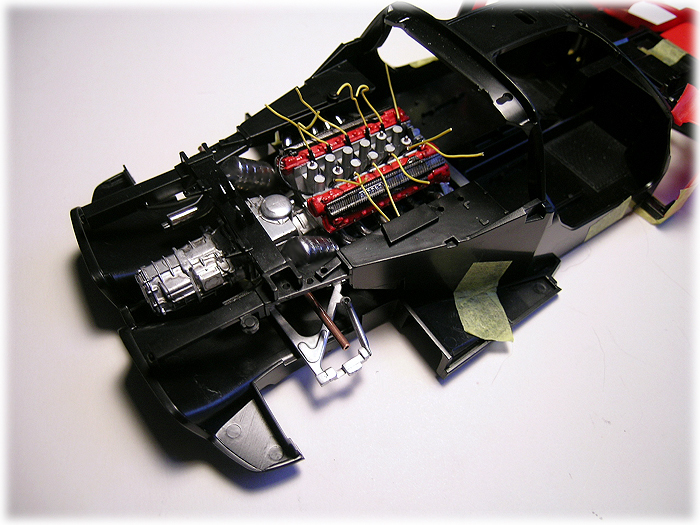

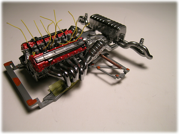

Continuing the electric wiring for fule injection, I added a thin wire as the blue arrow is shown here. This will be used to mount this unit onto the engine later.
I added knock sensors, I am hoping they are knock sensors. No?
I made a "distributor" like element, it looks very bad so I decided not to use this one...

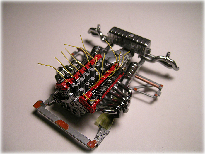

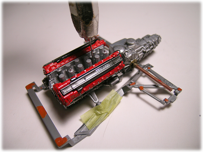

Drill 12 holes onto the top of the engine area and...

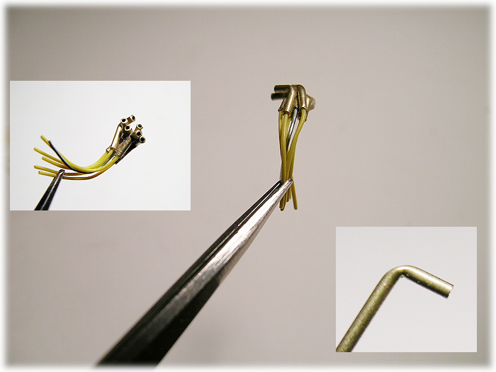

Inserting the electric wirings just like this...
Hopefully, I can arrange the wiring uniformly and neatly (sub picture), everything will look organized at the end.

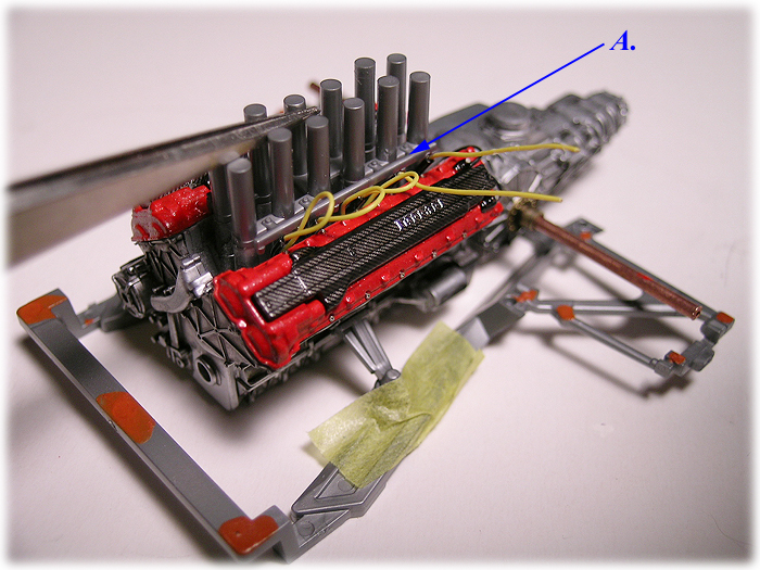

This is the fuel rail(A), I do have photo etching part for this, but decided to go with what Tamiya has provided.
I suppose if I don't like it, I can always replace this later on; I don't let this confus my mind for now.
All 12 of them are ready to go here.

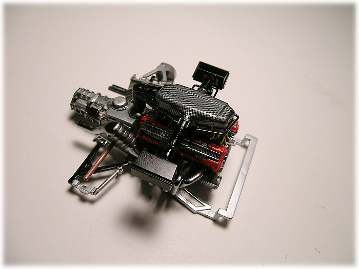

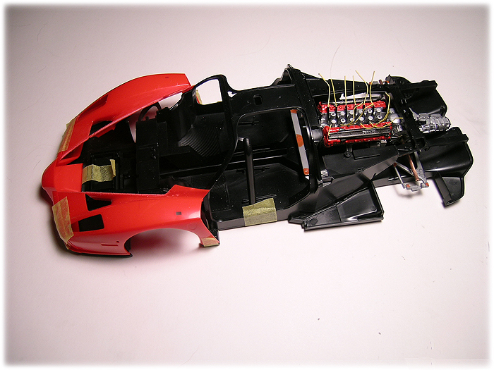

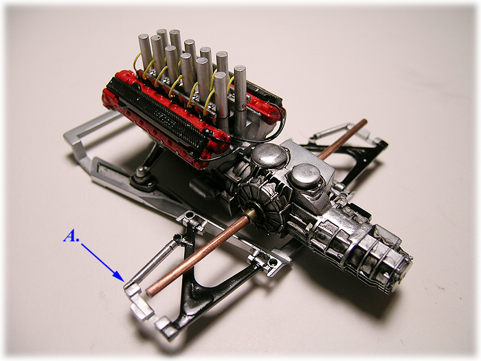

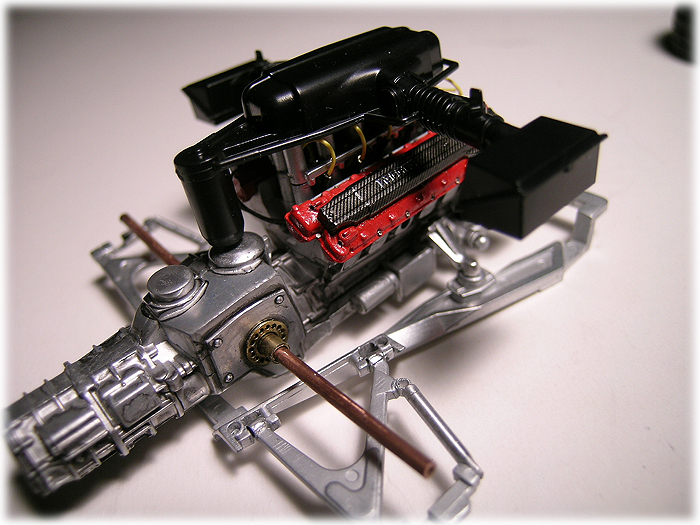

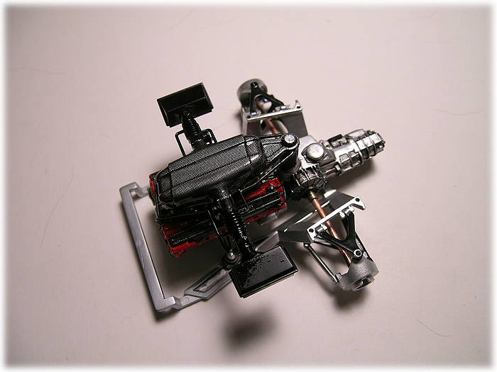

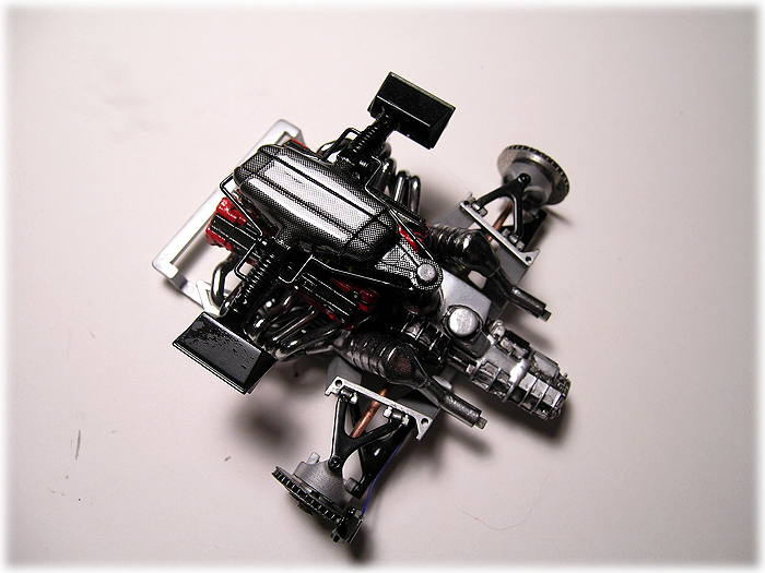

Some testing fitting. I get bore easily working on same part for a long time,
I performed some dry-fitting test to see what I have accomplished so far. I can see that I haven't done much yet...

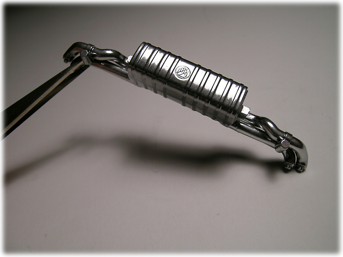

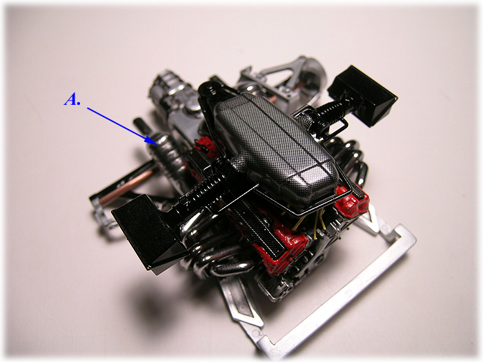

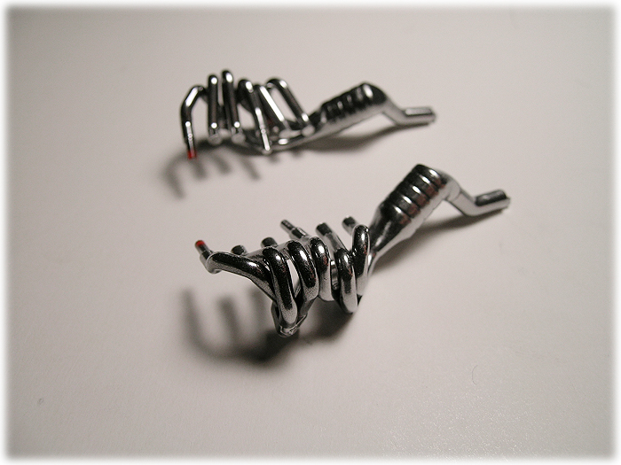

Moving onto the exhaust parts again. I do jump around from one to another, please forgive me for making this diary very direction-less...
Alclad Chrome does its job quite decent. Somewhat rough on the surface, but I think it works out because they are exhaust pipes which doesn't have to be pretty.

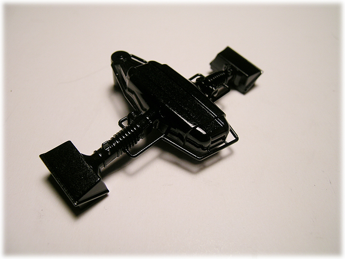

The muffler unit was also dressed up with a light coat of Alclad Chrome after gloss black enamel paint.
The picture came out actually darker because these are bit too bright for my camera to capture...

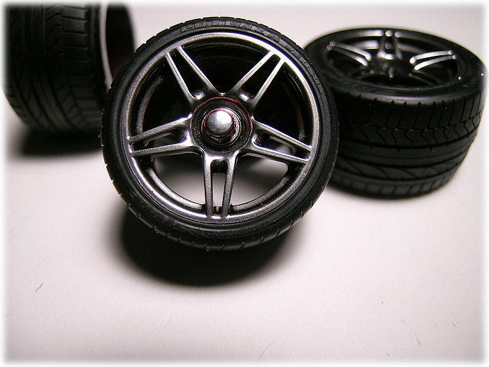

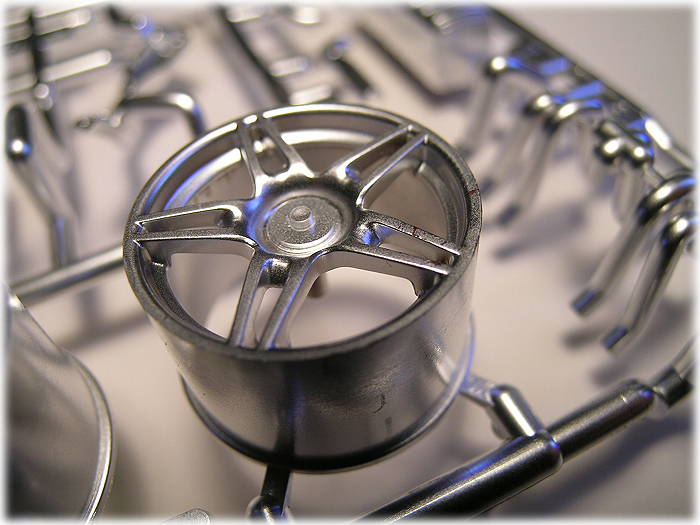

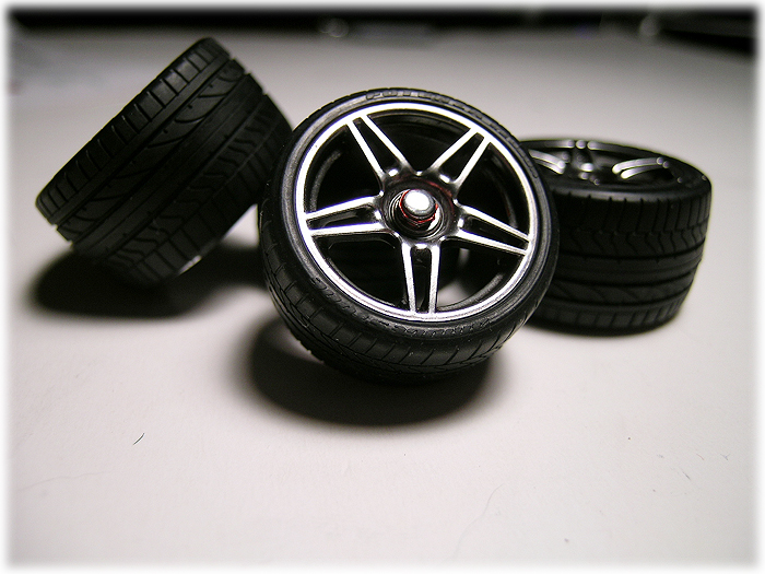

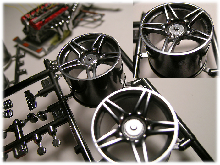

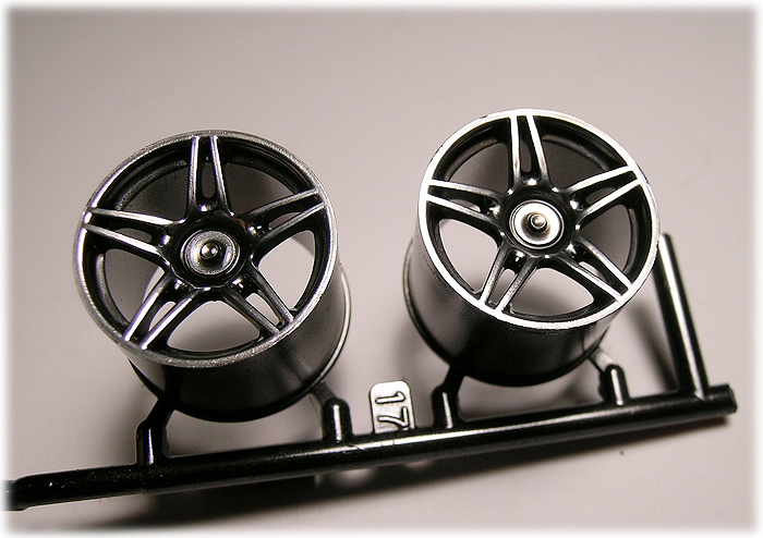

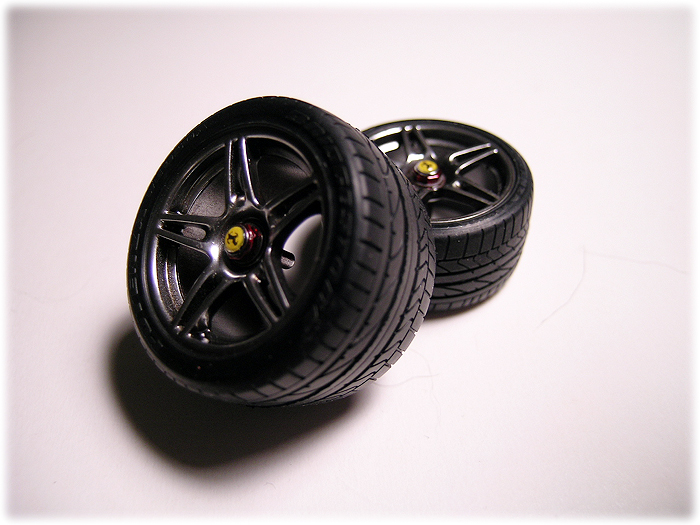

I also gave a light coat of Alclad polished alumimium for the wheels, I would like these wheels to be very dark to give an aggressive look overall. Not a good idea?...
