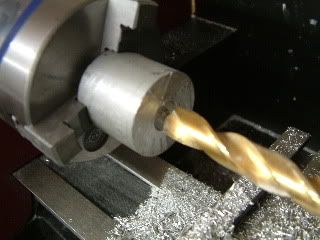

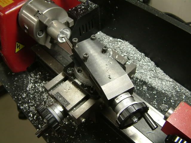

First up I had to use the lathe :licka: 1/12 scale wheels look just awesome machined out of metal so I got to work.

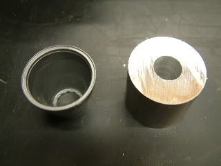

I selected a suitable size aluminium rod for the rear wheels. This was then drilled out to match the inside diameter of the back of the wheels (smallest hole)
http://i20.photobucket.com/albums/b246/robrex/Ferrari%20312%20T/DSCF0609.jpg http://i20.photobucket.com/albums/b246/robrex/Ferrari%20312%20T/DSCF0599.jpg
I then used my Top Slide / Taper turn attachment and measured the angle required for the wheels. Slowly but surely I started machining the inside angle. The Top Slide is a must have if you want to make similar items.

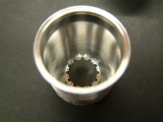

http://i20.photobucket.com/albums/b246/robrex/Ferrari%20312%20T/DSCF0608.jpg

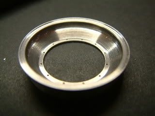

I then used my mill to add the details to the back of the wheels and completed the same process for the fronts.
http://i20.photobucket.com/albums/b246/robrex/Ferrari%20312%20T/DSCF0610.jpghttp://i20.photobucket.com/albums/b246/robrex/Ferrari%20312%20T/DSCF0602.jpg

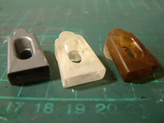

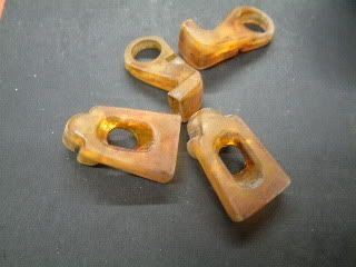

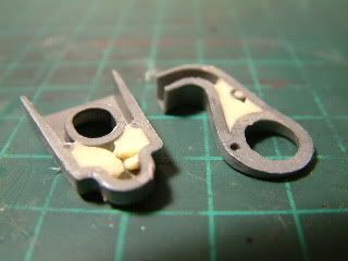

One of the things I don't like about the kit is the brake ducts. They are fiberglass on the real car and only plain plastic in the kit. That had to change.
I decided to make clear resin copies.
To start I cleaned up the original Tamiya parts and filled the ducts with plasticine towards the back to prevent having too complex a shape to cast. Then I secured all the parts flat on the table and formed the edge of the mold around them. This left me with a very thin and flexible rubber template.
http://i20.photobucket.com/albums/b246/robrex/Ferrari%20312%20T/DSCF0605.jpghttp://i20.photobucket.com/albums/b246/robrex/Ferrari%20312%20T/DSCF0606.jpg

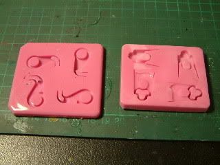

Next, I found some clear resin and cast the pieces. These were glued together exactly the same as the originals and then coated with thinned Citadel Flesh wash ink. Once dry I sanded the parts with coarse sandpaper to get the right finish. I reckon they look 100% better!
http://i20.photobucket.com/albums/b246/robrex/Ferrari%20312%20T/DSCF0601.jpghttp://i20.photobucket.com/albums/b246/robrex/Ferrari%20312%20T/DSCF0612.jpg

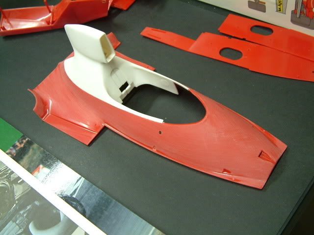

I also started working on the body parts
http://i20.photobucket.com/albums/b246/robrex/Ferrari%20312%20T/DSCF0598.jpg

Next, I turned my attention back to the motor and started on the fuel injection set up.
I'm using turned metal intakes so I drilled the plate to allow the trumpets to fit. Once the holes were drilled I mounted the injectors and then cut the excess which protrudes into the hole where the new intakes will go. I used a round file so when completed the parts will still be flush with the intake trumpets. I also replaced all the kit molded nuts with aftermarket items
http://i20.photobucket.com/albums/b246/robrex/Ferrari%20312%20T/DSCF0653.jpghttp://i20.photobucket.com/albums/b246/robrex/Ferrari%20312%20T/DSCF0652.jpg
Next I fit it all together and installed the protective mesh. I still need to detail paint the mesh but am very happy with the end results.
http://i20.photobucket.com/albums/b246/robrex/Ferrari%20312%20T/DSCF0654.jpghttp://i20.photobucket.com/albums/b246/robrex/Ferrari%20312%20T/DSCF0655.jpg
More soon!
