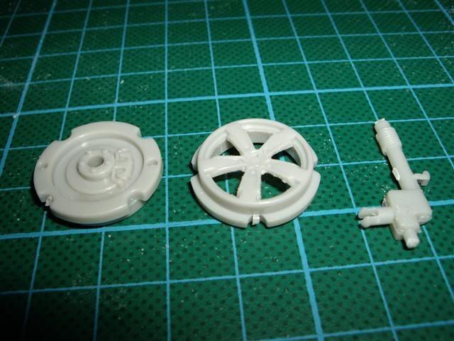

Been at this one on and off for a couple of months, but progress has been slow and I didn't think I had much to show for it. The kit is a snap-together, so is pretty basic, but it's nice and simple to work with! Much scope for improvement. The wheels, for example:
http://i153.photobucket.com/albums/s204/evilbob2001/Monaro/Wheels1Small.jpg
I like the rims - you often see them on Monaros in the street. But that's the brake disc and caliper attached to the back of the wheel. Two parts, with a hole for the axle. I removed the rim part of the wheel back and made a single rim, then sanded down the centre until I had just the disc...

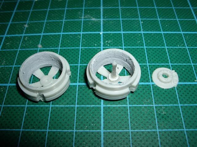

http://i153.photobucket.com/albums/s204/evilbob2001/Monaro/Wheels4Small.jpg
Finally:
http://i153.photobucket.com/albums/s204/evilbob2001/Monaro/Wheels5Small.jpg
The stub axle is a piece of styrene rod glued into a slight hole drilled in the hub of the wheel, with a piece of styrene tube for reinforcement. Seems to be holding! I cut off the snap fitting on the front strut and drilled it out to take the axle.

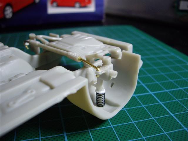

While working on the front suspension, I realised that the kit is designed so the wheels are not steerable. With a little work, I managed to rectify that.
http://i153.photobucket.com/albums/s204/evilbob2001/Monaro/SuspensionSmall.jpg
The tie rod was molded to the sump guard/ suspension arm piece. I cut it off and made ends from brass rod, epoxied into holes drilled in the tie rod. The parts that the tie rod ends go through were molded as part of the tie rod, so I removed them, attached them to the struts and drilled them out. It seems to work, and still leaves clearance for the engine and exhausts.

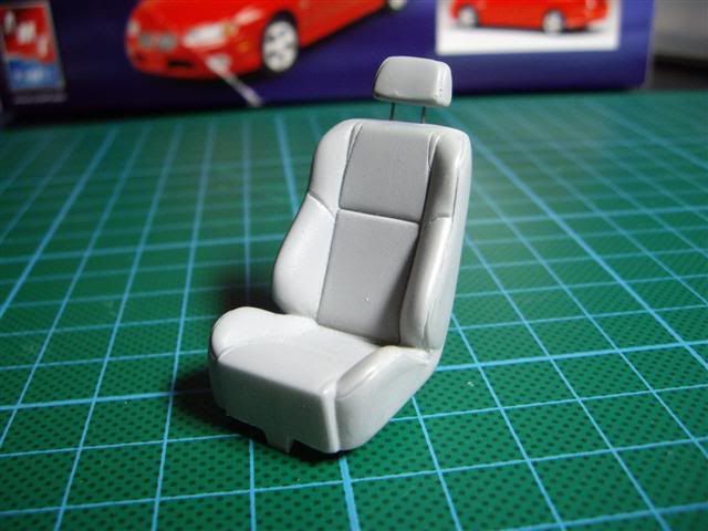

Some small progress. Working on various parts at the moment. Improved the seats, from this:
http://i153.photobucket.com/albums/s204/evilbob2001/Monaro/Seat1Small.jpg
To this:
http://i153.photobucket.com/albums/s204/evilbob2001/Monaro/Seat3Small.jpg

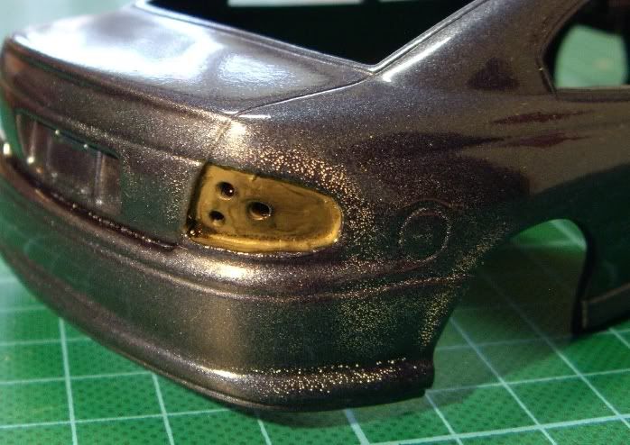

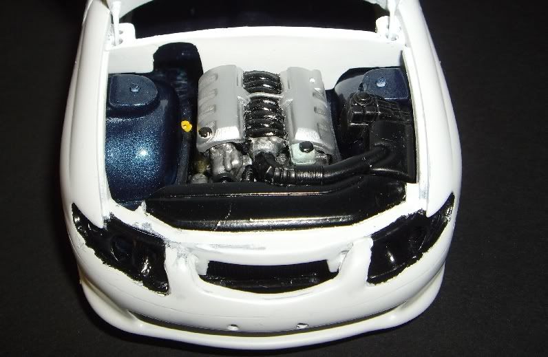

Needed to move the petrol filler cap, and work on the front of the car - that's going to be the biggest issue for me I think, as it's a fairly major change - a lot of putty! Here's a mockup:
http://i153.photobucket.com/albums/s204/evilbob2001/Monaro/MockupSmall.jpg

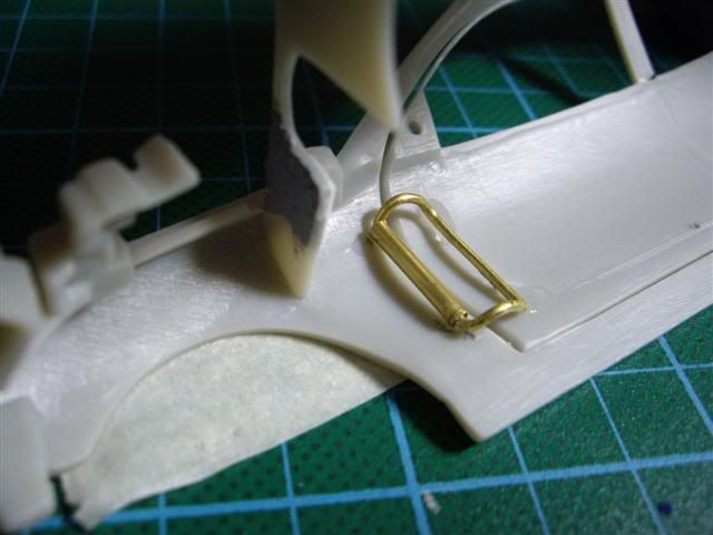

And I've opened the driver's-side door and made a working hinge (much to my surprise!)... Here you can also see where I've reversed the firewall for RHS.
http://i153.photobucket.com/albums/s204/evilbob2001/Monaro/HingeSmall.jpg

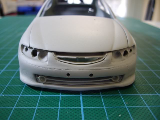

And here's what's really been taking the time. Still a lot of work to be done here, but I think it's looking fairly Monaro-ish. At least now it's primed, I can see what still needs to be done.

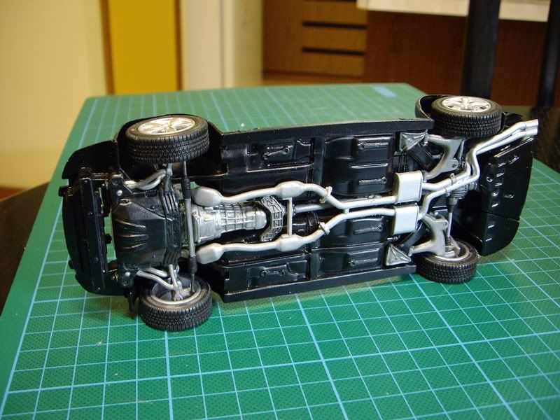

Ok, starting to see it coming together here. Chassis is finished:
http://i153.photobucket.com/albums/s204/evilbob2001/Monaro/Chassis.jpg

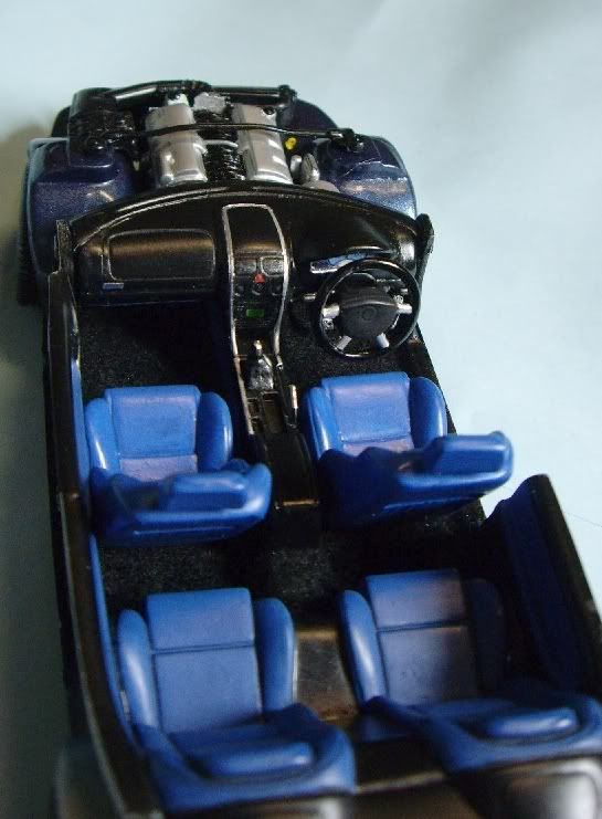

After a busy week, the interior is pretty much done. I just need to weather the front seats a bit, and later I'll add a couple of details.
http://i153.photobucket.com/albums/s204/evilbob2001/Monaro/Interiordrivercomplete.jpg
My first attempt at flocking - I found it a bit easier than I expected. Came out not too bad...
http://i153.photobucket.com/albums/s204/evilbob2001/Monaro/interiorcomplete.jpg

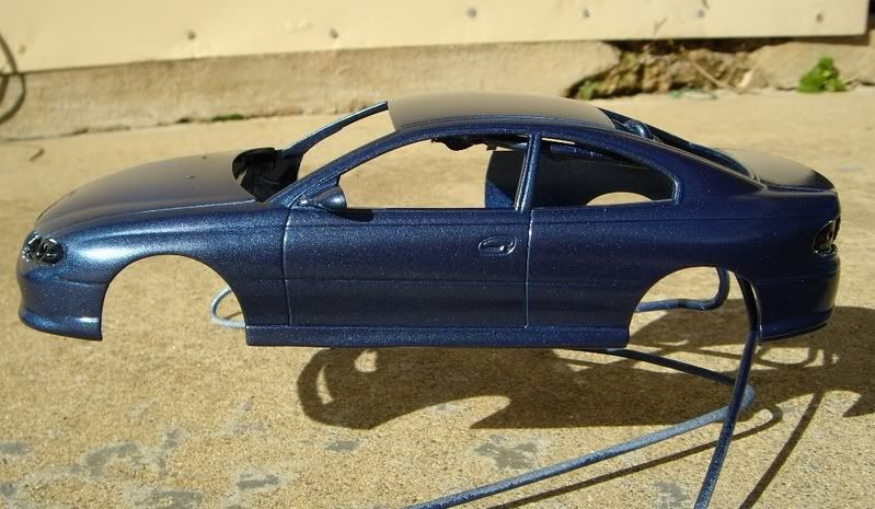

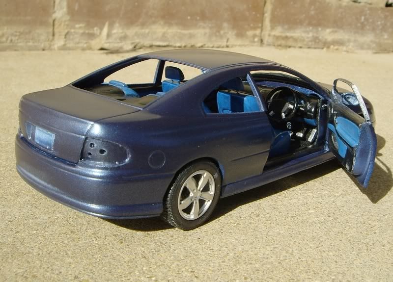

Couldn't help myself - put the body on the chassis and took some daylight shots...
http://i153.photobucket.com/albums/s204/evilbob2001/Monaro/Paint5.jpg
http://i153.photobucket.com/albums/s204/evilbob2001/Monaro/Paint6.jpg

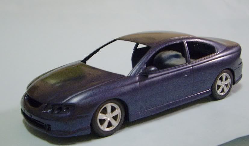

Finally some more movement on the Monaro. Not much, but I'm back in the mood! I've lowered the ride height, so it looks a bit more realistic. You can just about tell from my crappy picture. Working on the badging at the moment.
http://i153.photobucket.com/albums/s204/evilbob2001/Monaro/Lowered.jpg

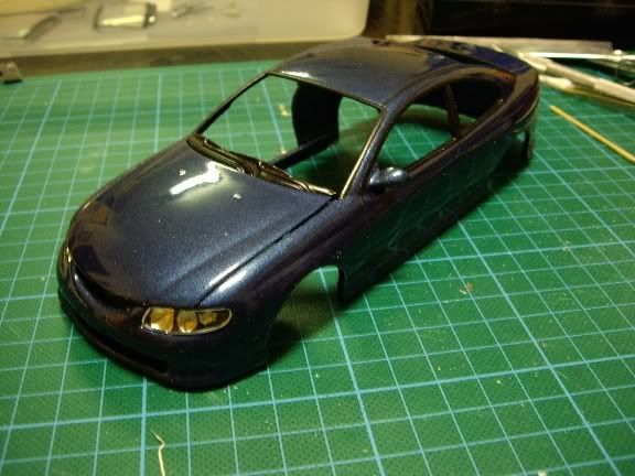

Can anyone spot my deliberate mistake?
http://i153.photobucket.com/albums/s204/evilbob2001/Monaro/paintbubbles.jpg
That's mostly polish in paint bubbles, but since it's metallic paint, I can't sand it. Looks like an evening of polishing in front of me. There's only a few spots like this though - the rest of it's looking pretty good.
I'm planning to try and fashion the metal badging by putting down a strip of BMF and making a decal that hopefully matches the body colour to put over it, leaving the badge part clear. I don't know if this'll work effectively, but I don't know any other way to try. The other option I suppose is to PE the parts, but that's a bit above me! If anyone has any tips, I'd be glad to hear them.
Other than that, I just have the clearcoat to do, then the lights and the window trim. Hopefully.

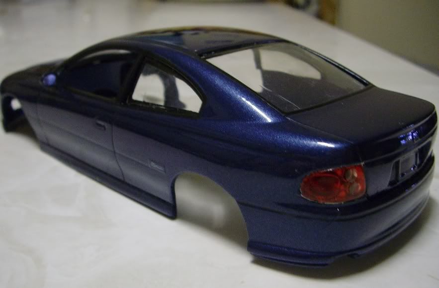

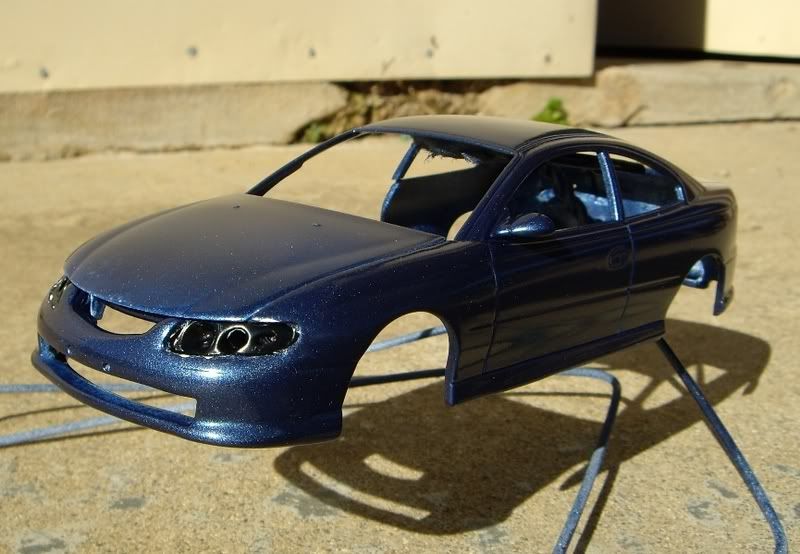

Small update:
The body is painted, clearcoated and polished, and I'm finishing off some details. I've also done the window surrounds and the rain channels in the roof with semi-gloss black.
http://i153.photobucket.com/albums/s204/evilbob2001/Monaro/Body.jpg
The headlights are just BMF pressed into the headlight sockets:
http://i153.photobucket.com/albums/s204/evilbob2001/Monaro/Headlight.jpg
I masked the glass and sprayed the inside, then separated the various panels - they didn't really fit as a single piece:
http://i153.photobucket.com/albums/s204/evilbob2001/Monaro/Glass1.jpg
http://i153.photobucket.com/albums/s204/evilbob2001/Monaro/Glass2.jpg

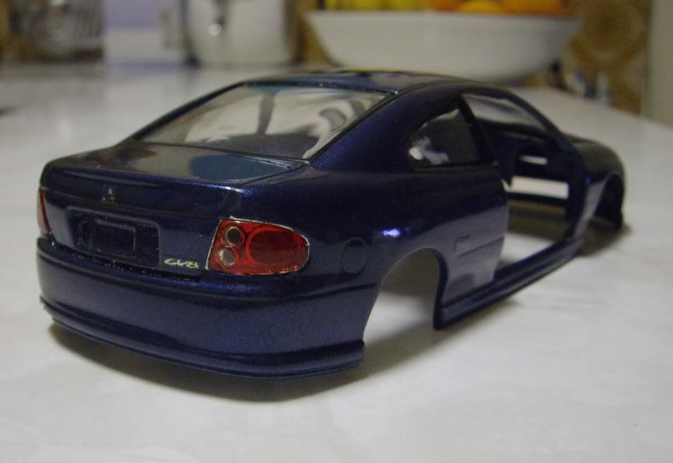

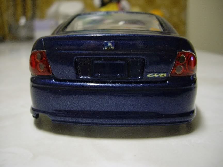

I keep hoping that my next post will be to say it's finished! But sadly, it's not. Yet. A little more movement - the taillights fitted with covers painted, and the glass in. Some tidying up needed around the light covers, but I'm pretty please with how they turned out.
One thing I learned here - if you've got to take a drill to your kit, do it BEFORE you paint it.... I had to repair a couple of dings in the duco!
Next post, hopefully, will be the final one!
